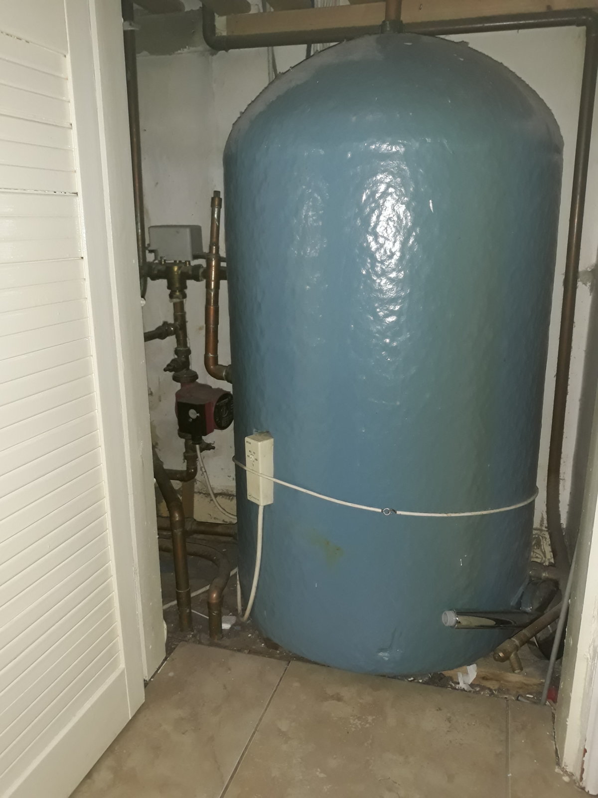

Hi all, thank you so much for all your posts.. Update, still not resolved. I spoke with the estate agent's electrician about the pump - if a seal had gone causing water to leak onto the electrics. He said he didn't think it was the pump because we have hot water.. the motorised diverter was the value header I was trying to explain and that has been changed. The electrician said something about mains electric "coming back in" when he disconnected the power completely (not sure what he means by that) and since everything possible has been replaced, thoroughly checked and tested and since we have hot water (heated by the gas boiler and stored in the water tank) no one knows where the amp leakage is - The NIC board were stumped too and that's why the electrician asked if the power company had completed any works recently as it maybe tripping outside. The local distributor (Western Power) came round this evening and could only perform "simple tests/checks" and according to them, everything is fine with their end. So we seem to be back at square one. For the record we have a Potterton boiler - which I know has a bad rep. We are still in the "it's the boiler - no it's the electrics" phase and think trades are confused as we are getting hot water from the boiler no problems at all, it's purely when the central heating kicks in. Also to note, I was told that even though the CH is disconnected from the RCD the pipes won't get electrified as the fuse would blow first - ?. It's frustrating as I have to go through the monkey to speak with the organ grinder, have no idea what people are on about as I'm just "jo blogs" (lol) and things get a bit "chinese whispers". So if anyone does have any further suggestions I'd be very grateful and can pass them on. Thank you
This is the airing cupboard set up. The water tank thermostat 'whitebox' has been replaced. You can see the red pump just to the left and the value header (as I call it) a little above that. As mentioned the pump hasn't been checked because it 'kicks in' when we put the timer on Hot Water. The two way valve (I think) simple switches over to the hot water - everything's ok. But press the CH and when the valve switches to the CH : pop go the electrics
You have a fully pumped Y plan system and the value header is the three port valve actuator head. Is this what was replaced ?
Yes, that's the one - actuator head, that switches from the hot water or central heating or can "sit in the middle" to get both. Sorry, I've had so much 'jargon' chucked at me I'm really confused haha.. my own fault for trying to be a helpful tenant
