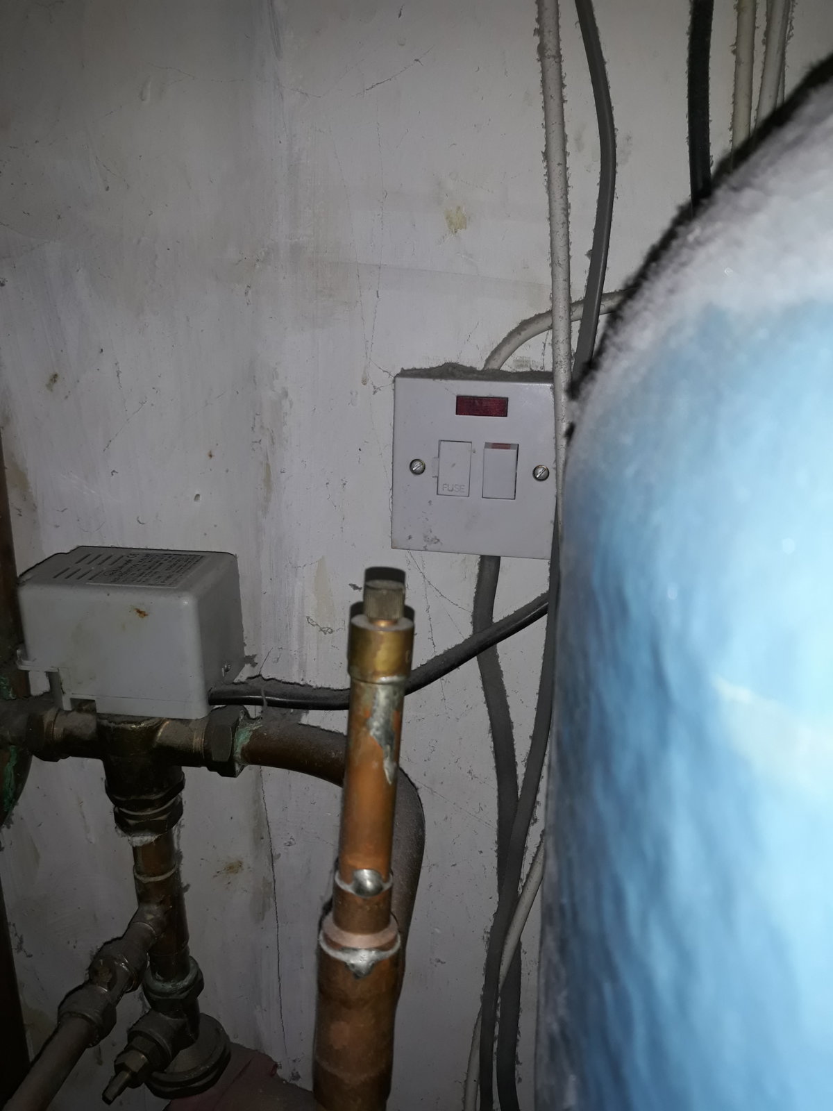

Don't suppose you have checked to see if the immersion heater has been left switched on ?
I was told to never turn this switch off - and to be honest I'm not 100% sure if this is the immersion, sorry - it's a good job I have a desk job ;)

Since the hot water is functioning correctly, in your type of system the pump and boiler can be eliminated. So suspect items are the room thermostat, the controller, one wire in the 3 port valve and the wiring between them. The wiring to the room thermostat is only energised when CH is selected on the programmer. One wire in the 3 port valve is only energised when CH is selected. The CH wire leading from the programmer to the 3 port valve is only energised when CH is selected. It is quite likely that the room thermostat and the programmer and the 3 port valve are earthed via the boiler (explaining the remove boiler earth everything works sketch). So the fault will be there somewhere. Since the fault is heat sensitive, it'll most likely be in the wiring at or near the 3 port valve (was the cable from the valve head to the wiring centre replaced when the head was changed? If not that would be my favourite- check carefully where the cable comes out of the metal case covering it). If that's OK then next likely location will be under the floorboards where a cable has been left too near a hot pipe. An electrician with appropriate test gear will be able to narrow the fault location down quite quickly.
That is the fused spur for your heating , dont turn it off, it is not an immersion heater
With DHW the boiler, and pump are running, with CH the boiler, pump and motorised valve is being powered, so it points to motorised valve or wiring to it. The valve is not powered for DHW.

This is an immersion heater (the round thing at the top of the cylinder but yours could be on top or on the side) see if its wired to a switch, if we can find out why you have hot water it will help to find the fault,
