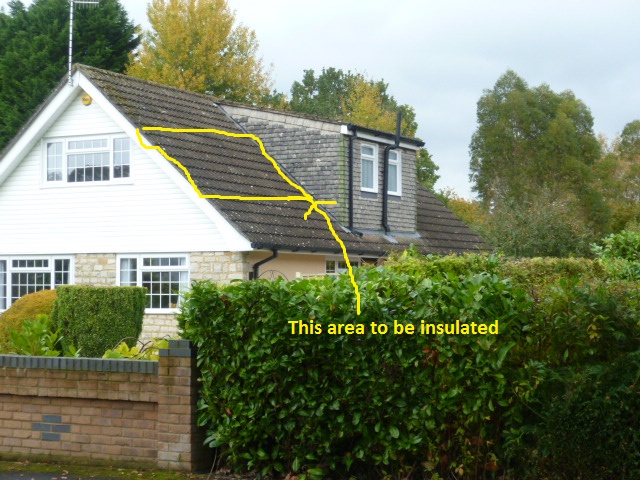

How can the sloping roof of a chalet bungalow roof be insulated?
At present the flat ceiling and the upright walls are insulated with a mixture of 100mm mineral wool and celotex , the sloping part of the ceiling has none. What can be done, the rafters are 100mmx50mm and covered obviously in plasterboard and plaster.

I'd remove the plaster, put 50mm PIR between the rafters, leaving 50mm air gap under the felt/tiles. Then overboard with 50mm PIR bonded to plasterboard.
The other place you have to check is under the floor boards - sometimes there's no insulation on the between the joist ends meaning that the entire floor/ceiling cavity under the room is outside the thermal envelope of the house. You should be able to get in to the eave to establish the insulation detail at the joist ends.

I was about to post this same question myself. From the loft in our place I can actually see right down the void between the roof and the ceiling. Do you reckon there is anyway of getting something down these gaps without having to go in through the ceiling? The loft itself has plenty of ventilation, but I suppose there would still need to be some airflow in these voids...

Sounds a good idea, slide some 50mm celotex straight in. I can't do that so I guess the plasterboard is going to have to come off.

If it was plasterboard I might even think about it. Unfortunately it's lath & plaster.
