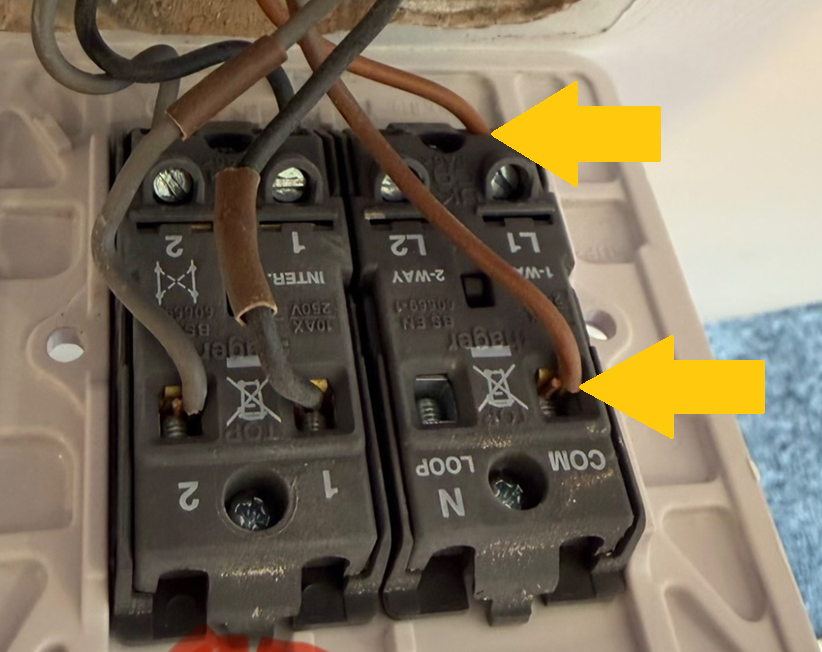

Hi.
I plan to change the 2 gang light switch near the front door to 1. This is to stop people pressing the wrong one, which switches off the outside doorway PIR light. I would like a permanent live feed to the outside light.
There is another 2 gang switch at the other end of the hallway which operates the same hallway light, and the upstairs landing light.
How would I do this, please?
Also, I would like to then loop the live from the outside light to a wifi CCTV camera and floodlight, ideally separate.
Sounds too simple in principle, so I would appreciate any advice, please and thank you.

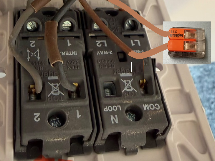

You wiil very likely have something resembling this:
the switch on the left being the 2 way, all of the wiring will need to be copied exactly into the new switch, any wires in the right hand switchwill be removed from the switch and linked together with a connector, something like this:
The actual number of wires and the colours may be different to those shown.
A picture showing what you have will make it far easier for us to give precise advice.
EDIT: I suddenly realise the image I've used shows an intermediate switch so the left switch will definitely be different.
