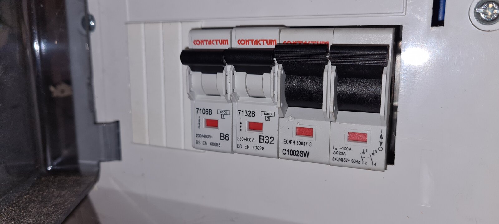

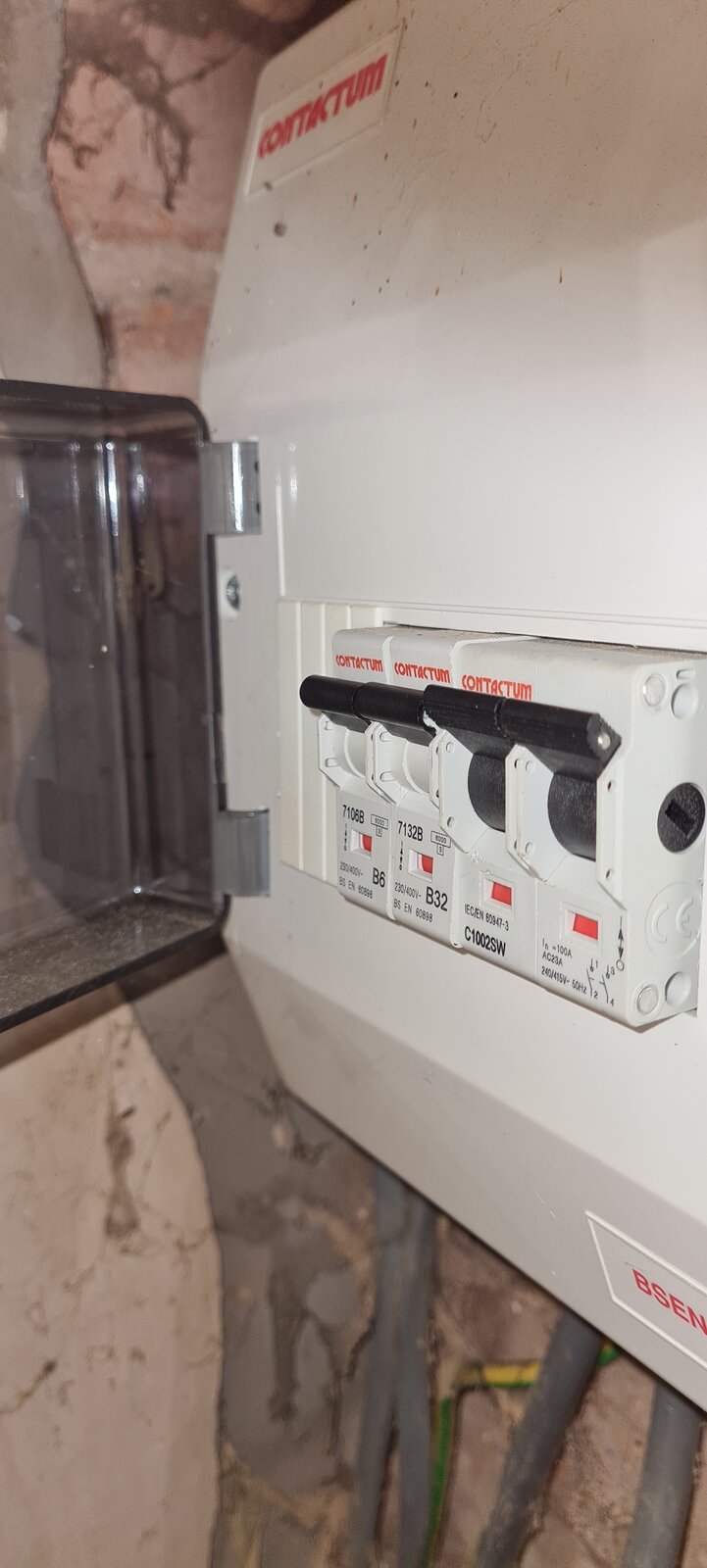

Show pics of your consumer unit / fuseboard. Do you only have one of the three breakers that isolates all your ceiling lights ?

Thanks for the reply. I recently bought smart sockets but couldn't use them because I have no neutral wires just black red and yellow\green. I have included a pic of the consumer unit

Surely that's not the only consumer unit in the property ,there are only two circuits ??
If it is the only consumer unit ,then all your ceiling lights would be on the one circuit ,far left (B6 marking)
Its the only one in the property. I do only live in a 2 up 2 down so I guess it's separated into upstairs and downstairs. Does this mean I'm good to go as long as I have an earth without blowing my house up?
Turn off the 6 amp breaker ,all your ceiling lights should then not work. That will confirm that you only have one lighting circuit. Turn off the main switch before working on the wiring / switch.
