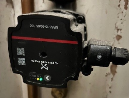

Gas or oil boiler/
Internal or external circ pump?
If external, post make/model/mode/setting or/and a post of any LEDs when running.
Thanks for the response!
Oil boiler, Worcester Bosch, 4 years old, regularly serviced. Last serviced end of January. Internal circulation pump located in the airing cupboard, also changed 4 years ago.
