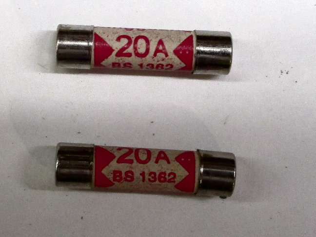

You are being stupid. Where can you get a 16 amp fuse to fit a UK plug?
I can't help you with a 16A one but, as discussed before, you could get a 20A one from me (or one or two others in this forum) :-) ...
