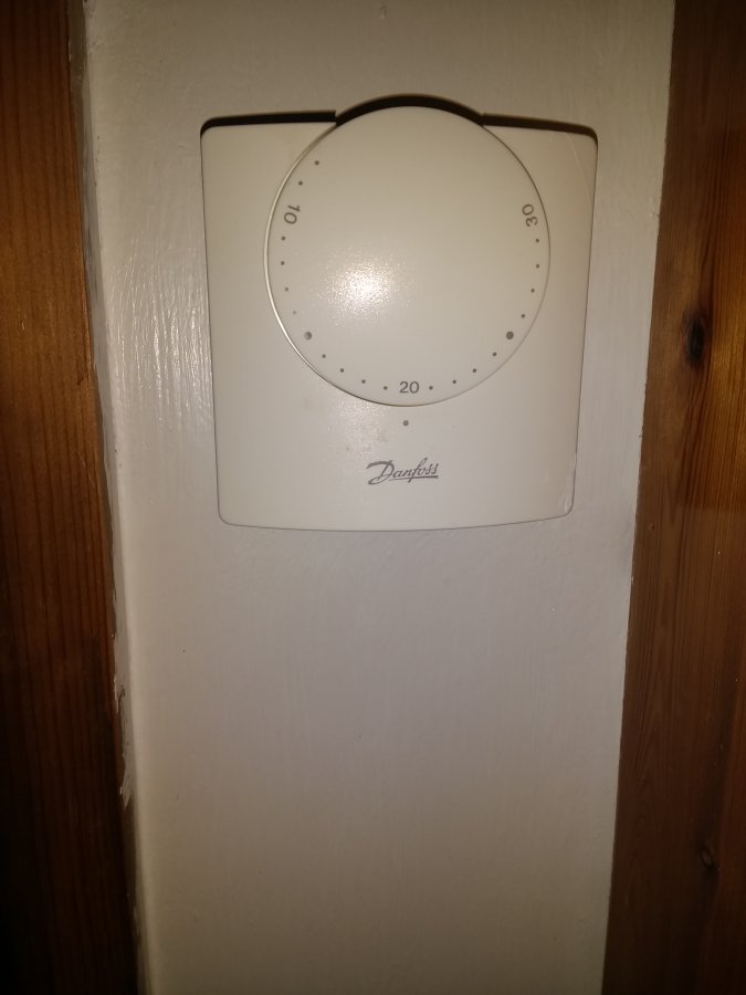

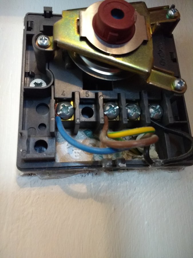

Hi,
Hoping someone can help, I would like to replace my old 3 wire dial room stat with a new 2 wire digital one, the problem I have is on my old stat the wiring is as follows,
the terminals from left to right are marked - 4, 5, 1, 3, 2 and wired 4 = Blue, 5 = empty, 1 = Brown, 3 = empty & 2 = black.
On the new stat I have terminals L & SL which I assume to mean 'live' and 'switched live' could anyone advise on which of my wires need to go where on the new stat or is it not possible.
Many Thanks.

Thanks for all replies, in answer to what make it is a Danfoss, no wiring diagram I'm afraid, I've attached pictures hope this helps.

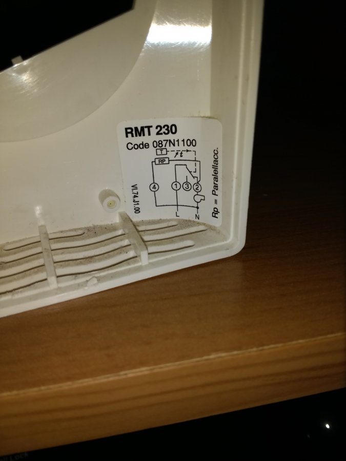

Sorry, I've found a diagram inside the cover of the Danfoss, please see picture.
As above. Brown=live, Black=switched live and blue is neutral - not used on your digital 'stat. Put the blue in an insulated terminal block as detailed in the WIKI
Hi,
Brown =L
Black =SL
Blue = not used make safe in connector block.
