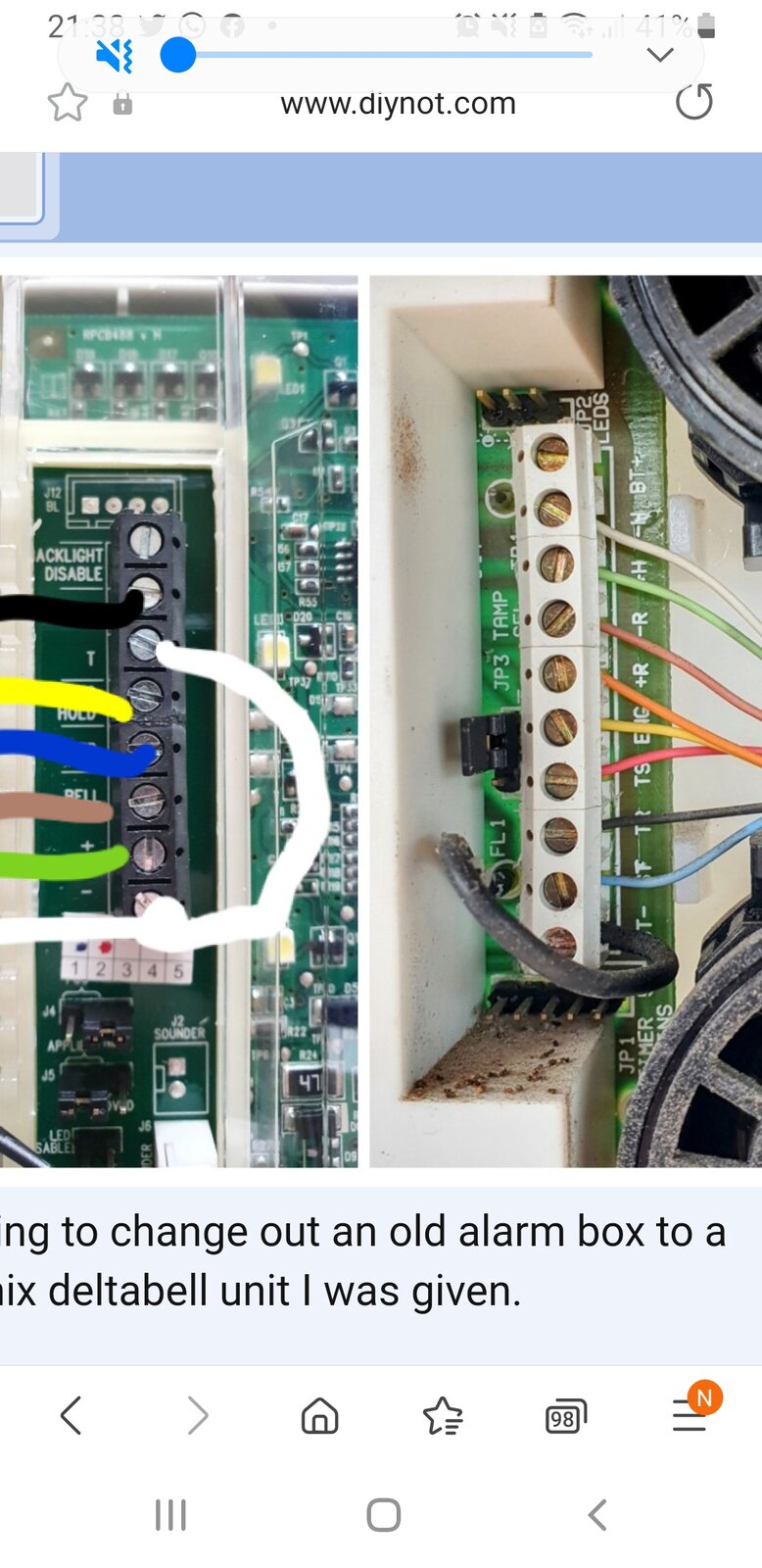

    Looking to change out an old alarm box to a pyronix deltabell unit I was given.
    Was hoping the wiring was similar, but no.
    Any help on how to wire this into the deltabox ?
    Many Thanks

    What control panel is the bell box connected to.
    Looks like all cores have been connected.
    New bell box
    12v + Green
    12v - White
    Bell Brown
    STB Blue
    T Black
    T wire link to 12v - White
    Can you post hoto of control panel wiring

    Not sure what the rest are for, as Manjo says will need to know what contol panel you are connecting to..... 20210913_215020.jpg

    Thanks for your replies. I will try and venture into the loft tonight and take some pics of the bits up there
