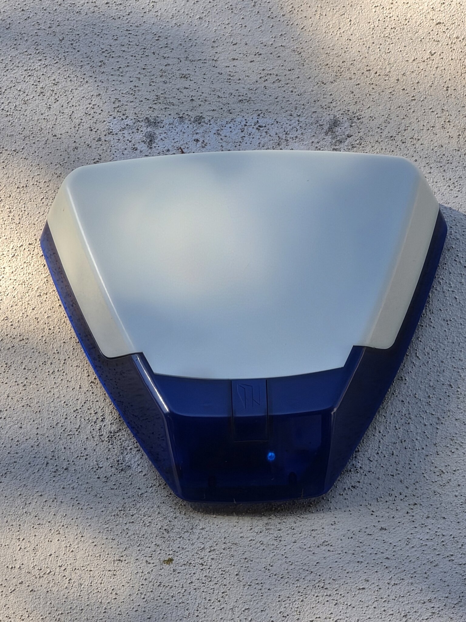

Evening all,
I have a Pyronix Deltabox on my Scantronic 9448+ Style home alarm system. The last few days it has started going off randomly so I have disconnected the control panel internal battery and the thing still keeps going off. Quick Google tells me it's the fault lies in the extreme heat we have been having causing the plastic bell box to flex and trip the tamper.
What's a good alternative to change the bell box too that isn't going to be a nightmare for me to change over wiring wise?
You know there should be a screw in the hole near the tamper switch you screw in until it hits the wall ….plus I’ve seen the locking screw for the module missing …. Hence asking for a picture … plus if it’s got a green tamper switch ….replace it …
