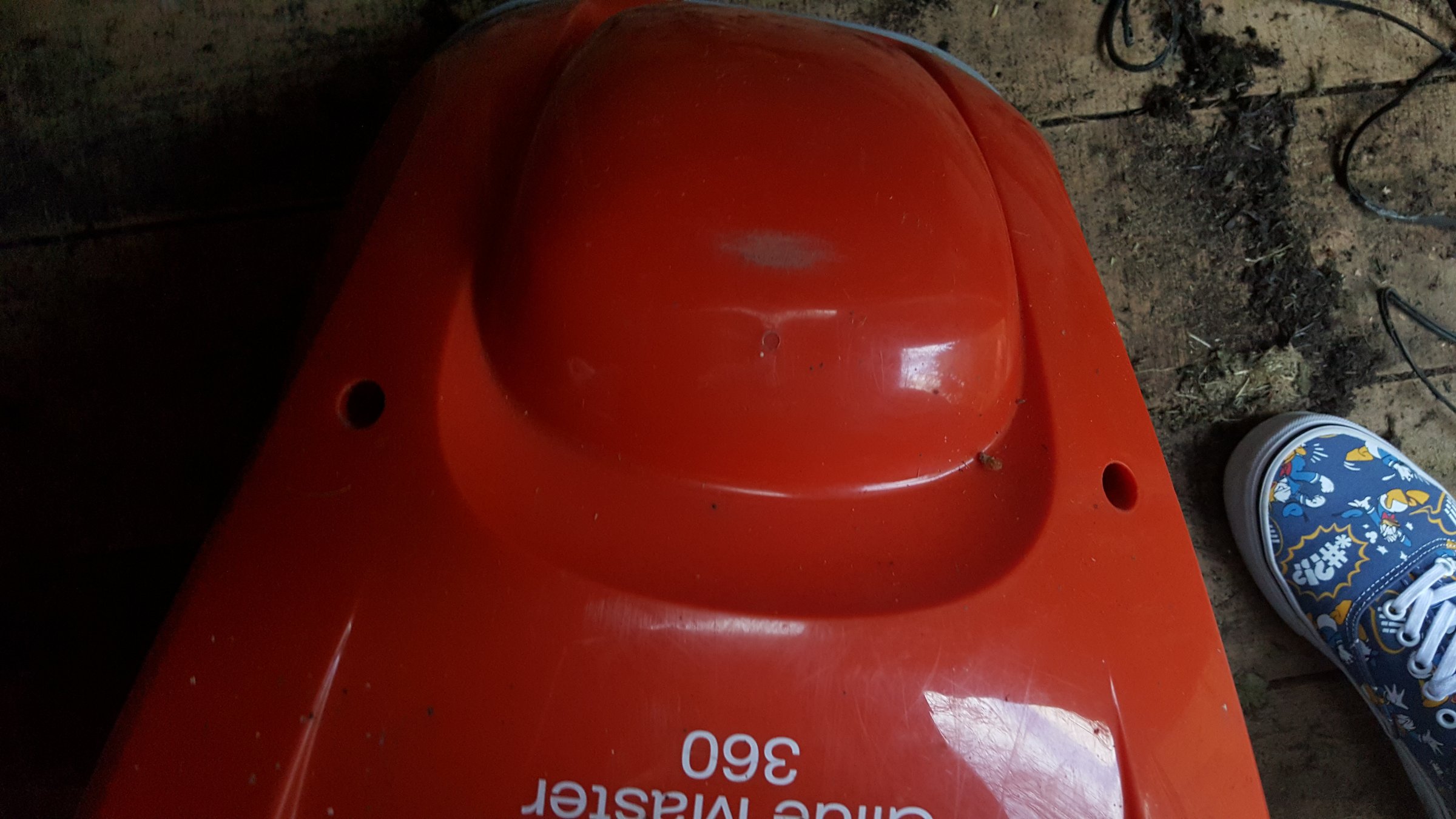

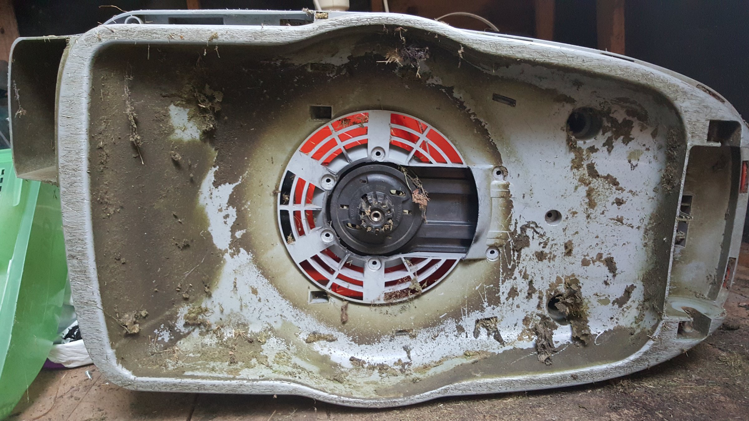

Hi people.
I have a Flymo Glide Master 360 and the belt has snapped so blade is obviously not spinning.
I have brought a new belt and started to access the motor but I got into trouble when trying to get to the actual motor, basically I can't. All the videos are for 3xx models.
I have to taken all the screws out but all videos shoe removing the front but I don't seem to be able too. The front seems to be completely attached to the top. Does anyone have any ideas to get to the motor?
I have attached a couple of pictures.

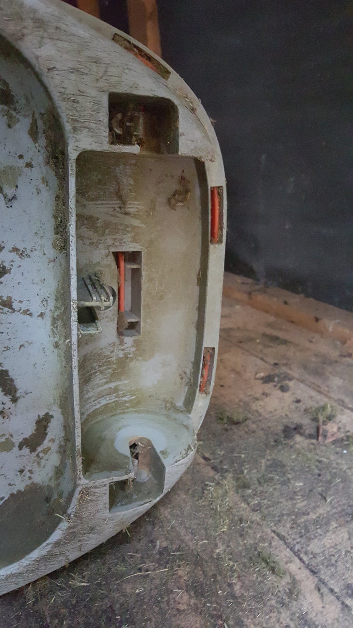

Looking from the underside, gently prise those orange tags you can see, and the motor cover should unclip from the hood...(I hope!)
The belt runs inside that black plastic cassette.
John :)
That's what I thought but was scared of snapping it and struggling to get them to unclip. Anyway you can recommend doing it as obviously need to try and get a number of them unclipped at the same time.
Cheers
I'd be trying to prise those lugs back with a couple of fine blade screwdrivers, a wee bit at a time and maybe with some WD40 or similar. With care they should give.
John :)
