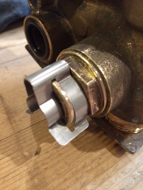

Hi, sorry to resurrect an old thread, but I have a related issue. I've got the pipe out, replaced the bits in the valve, but cant get the spring clip to hold the pipe in place. Any help would be most appreciated. Thank you
That's usually because it has not been fully pushed into the socket.
Tony
I'm sure its the right way round, but to be sure, I'm guessing the wider end goes on the diverter valve, sitting in the recess, with the smaller bit on the pipe. I'ts been driving me nuts. I thought I might have missed a washer or some thing.
see photo of the thing on the bench without pipe in place. Tell me this is the right way round. :)

It is! Sometimes people overlook stupid things! Make sure the seatings clean and apply loads of grease to the oring, Clips can feel loose sometimes but pose no problem when pressurised or does the clip not fit?
I got it on, with a push and using washing up liquid. It ran for 1/2 hour then blew off :(
Will try again tonight, I was sure it was on ok.
Which end of the clip failed. ?
Perhaps the clip needs to be closed a little?
I an guessing the pipe pulled through the small clip.
Tony
sorted :)
I didn't have the clip forward enough to grip on the shoulder of the small pipe.
