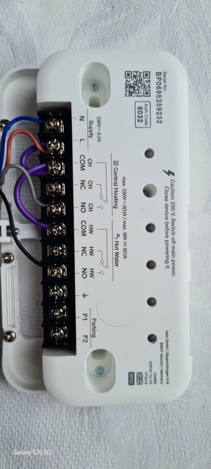

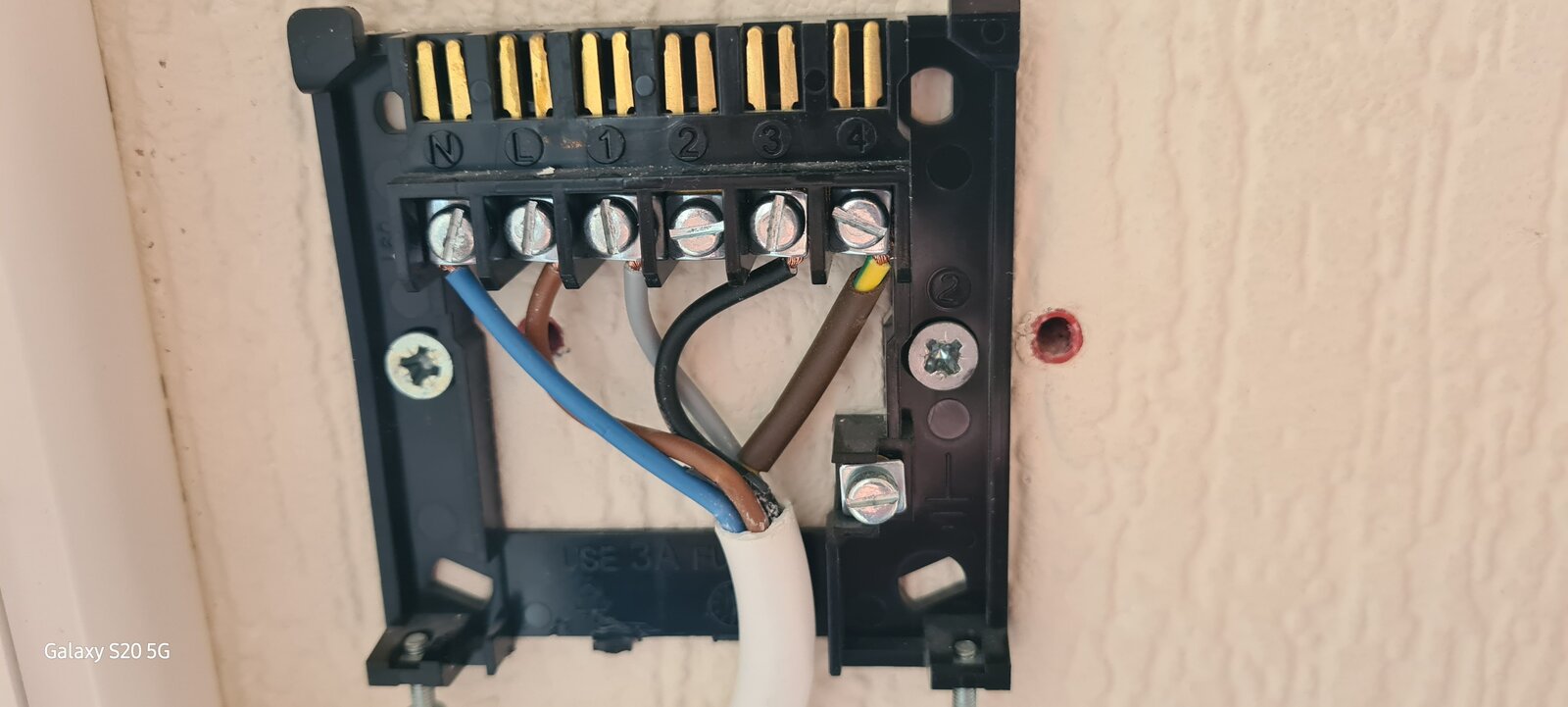

Hi, Changing my Drayton Lifestyle LP522 to a Tado, I am on a Y plan. On LP 522 backplate I have 5 wires,
N blue live Brown , 1 Grey, 3 Bk then on 4 an earth covered with a brown sleeve . I know this usually signifies permanent live so what do I do with it please, I was thinking it possibly goes to HW NO but don't want to risk blowing anything . I would really appreciate any help please.

Y Plan needs a N/C contact to turn DHW off when CH running. It is not permitted to over sleeve green/yellow, so it will need a new cable to do it correctly. If the N/C contact and wire not used, the DHW will reach the same heat as central heating, which was always the case with C Plan so not that much of a problem, but up to you.
According to the wiring diagram for the Drayton, terminal 4 is indeed CH ON or CH NO
Using a G/Y wire oversleeved for live is indeed against the rules in the UK and most of Europe, but it is done all too frequently.
The colour of a wire in fact means nothing at all from an electrical point of view and is simply a convention used for identification. In some parts of the world they simply use whatever colour is handy at the time. My point is that it's never entirely safe to assume what the function of a wire is based on its colour.
Wire 4 is at the moment CH on, and is green/yellow which is wrong colour, wire 1 is DHW satisfied with is N/C, it is desirable but not required, without it when CH is running the DHW will also be heated, which can 1) Get the DHW too hot and 2) cause a modulating boiler to reduce output as hot water returning. However it would still work.
So 3 options:-
1) Wire using the green/yellow as a line wire, and break all the rules, since 1966 it has been required to run an earth wire to all installed devices, even if the device is class II, so what you have has always broken the rules, even before 1966 it was only the lights which were allowed not to have an earth wire, even if we ignore the wrong colour, it still should have an earth wire even if only parked.
2) Stop using the N/C wire and use that instead of the green/yellow wire, clearly swapping it at other end of cable too.
3) Run a new wire.
Other wise one can move to S plan as use two two port valves instead.

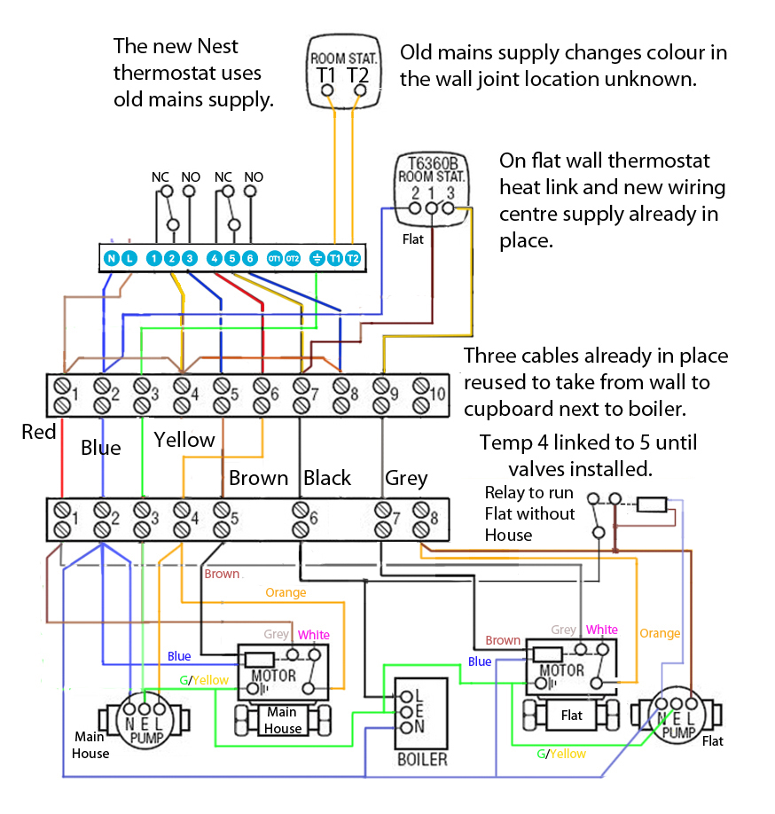

When I did my house, I had to sit down and draw out what I needed. OK for some reason which I have not worked out, I have two pumps, one for main house, and one for flat under main house, so it did get complex, however you need to work out where the fixed wiring runs, and try to design a system which can use what you already have.
This is why I used useless Nest, hind sight is easy, but I knew I had only two cores and earth main house to flat, and some where it changed colours, so I have an unknown junction box some where, so using Nest Gen 3 with only 12 volt seemed a good idea.
The Nest heat link was fitted in the Flat under the main house, and the connection block of the heat link was so small I mounted a wiring centre butted up to the heat link so I have some room to work in. I then mounted a second wiring centre by the pumps and motorised valves, and made a wiring diagram I made many as I refined my design this is an example C_Plan_My_HouseD-relay.jpg so in the future when I reach the 7th age some one else can work out what I have done. Even after all that I made an error, really needs two relays, but not expecting you to follow my design, as for one mine was C plan, but showing how I went about it.
