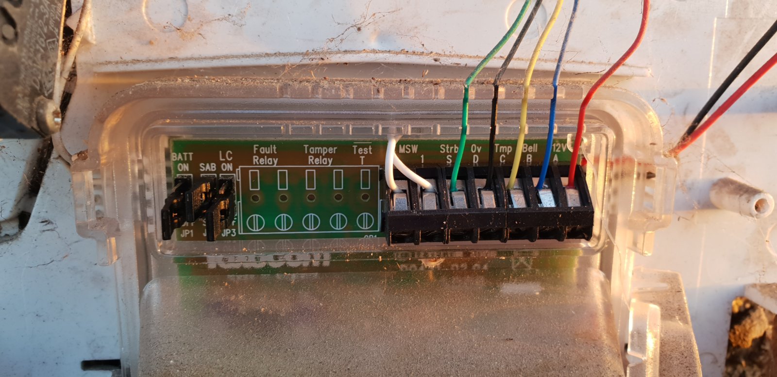

I want to swap my old texacom bell box to a deltabell e / plus box .
Attached is existing wiring for texacom
And also attached is my interpretation of how the deltabell should be wired.
I have to swap 2 at mine both accessed via ladder and I wanted to make I got it right 1st time.
Also do I need to use this resistor that came with the deltabell ?
Thank you.
Your diagram is correct.
You do need the link between T and OV
Leave all the black jumpers as out of the box
The only jumper you will need to move is batt jumper from ext to int only when bell box powered up
That is the internal battery jumper
