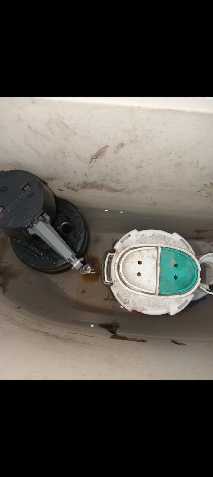

Changing fill level fluidmaster fill valve

Does anyone know how to adjust the fill level on this fluidmaster fill valve?

Thanks I know how to do it on the ones with the plastic screw you adjust. Not sure on this one though with it having a metal rod instead ?
That metal rod passes through a clip on the side of the float. Pinch the clip together and it's possible to move the float up and down the rod.
