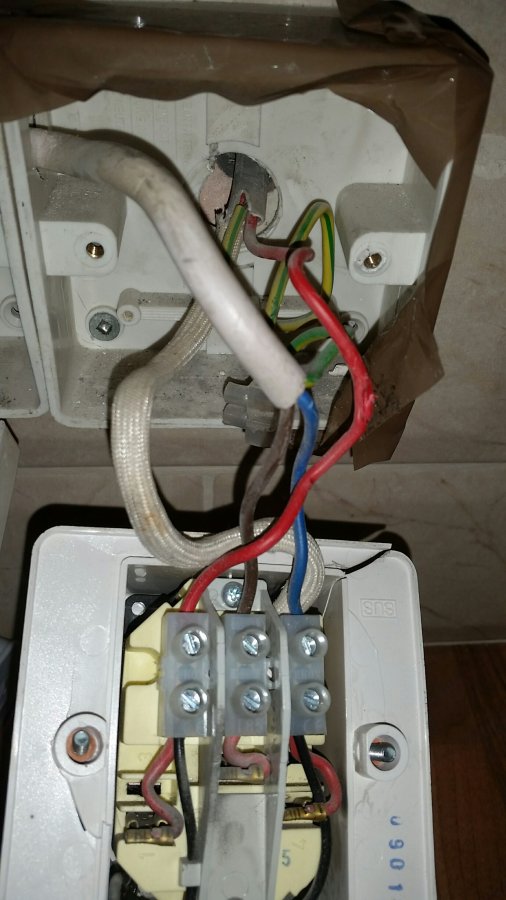

in the IMM24, the 2 red wires (one one sleeved), go from the Live-out, AND the Neutral terminals. 9the sleved red wire goes to the neutral terminal)

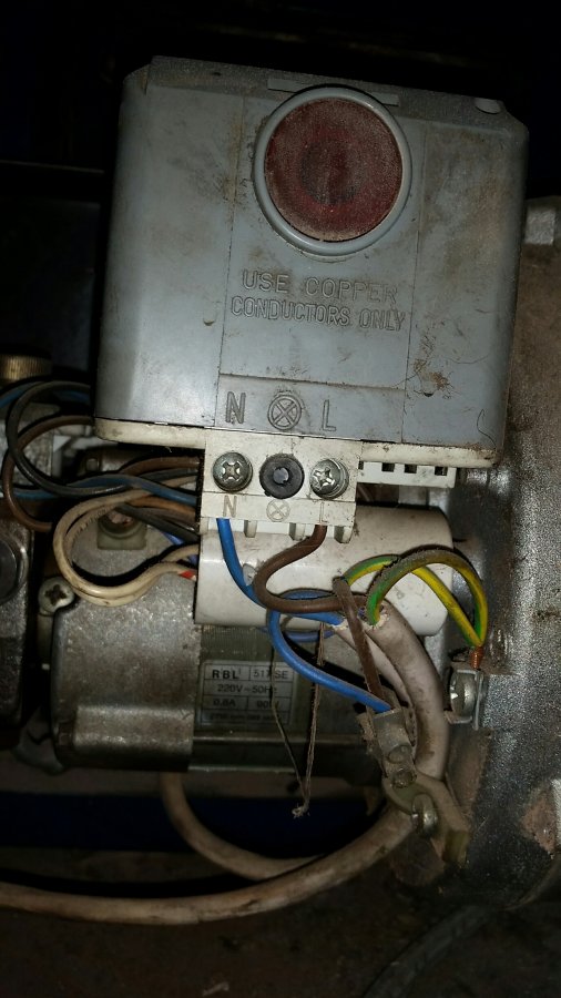

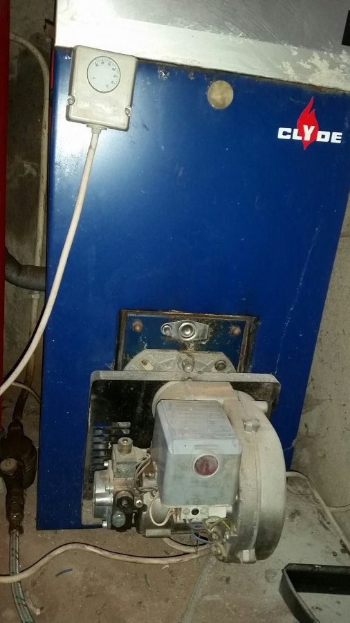

I am sure I am doing something fundamentally wrong here. even as I type this, I am thinking it is something to do with the fact that there is a thermostat-loop on the boiler itself due to the water-temp stat. therefore, the old IMM24 was somehow linking in with that, but that s where I get confused... as the pump and boiler have a mains socket each in the garage, I can see the boiler-stat wiring, and it is a switches circuit in itself, I just can not fathom how the wiring in the back o the IMM24 fits into the whole thing...

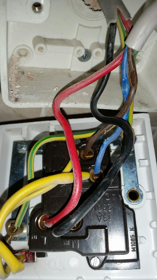

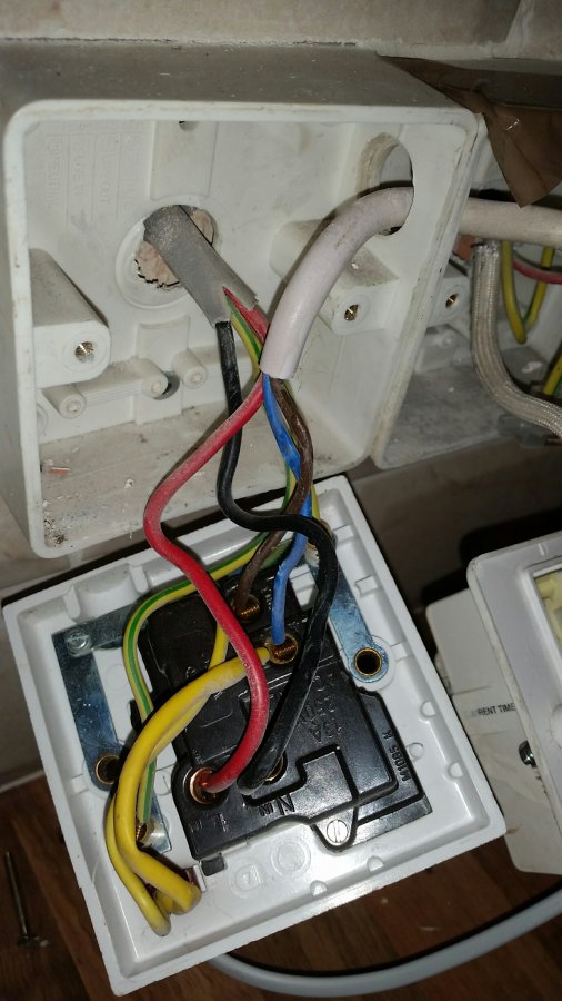

this is the master-switch I mentioned, it sits next to the IMM24 timer switch and sends power to the timer
this is inside the IMM24.. see the sleeved RED wire going into the Neutral terminal....

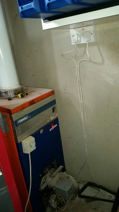

this is the wiring on the boiler itself out in the garage (oil burner). below this is a zoomed out photo showing how the boiler stat wiring ties in....
