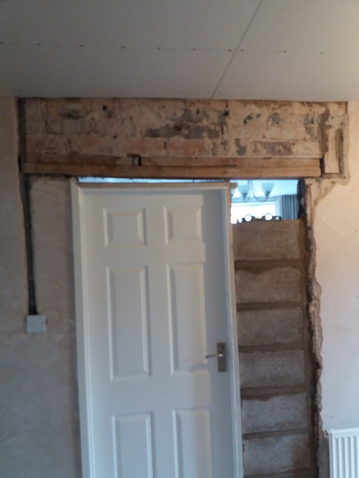

Hi all, still not got round to sorting this and now it turns out that when they removed the old glass panel next to the door and bricked it up they never tied it in. I thought there were verticle cracks due to them leaving the skim beads in so had a nice suprise when i found how loose it all was after i pulled the beads out. Blocked it up again with ties on each course for good measure.
Anyway, my dilema is that there is major historic movement which has left the timber lintel 30mm out of level across the opening. Any ideas on what to do, my dad keeps saying just replace it as is with the pre stressed concrete lintel but i keep wanting to put the lintel in level. If i put the lintel in level then i will have to remove another course of bricks above the lintel and then cut some of the bricks down to accomodate the 30mm taper.
I cant fit padstones either as the wall also forms part of the newly finished kitchen. All of the other lintels in the house are just sat on a bed of mortar on top of the concrete blockwork.
Someone please take pitty and guide me through this as ive been trawling the web for hours and cant find anything helpful that is relevant.

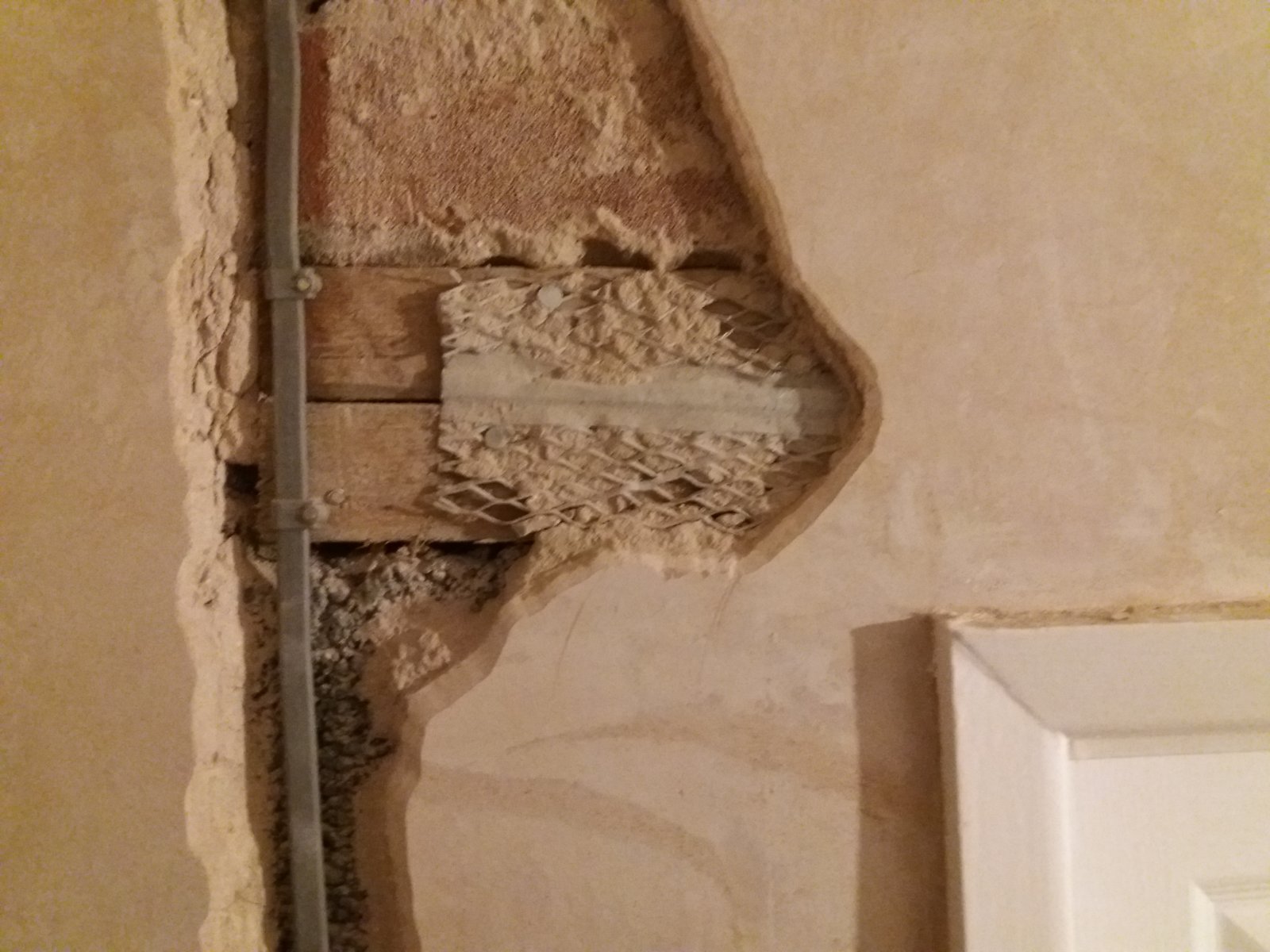

Apols if I’m missing something but can’t you just plasterboard the exposed area in your pics and be done with it? Assuming the timber lintel is only causing problem if it’s plastered directly onto. Which it wouldn’t be if you board it, make good with bonding, blend into existing wall with skim. Or is it bowing/structurally unsound?
Have you thought of re-using that timber lintel. but turning it round through 90 degrees? The way they have installed it, with one piece flat on top of the other is useless. If both pieces are vertical. ie II instead of =, it would be much stronger.
Its not even 2 full pieces of timber, the top one is 3 pieces, cowboy builders! I want concrete anyway mate as the timber one originally cracked and blew the plaster due to its expansion and contraction nature.
What about going back to the 65mm concrete lintel and packing to low end up 30mm?
I cant get hold of a 100mm lintel now due to the lead time for delivery as its not a stocked item. My thoughts now are to bring the new blockwork on the pic up level to the opposite side and then remove 1 course of brick above the lintel. Fit the 65mm lintel level on mortar beds and then whiz down dense concrete blocks to infill over the lintel which will alter in size by 30mm as they go from side to side due to the subsided wall.
Does this sound right or will the cut down dense concrete blocks cause an issue? I cant use the existing bricks as the opening is too large on one side (due to lintel being 30mm thinner than existing timber) unless i had 20mm + mortar beds on the first couple. The bricks on the other side would need around 15mm trimming off which would be hard to do hence thinking of cutting the concrete blocks down to the required size.

Are those blocks tied in every course? If not, avoid any argument that lead to door slamming. You'll need some mesh across that joint.
For the lintel, bed the lintel up and put a timber infil above the frame, or pack the joint with some clay tiles.

What do you think about the cut down dense concrete blocks to fill back in above the lintel where i will have removed a course of bricks? The bricks as is are too small one side and too big the other if i fit the lintel level. My dad keeps saying put the lintel in as is (30mm out of level) but i want to level it up.
I was going to fill in between the frame and underside of the lintel with dabbed on plasterboard then bond and skim over.
You can infill with cut blocks, but you may have a job cutting them. Thermalite blocks can be cut into strips with a hand saw.
That vertical joint will crack, so could do with a 100mm galv or stainless steel mesh bonded across in the plaster base coat to control potential shrinkage.

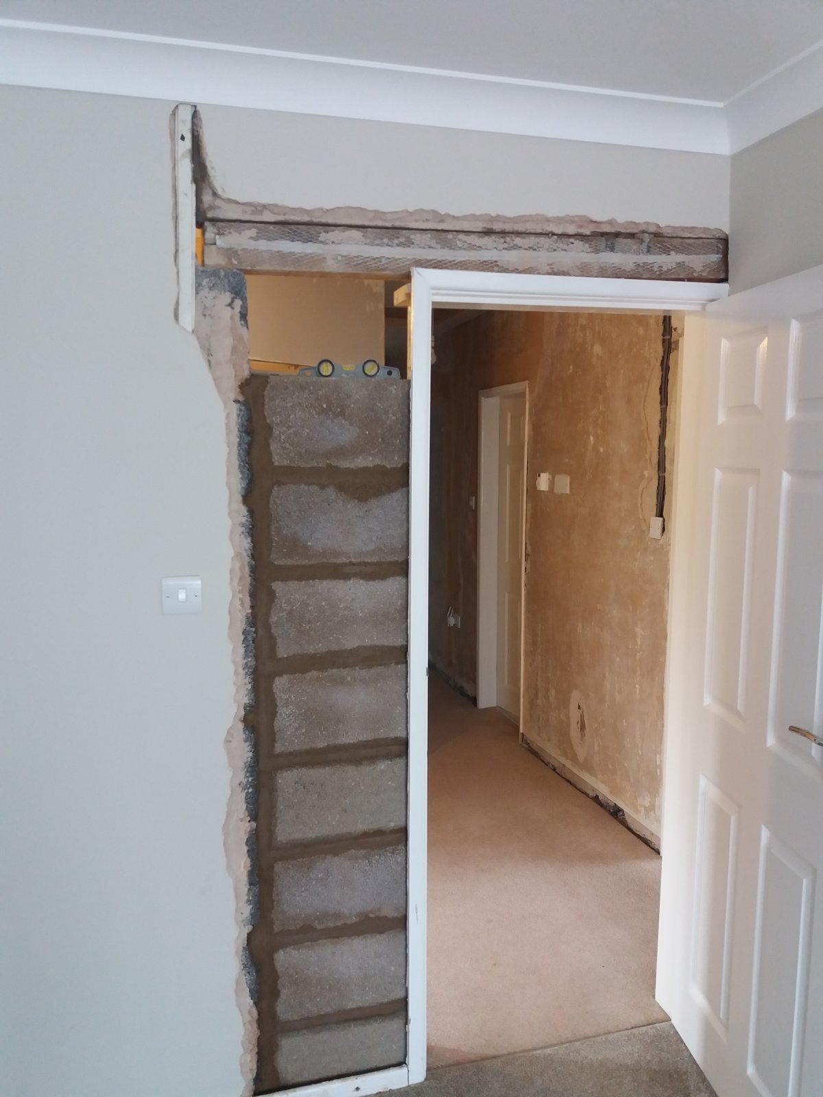

Hi all. Ive got my bearing points level for my concrete lintel but this now leaves a tapering gap of 30mm - 10mm between the top of the lintel and the brickwork over due to the new lintel being level in a subsided wall.
I was going to remove the next course of brick above and replace with cut concrete blocks to accomodate the taper. When i removed the lintel though i was expecting to see a hole into the new kitchen but luckily the plastering had separated from the timber lintel and so has not damaged the finished wall in the kitchen. However, if i remove a course of bricks then that will certainly make a big hole into the kitchen.
Basically i need to know can i fill the varying joint of 30mm - 10mm with rammed in mortar to avoid any unnecessary disruption removing another course of bricks or is that too much? I was thinking that stone walling has large beds of mortar so maybe it would be ok.

You could dry-pack this gap.
3 x sharp sand, 1 x cement, mixed with just enough water to be able to form a ball when squeezed in your hand... not wet like mortar.
Ram this in the gap, and tamp as tight as possible. This will be acceptable to fill that gap.
This method is used in some underpinning.
