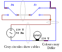

This shows the standard wiring, there are variations, but this means you have a master and slave switch and the master easy to replace with on/off, but since the slave work through the master, unlikely the wiring can be used to work a different lamp set.

View attachment 364531 This shows the standard wiring, there are variations, but this means you have a master and slave switch and the master easy to replace with on/off, but since the slave work through the master, unlikely the wiring can be used to work a different lamp set.
