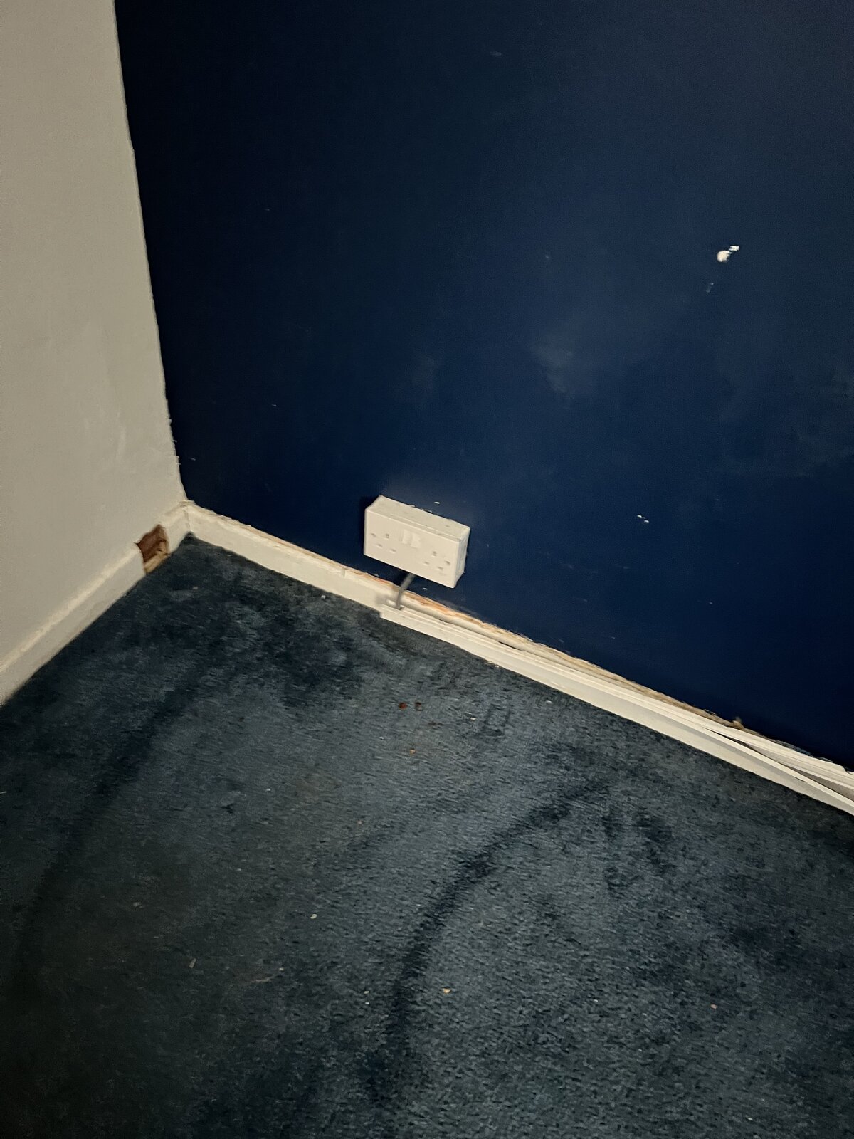

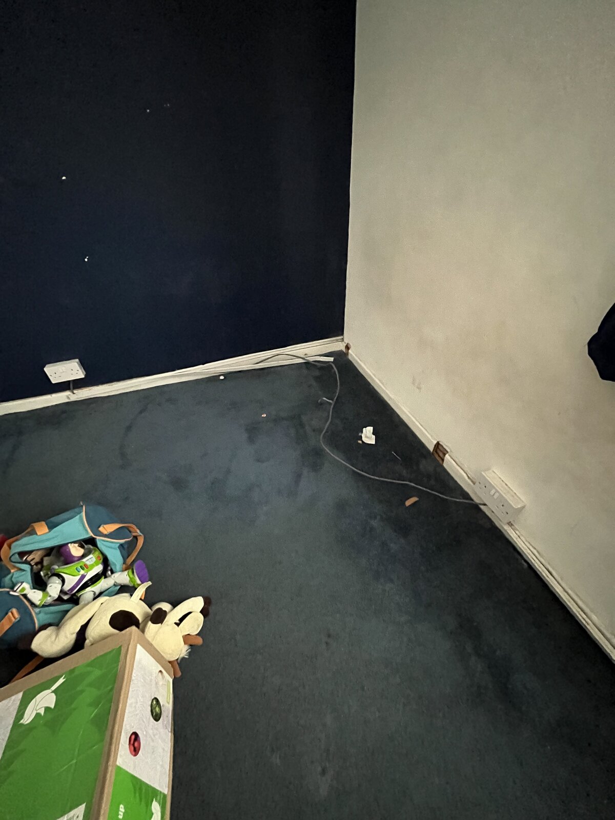

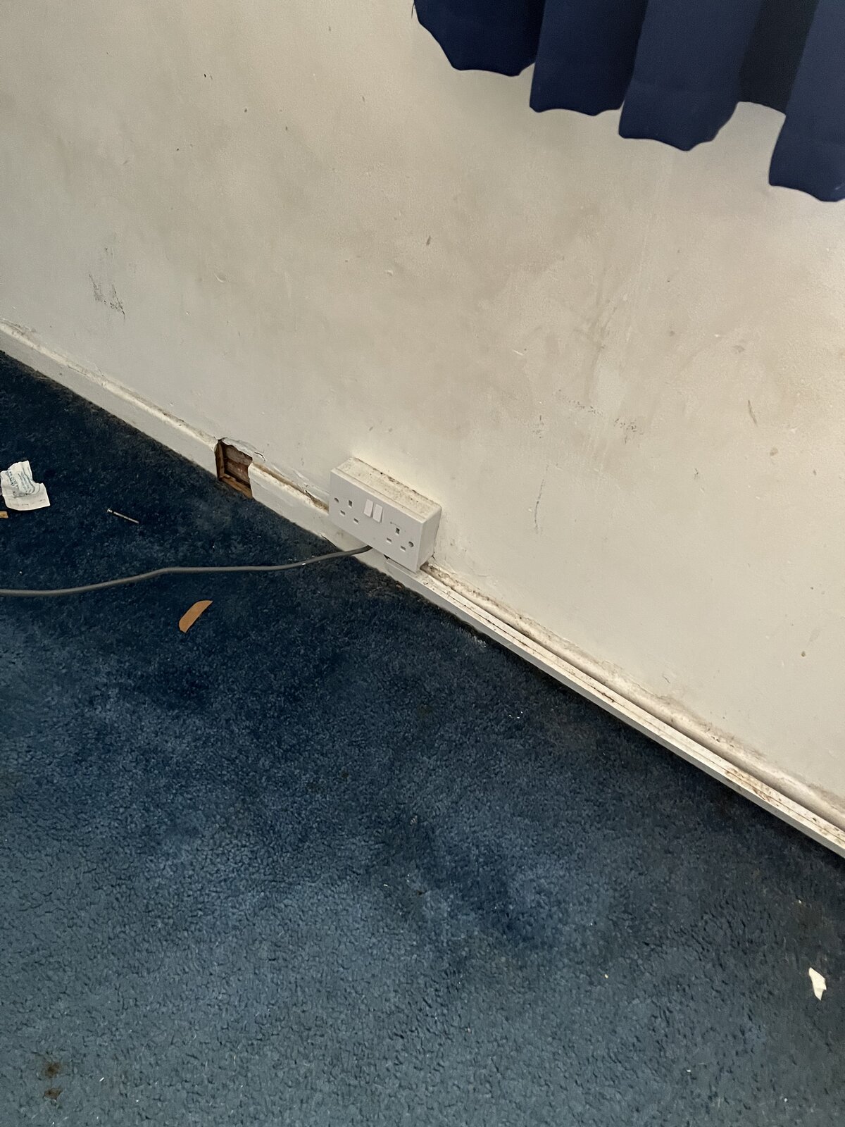

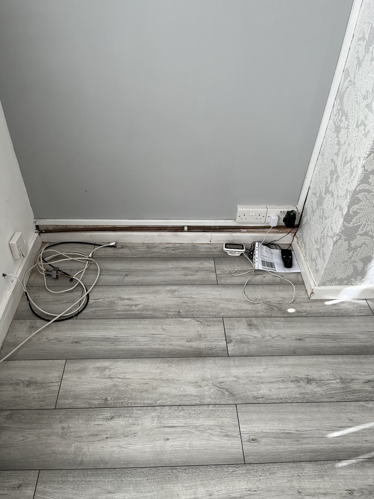

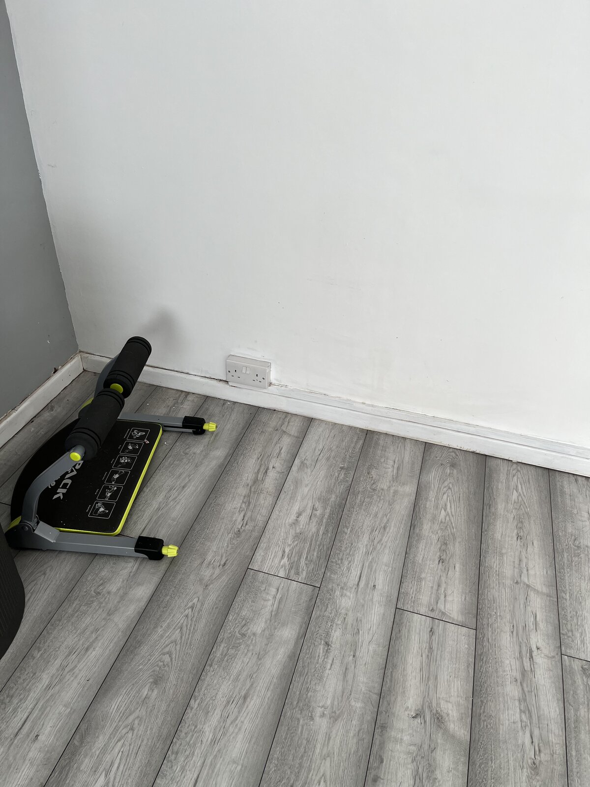

don’t really know any sparks so hopefully i can get some advice please. I’ve just bought a house and all the sockets aren’t sunk into the wall and the cable is the same all ran in pvc trunking around the whole house. Looks like there’s been a rewire as mostly new cable’s but i want to chase them all into the wall and then just fit new back boxes with new faceplates. I’m a brickie so confident in the chasing and fitting the back box’s but just wanted to know if I’m allowed to wire all the plugs and sockets back up myself. I wouldn’t be changing anything just putting them back where they were originally.
Fully aware of zones and how cables run as i work on site and see where/how cables are run at 1st fix but just want clarification that i am allowed to do this under regs.
Attached a few pics to this post.
Would appreciate any advice or tips.
Thanks.

Yes you are, but you need to make sure all the sockets are protected by an rcd if buried in the walls

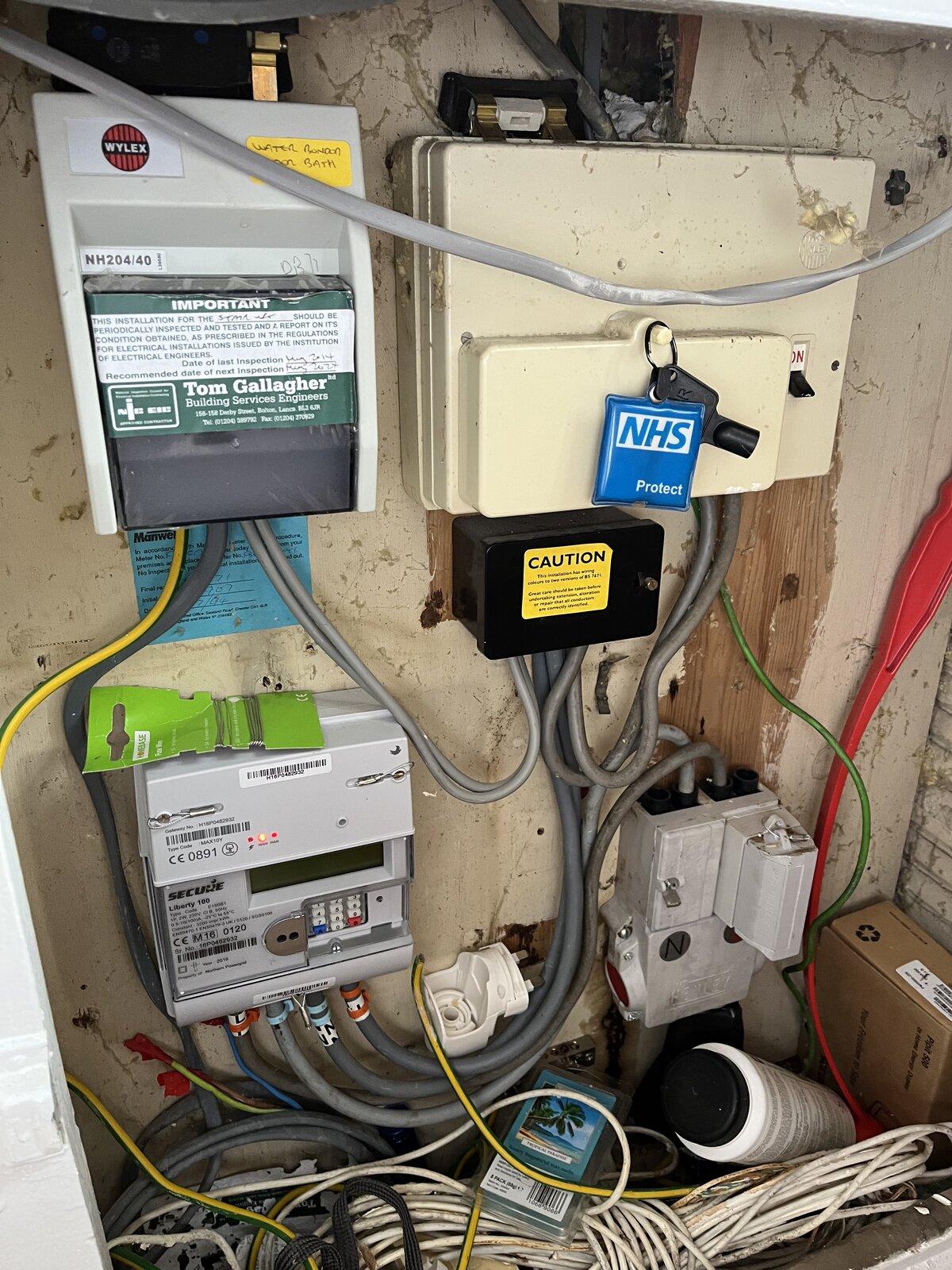

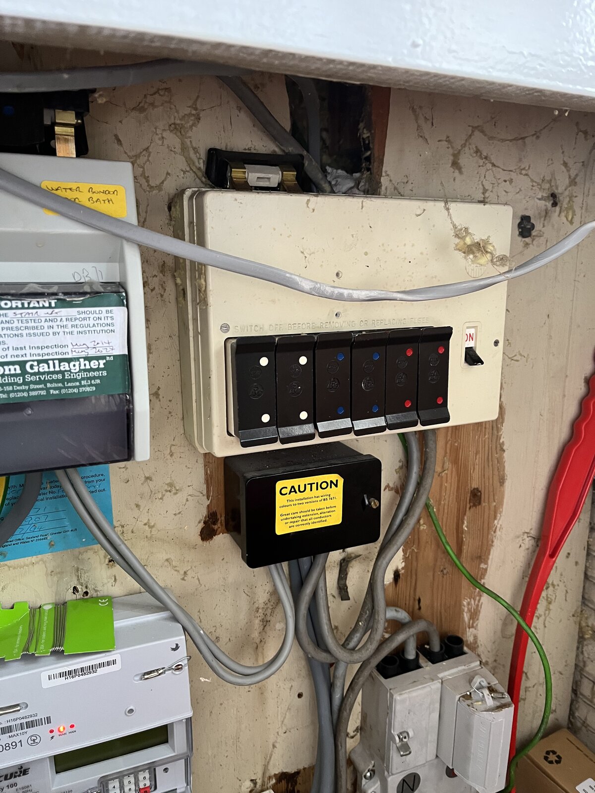

This is what I assume is the original fuse board, i was getting a spark in to replace with a new consumer unit, i presume that will have the relevant rcd’s & mcb’s so that the sockets i install will be protected?

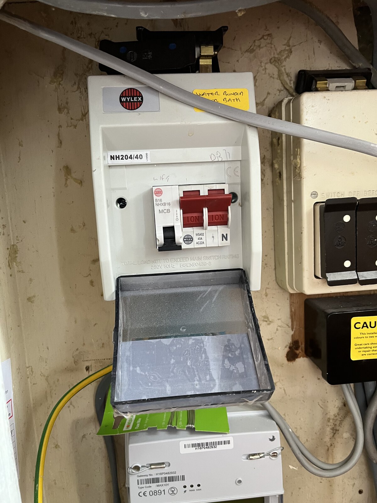

Unsure what it is as I can’t read what he has written in the top right corner but something along the line of “under bath”
Was hoping someone could tell me what it is. Not got the keys yet to check under the bath but no electric shower so not sure what it could be.

Looks like a mcb for a lift. The wording looks like it explains the water supply is bonded under the bath. Strange place, but old wiring regs.
why is the water supply bonded?
'Bonded' in this case means 'joined electrically' thus ensuring that there is no potential difference (voltage) between the pipes and therefore the connected metal taps.
I would assume that your water supply does not enter your premises under the bath so the 'main bonding' will be somewhere else such as under the kitchen sink.
Thank you for explaining that mate, really helpful
The CU is in the region of 40 years old, and much of the cabling probably the same.
You would do well to have an electrician inspect it and provide a written report before you start tinkering
Though it may be better value to just fit entire new from scratch.
Try to find an independent local electrician who will co-operate with you chasing out the walls and backboxes beforehand, and making good afterwards. There are a few points you need to know, like routes and grommets, and the modern height. I favour mortaring the boxes into position, which I'm sure you can do, better and quicker. It is much easier in an empty house before you move in.
