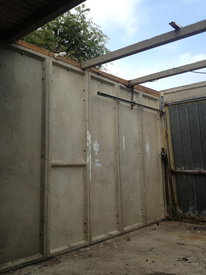

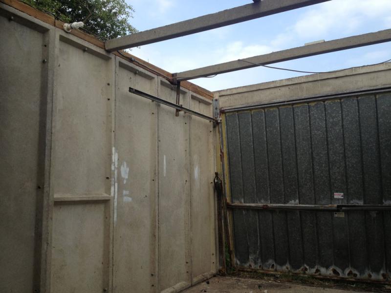

Hey all, Have a sectional concrete panel garage, with concrete purlins to support a roof.
I have carefully removed the possibly asbestos corrugated roofing panels (that were badly leaking)
I had tryed a sort of horrible DIY nightmare fix of attaching corrugated bitumen panels to the purlns, which after the first sunny day went soft, deformed, and then started blowing down in the wind.
So whats a reasonably cheap/easy way to roof a garage like this?
I had though about OSB with hammer in fixings to the purlins then just felt over it?
Osb3 followed by EDPM could be the way to go, worked well on a job I did last year. The OSB would probably need to be 4 sided tongue and groove. Screwing it down to the concrete joists doesn't look fun though. You could fix 2x4 to the side of the concrete and screw to that.
