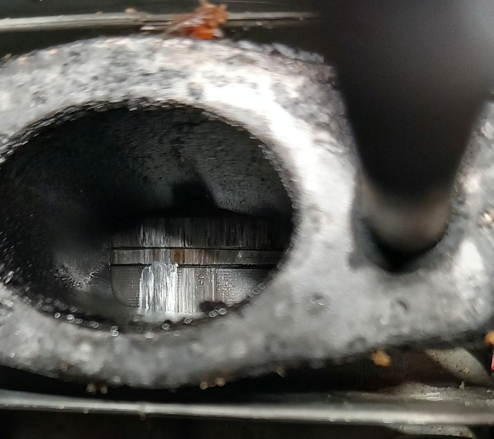

Just an update, guys. It was indeed, down on compression. Wide open throttle and a couple of dozen pulls, wouldn't get it to 90 PSI. Took the exhaust off, and the piston has indeed wiped over the rings. Thanks for all the help!
He's got "form" for this sort of thing. I've seen him mixing 2-stroke before, and no matter what the ratio is supposed to be it always just gets "some". Sometimes you can't see across the garden for smoke, other times... well... you've seen the piccy!
Depending on the make, piston and barrel kits are available at really competitive prices (Stihl, Husqvarna etc) - but if it's uncommon or some B&Q thing then it's scrap.
People just don't listen and learn!
John :)
John :)
It's a cheapo MacAllister. I'd have to see if there was bore damage as well, so it's really just not worth it.
