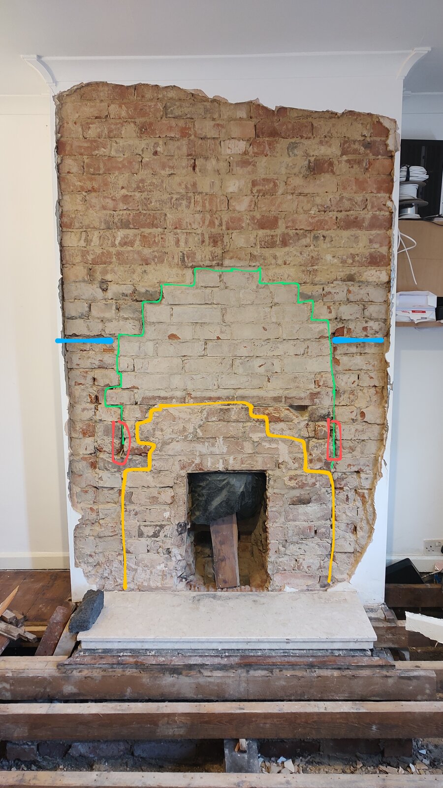

Hi all,

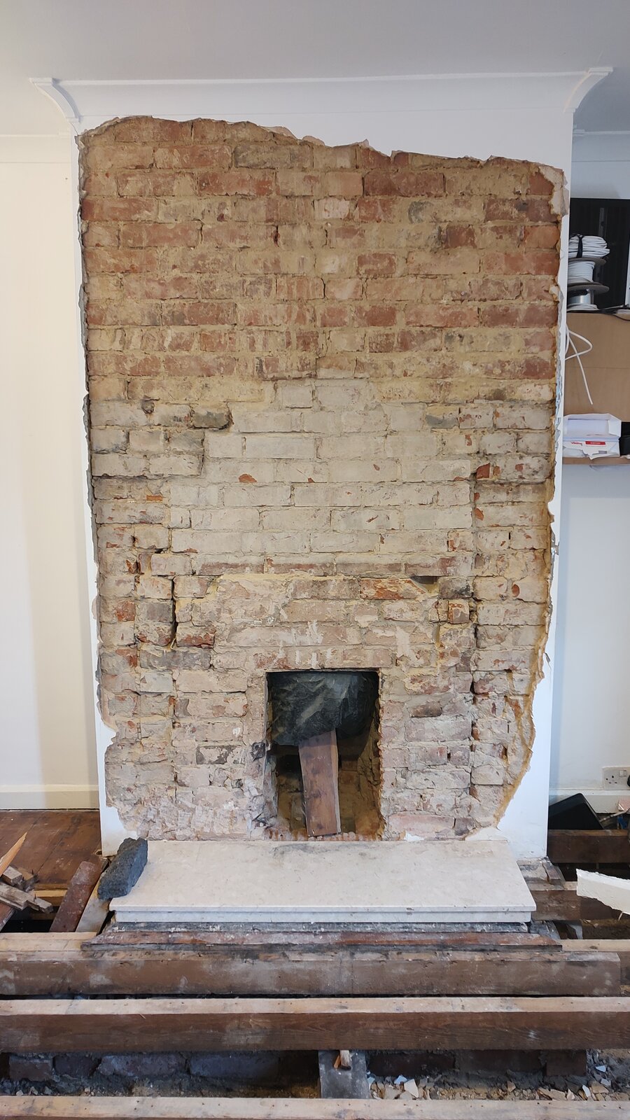

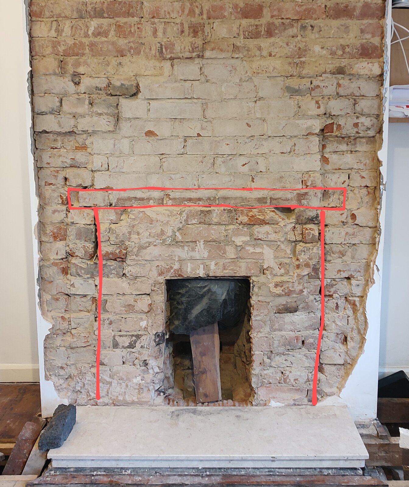

I'm planning to open a larger opening in this chimney breast, in order to install a direct air supplied stove, insulate & seal the flue liner, block any other draughts in to the room.
(Background: retrofitting airtightness and insulation to a small 1926 house)
I think it will be OK to use a few accrows in above, supported on a board across the hearth, to install a lintel as shown in red, then knock out the brickwork inside in red, back to the party wall, then line it. Am I missing something important?
I wanted to know if the appearance of the brickwork suggests the history of it's construction and alteration?
It had a small gas fire installed in the present opening, which has a metal lintel and an untidy rubble fireback.
A neighbour says it used to have an open fire with back boiler.

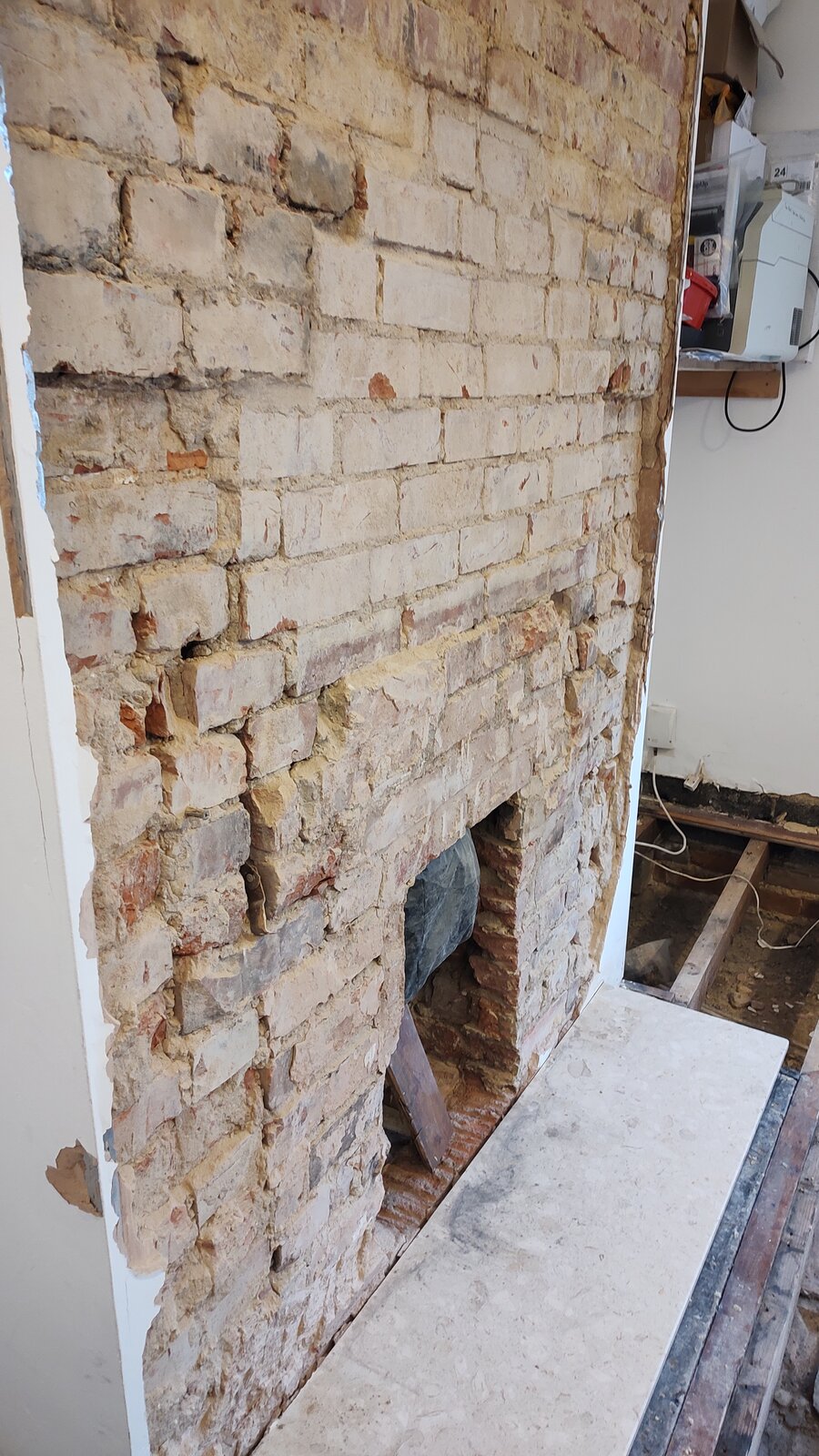

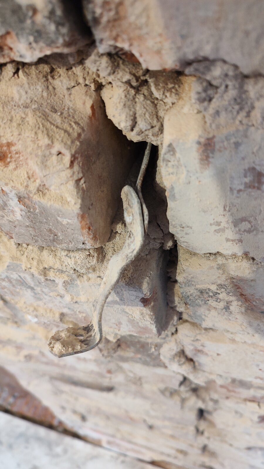

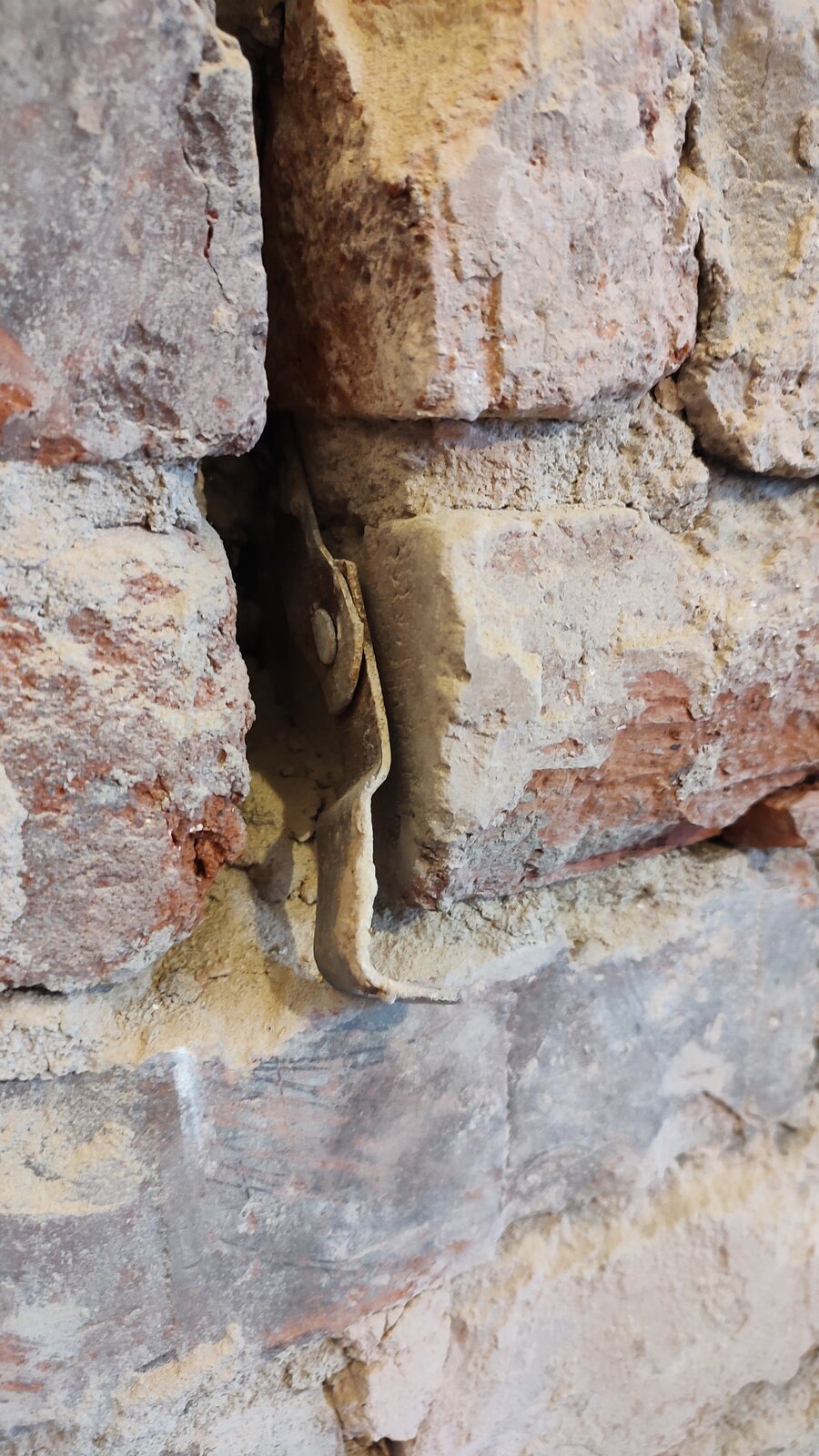

The brickwork face is far from flat and looks discontinuous, I think there's some kind of infill in yellow, a patch in green (is this from construction of the chimney throat?), a step in the face at the blue line (why??) and some brackets left in nooks in red (for what?).
Brackets:
Diagonal view
Brackets:
Diagonal view
