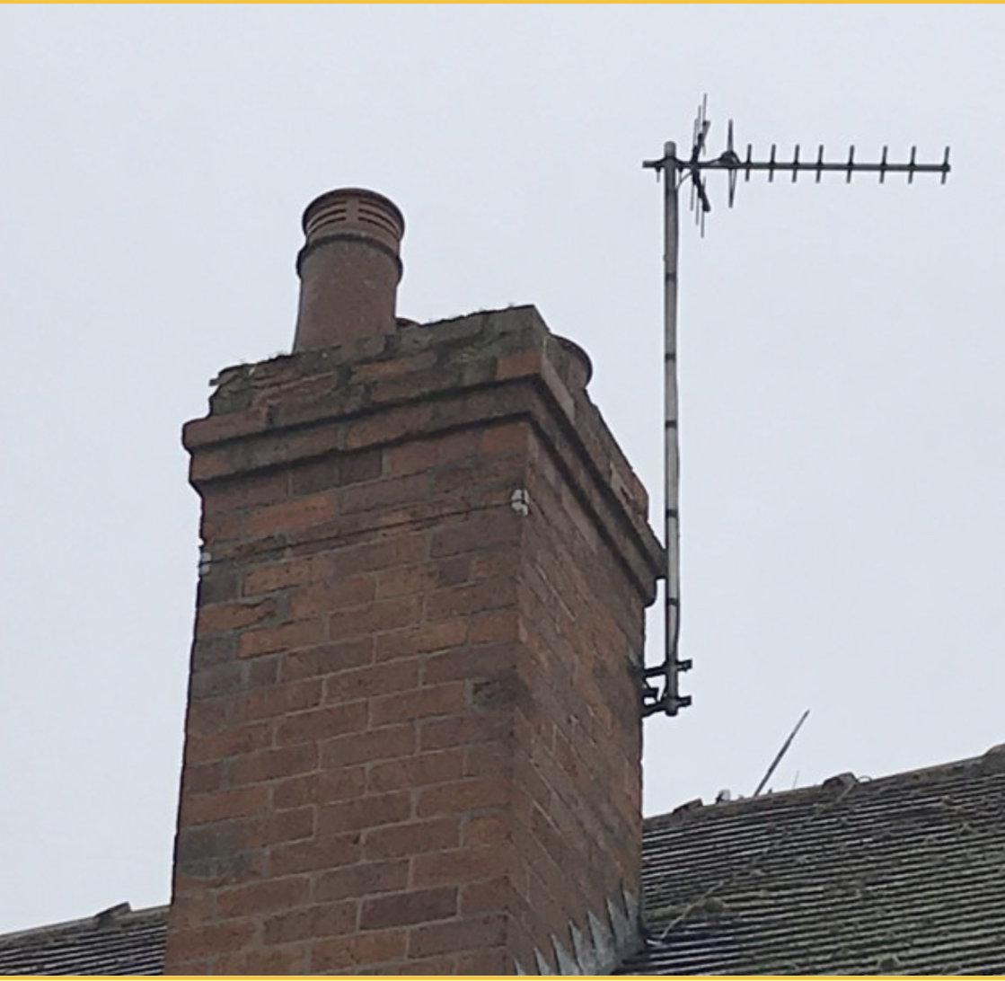

A pic of the chimney stack might help?
If it is a shared stack then you should be able to see the neighbour's chimney breast through what looks like an opening in your party wall.

A pic of the shared chimney stack above the roof is what I'd like to see?

This was taken a while ago I can take another one tomorrow if needs be.
The only remaining brickwork is what’s in the loft and the stack above the roof. The chimney breasts in the bedroom below and the room below that were removed.

Thanks for the stack pic. So it looks like its your eyes on site to determine how much support from below is supporting your side of the stack? There surely is some support.
