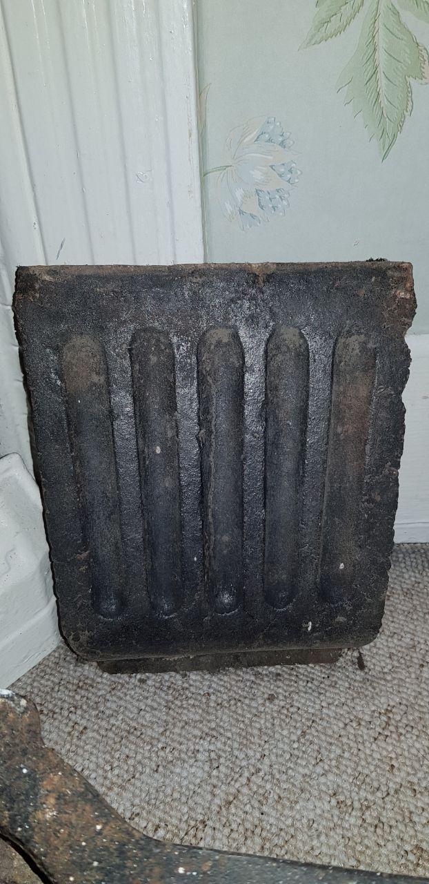

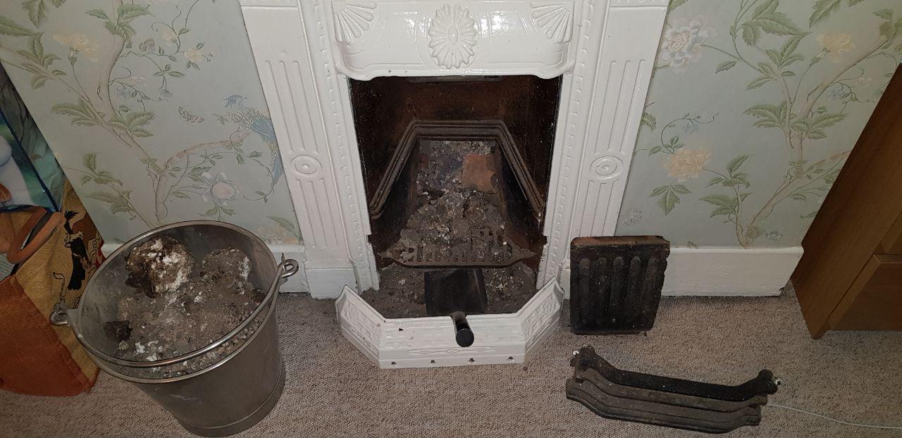

We purchased a 1920's semi detached house a few months ago and it has 3 fire places, 2 downstairs and one in the front bedroom, the two downstairs ones are clear, we use the one in the living room directly below the one in the main bedroom.

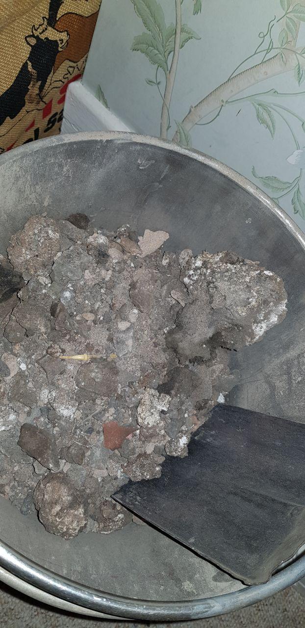

I was just looking at the one in the bedroom and noticed dust had been coming in from behind a weird brick... after wiggling the brick around it came loose so I took it out, I think it was just covering the back of the fireplace.

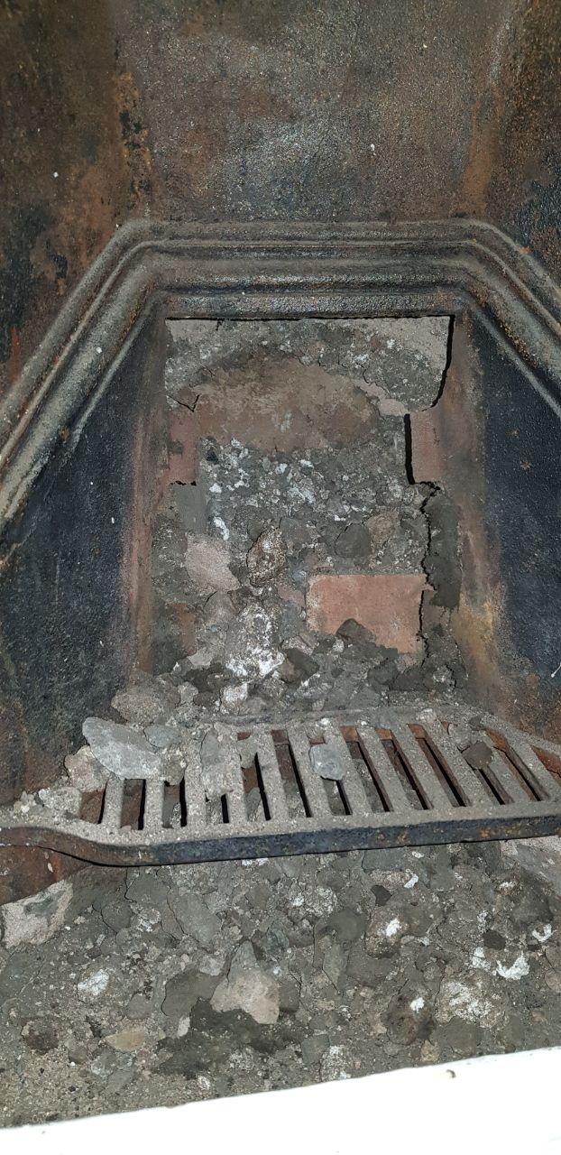

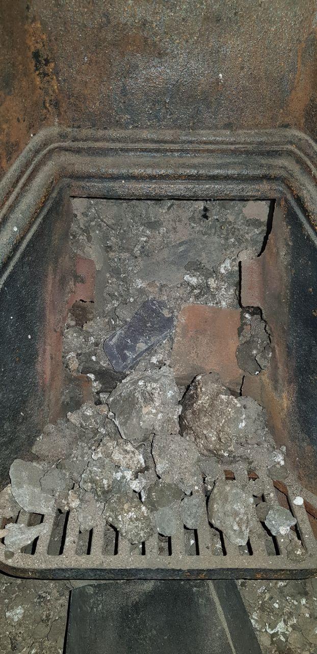

It revealed a lot of debris which I think has been there for many years. I started taking bits out and ended up with a bucket full of rubble and dust, now I've uncovered a load of loose bricks and lumps of white mortar like rubble. Only problem is when I remove bits, even more falls down from above.
Can anyone tell me if I'm in the danger zone here? is this OK to remove? only the eventual plan is to be rid of the fireplace, brick up, plaster and fitted wardrobe on that wall.
on a side note we do have damp coming down from the top of the chimney into the room which is apparently the crown and poitning that has gone on the stack, We've been quoted over £2000 to re-crown and point it which seems a lot and as it's not too bad at the moment (having a fire burning downstairs seeems to drive out the moisture.) we're not in a rush to have it done (money is really tight).
Pictures are of the brick (V shaped with 5 indented lines) The bucket of stuff I removed so far and the opening it has left.
Any advice would be greatly received :)

Thanks for the response, I'm not removing bricks as such the only 'brick' i've moved is the backing of the fireplace (the black one thats almost square)
The other brick is sat loose on a pile of rubble behind the fireplace, so removing it from the pile of rubbish shouldnt hurt? I'm just not sure if this pile of rubble, slate and brick is normal to find behind an old fireplace or if it's the inside of my chimney falling in, I had all of them swept and the sweep didnt point anything major out, just that the second downstairs has a metal plate blocking it.
I'm not about to start removing any courses of bricks, my intention is the opposite, Once the cast iron fireplace is out it'll be bricked and plastered (hopefully)
Here's a bigger picture of the fireplace, just in case it was unclear what i'm dealing with...

your not in any danger zone.

the rubble in the bedroom fireplace could be loose, sand and cement parging from the flue - a camera down the flue would indicate the condition of the flue & the parging.

If i understand you correctly, you’ve taken the fireback out of the cast iron fireplace and exposed all the rubble the builders put there to fill the void when they originally fitted it.
you’re in no danger of the chimney falling down. I suggest you just put the fireback back in and leave it alone.

I'd agree with @Lower -- it looks like you're simply removing the backfill from behind the fireplace. I remember when we opened up our first fireplace there was a LOT of brick and rubble which had been used. Was very daunting at the time removing solid bricks.
