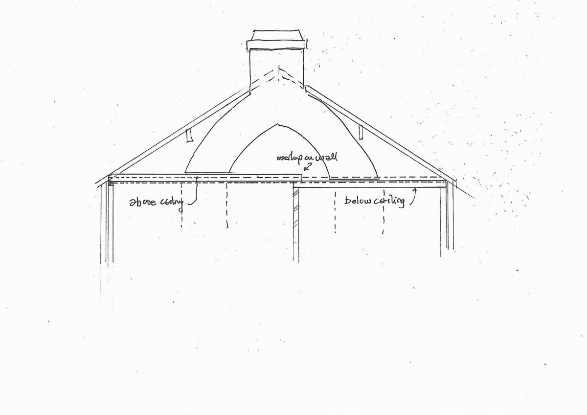

Presumably a cranked beam so that it could sit up a little between the rafters and follow the roof line?
That could be expensive in terms of fabrication.
If you could have one of the beams just below the ceiling, and the other above, you could avoid the need to crank them.
The beams can overlap over the central wall (assuming it is load-bearing and goes down to ground floor level).
