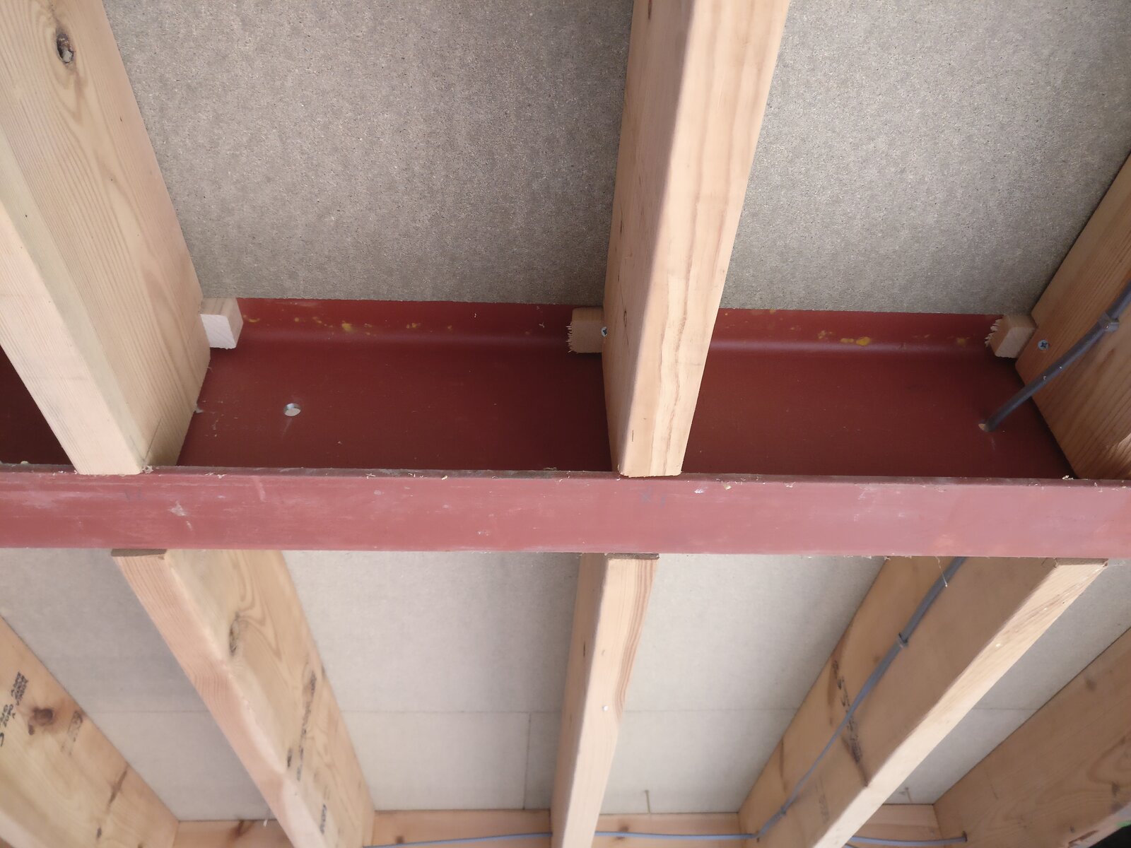

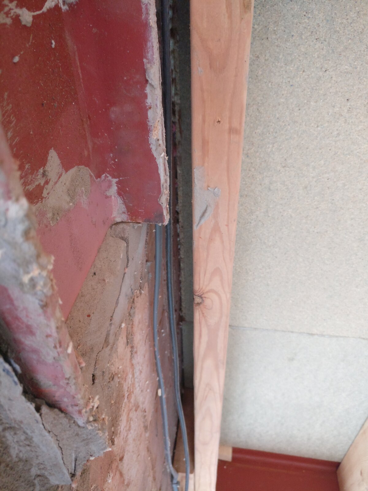

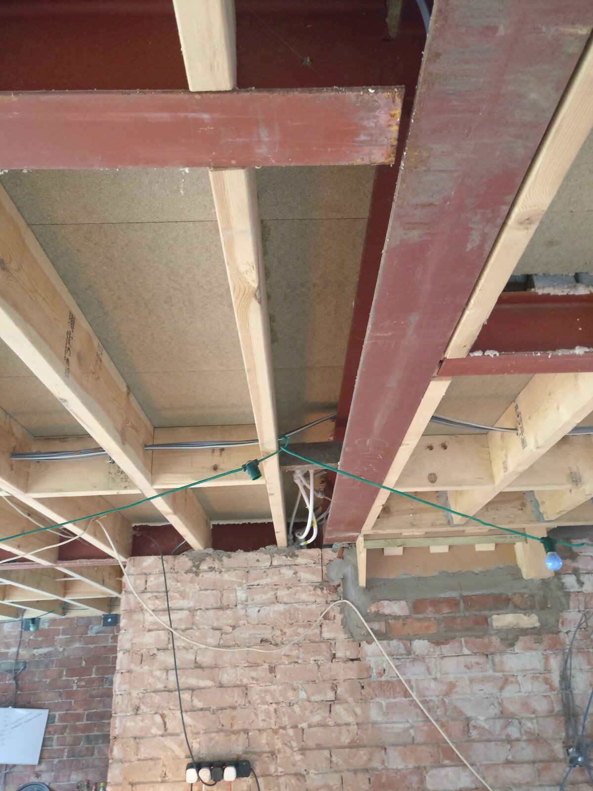

Hi to all,
I've had a renovation done on my bungalow that has all sorts of problems. Todays issue is chipboard flooring making a cracking or maybe crackling noise when walked on. Its 22mm tongue and grove flooring that has been nail gunned in as far as I can tell. The carpet has just gone in and just before that I did two things to address the issue.
Firstly I bought some Floor-Tite Tri-Lock Pozi Screw 4.2 x 55mm and screwed them down next to all the nails (if there was an improvement it was negligible).
Second - The worse affected part is in the middle section of the main bedroom. The floor is supported here between two steel beams but the ceiling/floor joists haven't been notched in properly and are just sat loose in the steel with a gap of about 20mm above each joist. When talked on and looking at from the room below I could see a massive amount of bounce on the ceiling. So I cut wedges to fit each one and hammered them in and screwed at an angle to secure.
So the situation currently is that we have just moved in to the house upstairs only two days ago and the downstairs is still a shell (no insulation or plasterboard in the ceiling below). The noise is doing my head in and I really need to address it but ideally from below as the upstairs is all done.
Any and all help appreciated. Just let me know if you need any further info
Darren

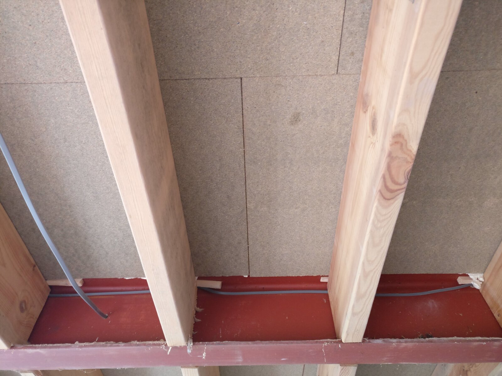

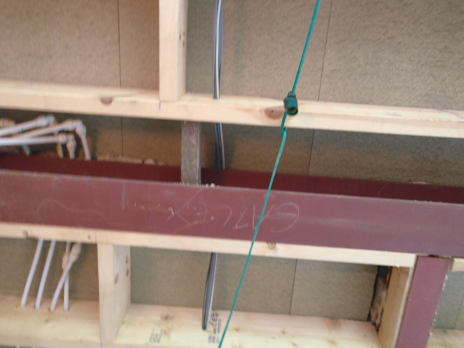

I terms of joists in steels there are number of approaches to take. I think one of the better ones is to drill the steel and bolt a vertical timber to it which carries the joists in steel joist hangers (with a twist nail in every hole, as per manufacturers specifications). The other way is to size the joists to be a dead fit for height to (or slightly deeper than) the steels and notch out top and bottom as required. The overall length should be a few millimetres shorter than the distance web to web of the steels, and the ends of the joists need bevel cuts to accommodate the fillets at top and bottom of the web. The tops of the joists should always be flush to the top of the steels, or just slightly above it (unless the drawings call for something different) and my own preference in that situation is to solid strut between joists near the steels and then to run a bead of silicone, rubberised adhesive, etc along the top of each steel before the sub-floor (chipboard) goes down as this reduces and possibility of knocking at that point. It takes a little bit more work, but you often end up being able to use end trim cuts from the joists to do your strutting. Wedges don't take the place of doing the job properly, so any chance if some photos from beneath so we can see what the issue is and maybe proffer a more permanent solution?

Hi and thanks for the reply. There is about a 20 to 30mm gap around the edges of the floor where it goes in towards the eaves but it does get quite tight on the gable ends (few mil or even butting up to the brick in places, see pic). At the gaps towards the eaves I planned to either expanding foam or just leave them as from the upstairs they are in voids/storage space and will be insulated under before the ceiling goes in.
No walls built on the floor, its all block work built onto the steels.
By end joints, do you mean where the boards join together at the ends (600mm width) or the longer (2400mm length). In either case the answer is no though. I guess I just need to stick in a noggin and screw through the sides of the ceiling joists, or do I need to also screw up into the flooring?
With regards to strutts, they have used offcuts from the joists but only one in each run of about 2 meters between the steels (see pic). Apologies if I'm not explaining this well or missing your points as I'm not too knowledgeable on these things.
Thanks very much for your advice so far, and yes I have absolutely learnt my lesson about employing complete idiots to work on my house. I’ve attached some pics, the main issue being the floor that spans the two steels in the front of the room. The floor that goes from steel to the wall doesn’t seem to have much of an issue. At least nowhere near as bad as between the steels.
