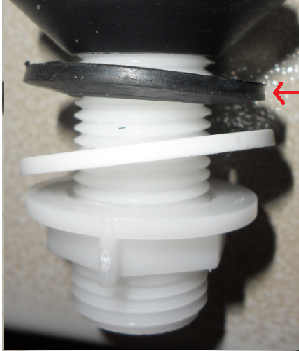

The pic below shows the bottom of a fill valve which is to be located within a toilet cistern.
The conical shaped black rubber section at the top of the pic would be within the cistern, and I'm fairly sure from the white plastic washer down would go on the outside of the cistern.
Does the flat black rubber washer marked with a red arrow go on the inside or outside of the cistern? It's not clear from the instructions.
Thanks.

The type of cistern will depend upon which type seal to be used.
If a porcelain cistern use the conical seal , if a thin plastic cistern then use the flat one.
The plastic washer should be used between back nut and cistern , disregard the rubber seal not used.

I'm not saying this is not correct, though the fill valve pictured is that which was supplied by the cistern manufacturer to be fitted to this cistern. So I would have thought they would no include an incorrect rubber washer for another type of cistern.
It's a porcelain type cistern.

I'm not saying this is not correct, though the fill valve pictured is that which was supplied by the cistern manufacturer to be fitted to this cistern. So I would have thought they would not include an incorrect rubber washer for another type of cistern.

Indeed... on a thin plastic cistern casing, the cone washer would place a point load and deform the plastic around the aperture, possibly even splitting it if it was old and brittle. At the same time, the thin plastic would cut into the cone rubber.

Thanks very much for the clarification.
