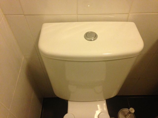

Hi, wondered if anyone could help. The toilet had been flushing fine, but last night just didn't anymore. I have to go to hospital for an op and can't get a plumber out in time but will need full use of the loo :/ I am not sure if someone has any ideas how I can try and fix this myself before I go to hospital? Basically, the cistern seems to have no water in it. Before last night, there was no issue (been here almost 3 weeks too) and the flush was fairly powerful.
Thank you so much to anyone who can help (or has taken the time to read this) :)

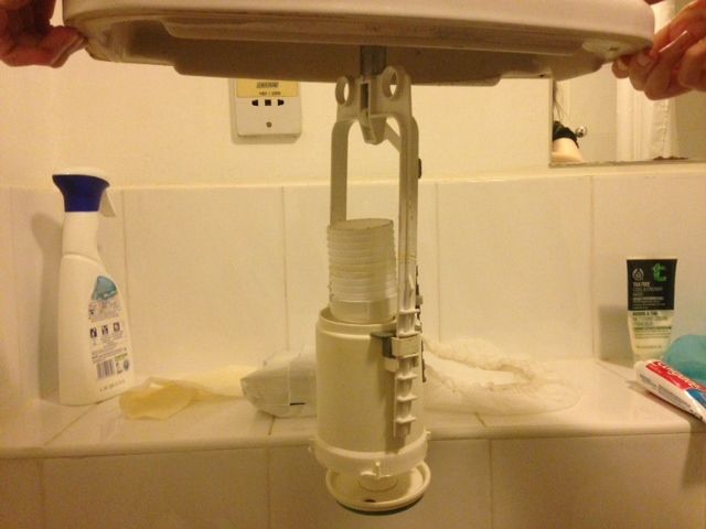

Your second and third picture is worrying! The button on the lid should be detached from the flushing valve before removing!!!!!
It seems you may now have 2 problems :mrgreen: ;)
Thanks TCCHeating! Haha yes that was my partner who had yanked it off :/ I managed to get it back into place after unscrewing it from the button, and unstuck the floating valve (thanks for that :)) and now it works fine!
