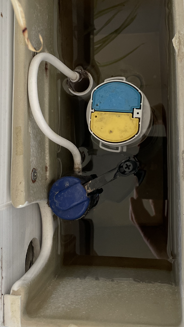

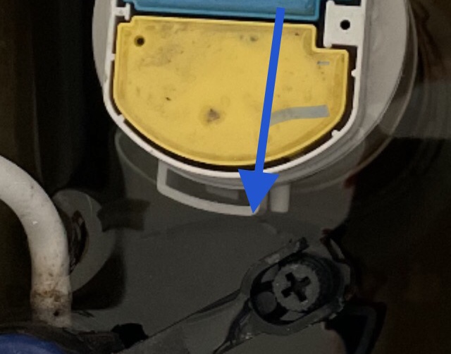

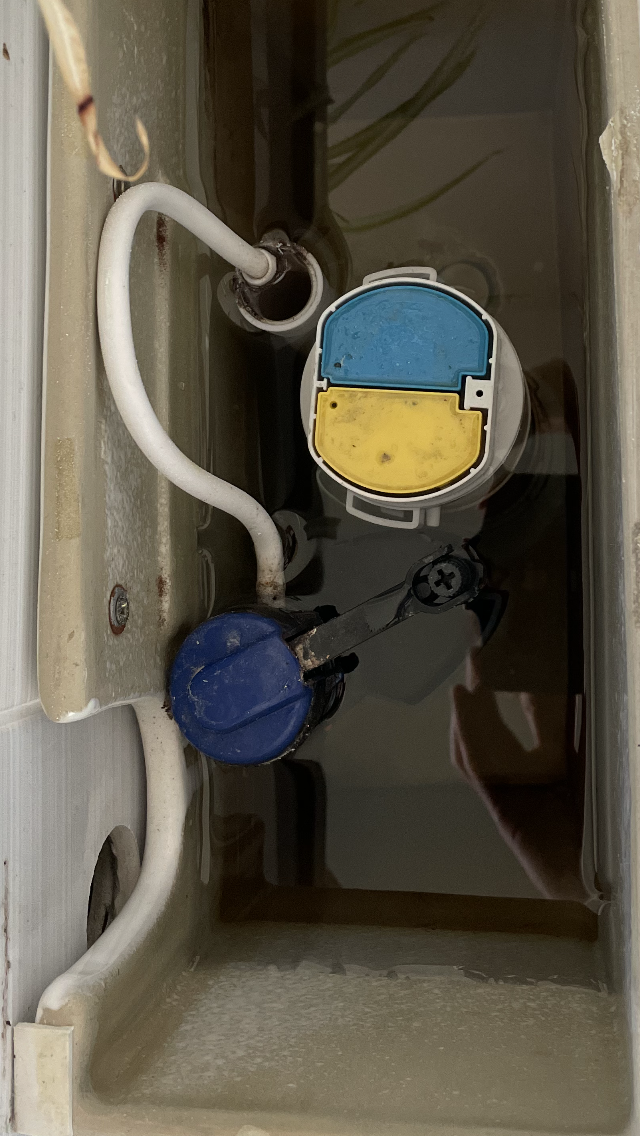

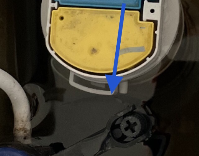

The lad is saying it’s running into the pan from the overflow.
Here’s a picture of it.

Float arm looks to be jamming against side of cistern preventing the fill valve shutting off.

looks like the float is catching on the top of the flush valve.

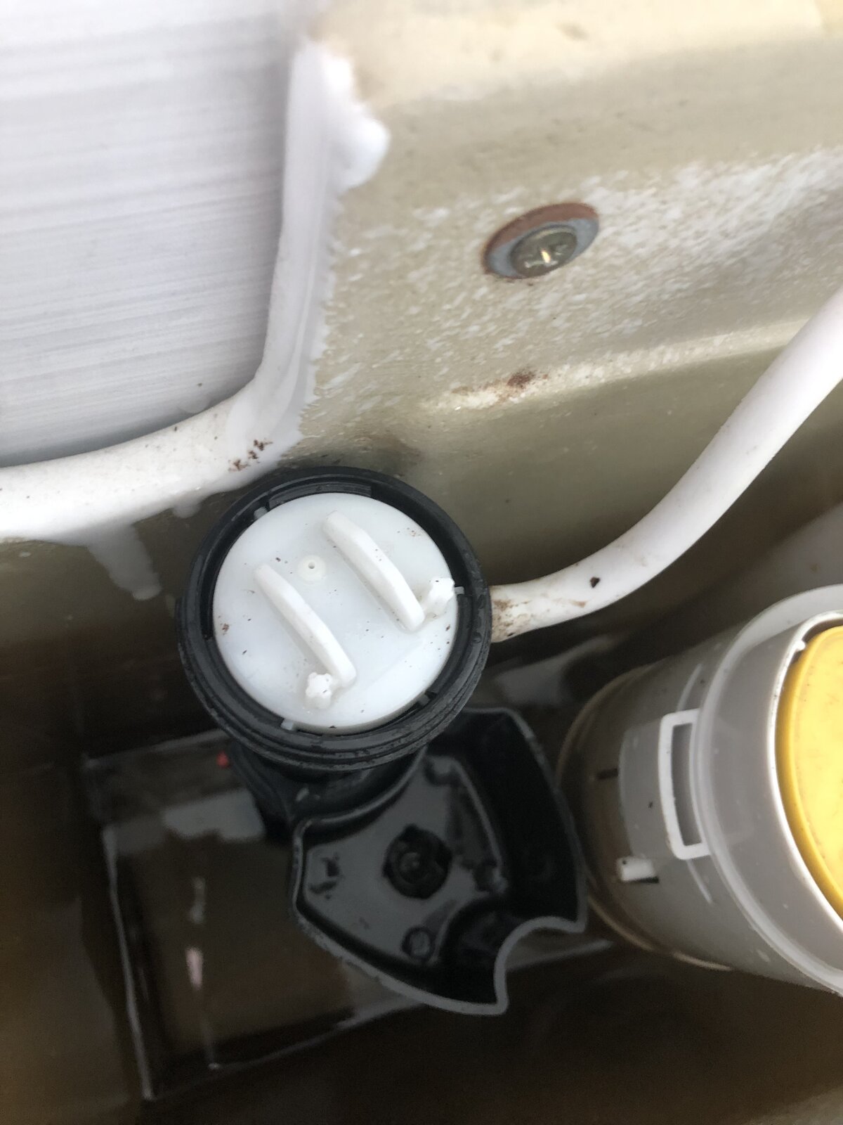

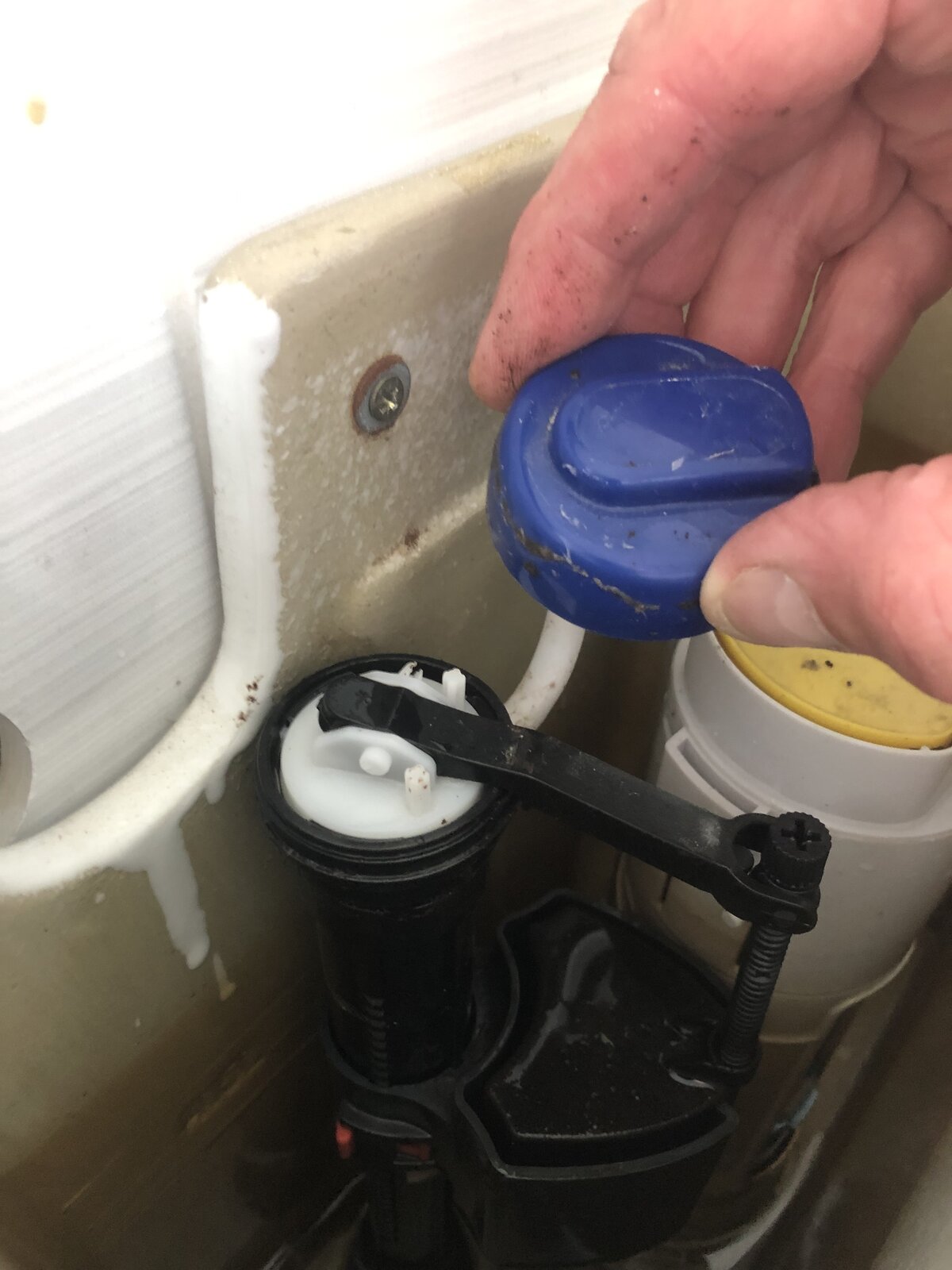

To update and ask a question pls.

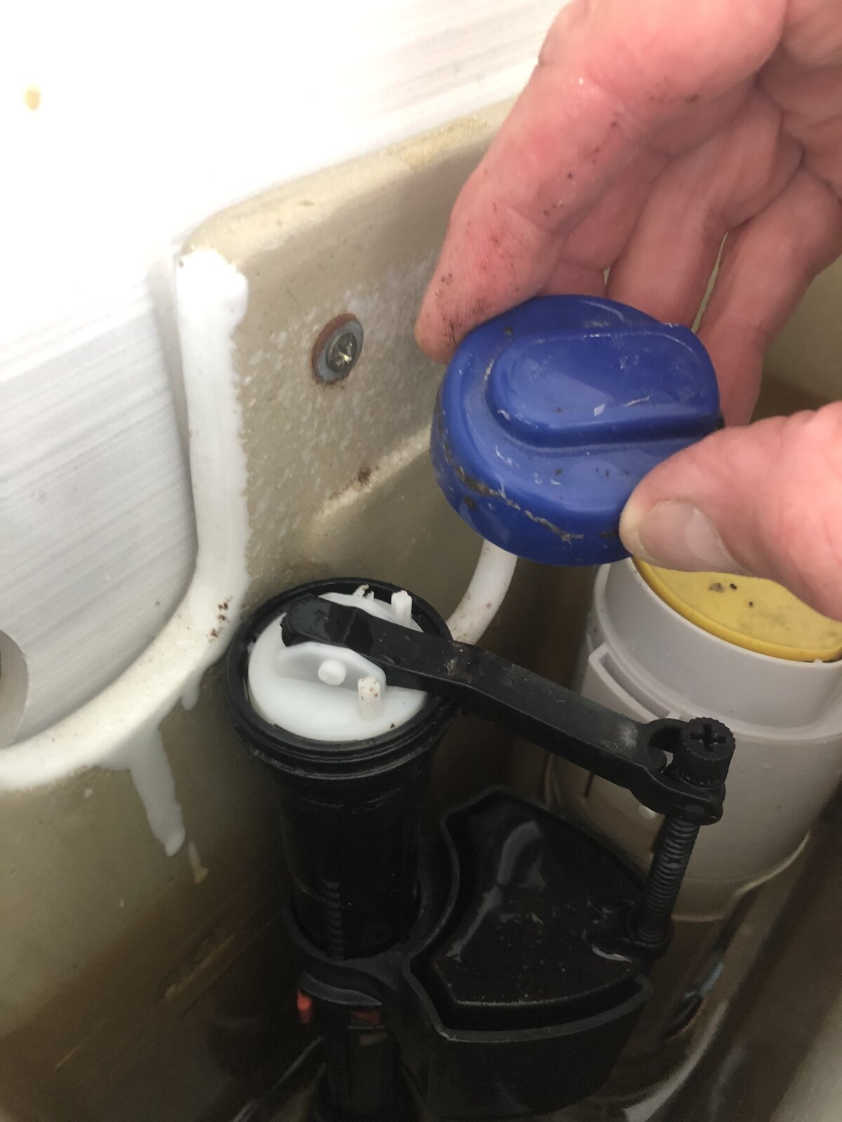

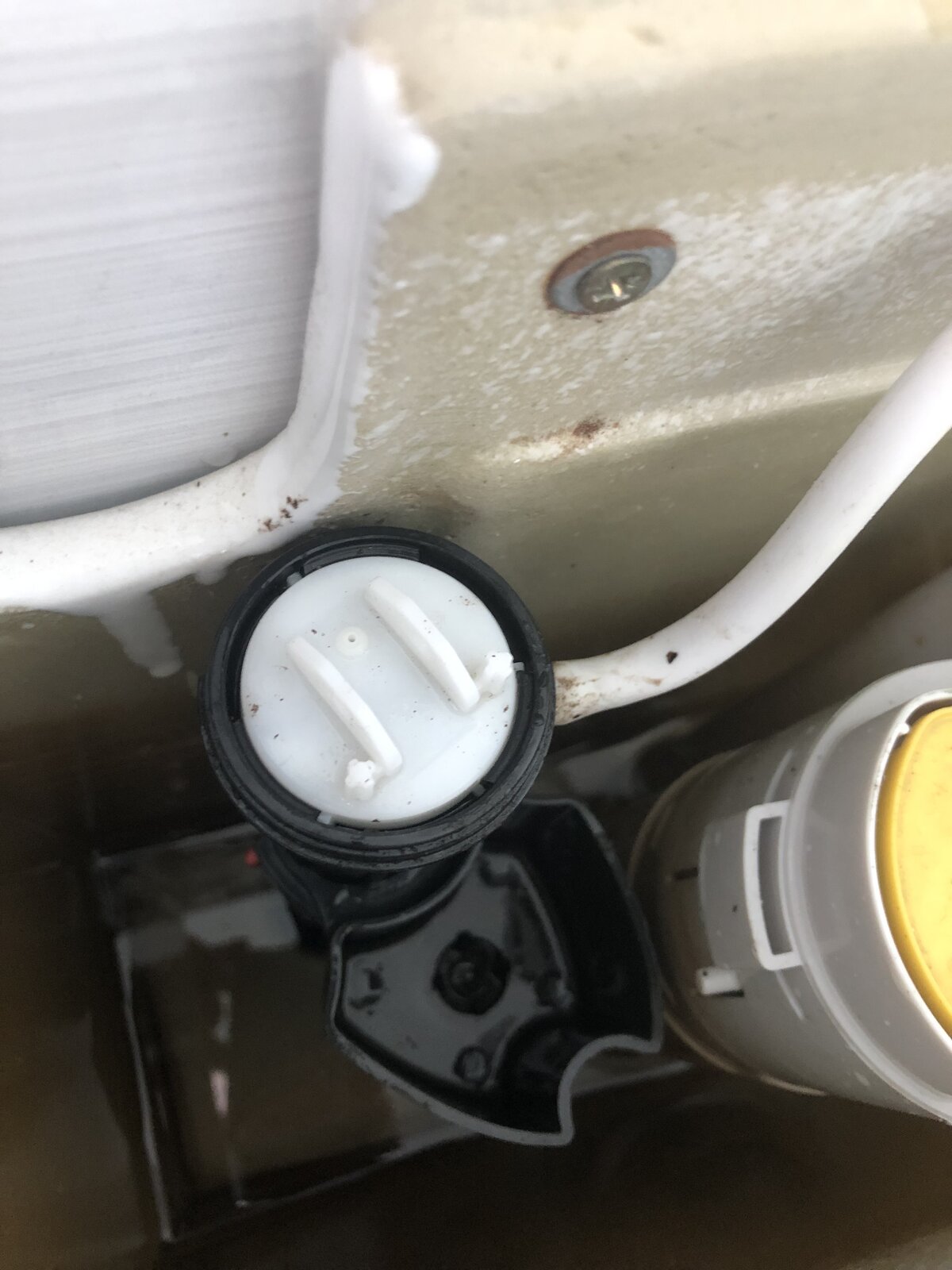

I got there today to check it out. The float wasn’t actually sticking but it was obvious the fill valve wasn’t closing off when holding its lever at what should be closed position.

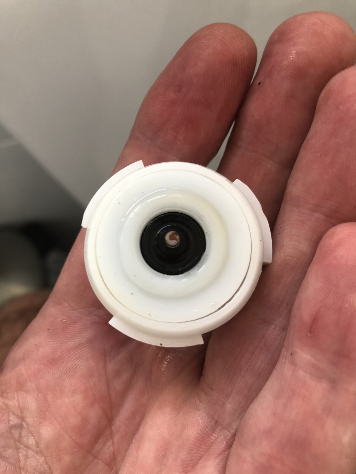

I took the top of the fill valve apart. I manipulated and rinsed what seems to be a diaphragm/washer (pic) but it didn’t look like you could replace the diaphragm/washer because it seems sandwiched inside the white plastic fitting.
It’s now working again so I think the diaphragm/washer was stuck. But I’m thinking the same thing might happen again.
Would it be necessary to replace the fill valve or can this part (containing the diaphragm) be replaced or fixed in any way?
