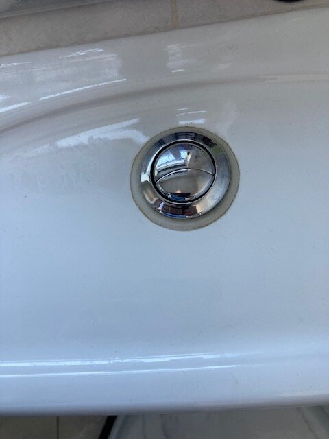

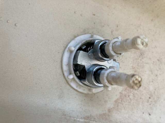

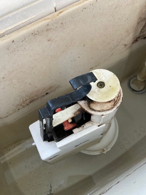

When we moved into this property 12 months ago we quickly noticed that after we flushed the push button toilet cistern, water carried on running into the pan. By fiddling with the plastic screws inside the cistern lid I eliminated the problem, but today it started doing the same thing again. Removing and replacing the cistern lid and spraying the button mechanism with WD40 seems to have cured it for now, but I'd like to know how this thing works so that if necessary, I can fix it for good.
Photos below to show the type of set up we have, and any information as to how to adjust the push button mechanism to prevent this happening again gratefully received.
If at any point I want to replace the entire flush mechanism, does the internal gubbins of the cistern look like the type of thing you can easily remove, or will I have to go through the rigmarole of removing the cistern from the pan and buying a close coupled sealing kit?
TIA

https://www.diynot.com/diy/threads/toilet-wont-stop-flushing-ideal-standard-cistern.582118/ looks to be the same flush mechanism to my eyes.
Most likely is a new washer and clip to replace in the bottom, that seals the water into the cistern and lifts to let water out to flush the pan.
Thanks for that. Is it possible to remove the flush mechanism from the cistern in order to service it/ replace parts without removing the cistern from the pan first? I believe some of those mechanisms have a twist/ release setup.

that is an ideal standard flush valve no longer available unless you want to pay about 150 quid on ebay .
Seals and clip are available for about 4 quid .
It just twists out of position .

Update on the above. Washer and clip arrived yesterday, fitting took about ten minutes. However....after the flush is operated and when the cistern has emptied, there's a loud "clunk" which is presumably the mechanism returning to its pre flush position. I can't recall noticing any such noise in previous operation, so is this a sign that the flush mechanism needs replacing?
I noticed that plumbing retailers who list the existing part ( SV01976/ SV89067, not 100 per cent sure which ) show it as discontinued, and offer an alternative flush mechanism. How straightforward would such a replacement be? Would the cage that the mechanism twists into need to be replaced, and would the push buttons in the cistern lid need altering too?
Incidentally, is the black clip correctly positioned as shown in my photograph above, and what is its function?
no the alternative wont fit into cage you will have to take the cistern off the pan and replace the whole lot and yep button will need replacing to but that should come with new syphon
