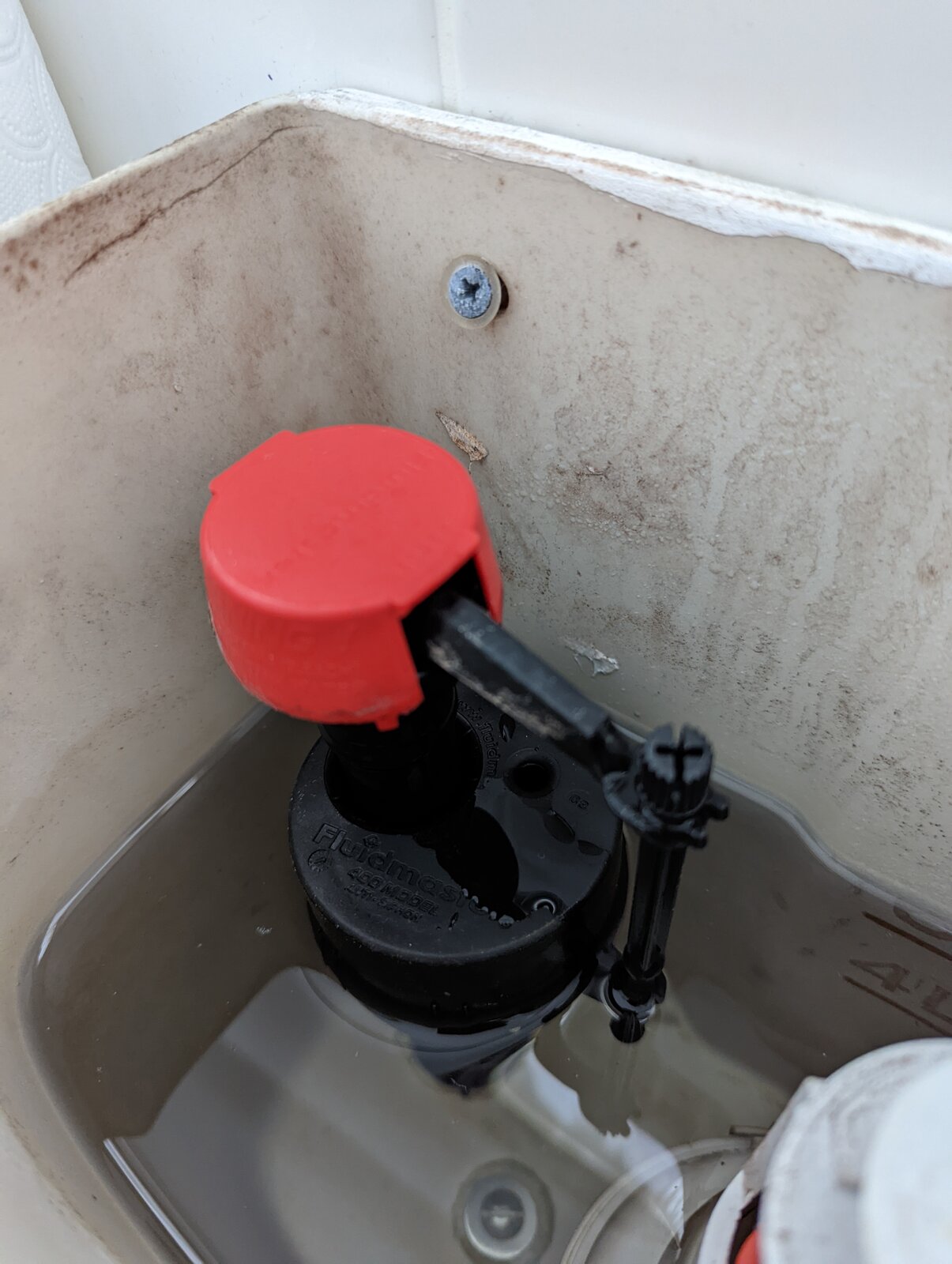

Hi guys, we had our fill valve changed a while ago and replaces with a Fluidmaster which I was told was the bee's knees. Unfortunately although it used to fill slightly every now and then, it's now almost constantly slightly dripping and then refilling about every 30 seconds.
Is this something I can easily adjust?
Try turning the thin plastic screw that connects the valve top to the float....this gives more pressure to keep the valve closed.
If you lift the float up manually, can you stop the flow?
John :)
I've tried turning this screw but it doesn't seem to turn and just jumps

Odd.
They are normally very good. I wonder if it was fitted correctly.
Make sure the float moves freely. They can be installed a bit twisted which stops them lifting properly.
Make sure the arm/screw is full home in its holder.
If it continues, then you could look at the stop seal. Its a small rubber washer which may be faulty, damaged or dirty.
Every DIY store will sell them. They are cheap and very easy to replace.
Check YouTube.
Flush the toilet and watch what happens. You will see how they work or not.
You could also have a leak on the toilet. There isn't any water around the bolts or spigot on the bottom?
This isn't overflowing either i take it?
Best of luck.

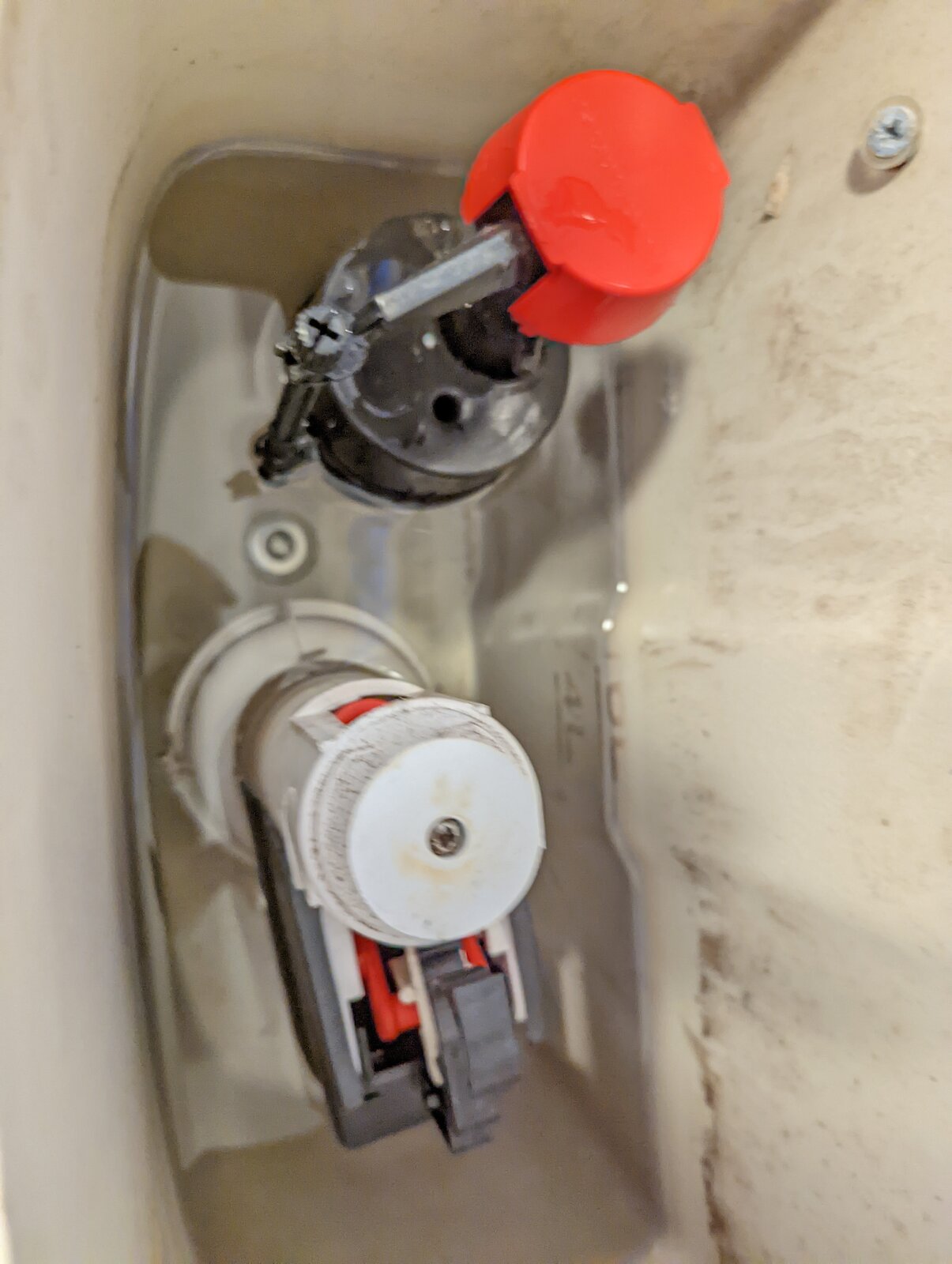

So after getting frustrated I had guy we use come and look at it yesterday. He found the seal on the main point into the cistern wasn't great so he replaced it and then found some silicone had got in there potentially stopping the seal. This was on the main central unit in the picture and not the Fluidmaster bit on the left.
It behaved all night, then this morning it was hourly, now back more frequent again. I've read some posts about the fill rod on the Fluidmaster section shouldn't be below the water level. Would this be the rod with the cross thread on the top in the picture? Ours is quite below the water level.
