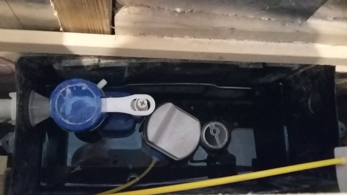

cistern won't stop filling

hi
the cistern when flushed fills up as normal but continues to fill, and overflows via the pipe in the middle of the cistern into the toilet/pan i've taken a picture and would appreciate advice on how to fix it and or identify what type it is as I've tried googling it and there seems so many diff ones- and this is gonna sound so strange- the only way to stop it filling is to turn the wash basin tap (next to it) on for a few seconds and this stops it!

We are gonna need some better photos, preferably showing the bits in the cistern side on with the cistern empty (if possible)
thanks will try again after work but i doubt it as the whole thing is only accessible from the top and i don't want to try an take it out until i know more about it as i'd prob make a hames of putting it back in again
regards
hi
tried again to photo but no chance as i can only look down into it- tried from side but no space and dark

By opening the cold water tap you reduce the pressure on the cistern valve so don`t see how adjusting the water level will accomplish anything.
Looks like a fluidmaster inlet valve. Get a new diaphragm washer for it from b and q for about three quid.
Fill valve could be anything, it would be a lot safer just to change the whole thing as the OP does not sound to confident on diy.
thank you apologies late reply, i think changing whole thing is easier for me, i've just managed today to get the company to send me spec for the actual flushing valve/mechanism, it only took 3 weeks, earlier they just sent me how to fix it to the wall! so i'll have a look at that over the weekend
