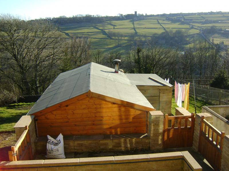

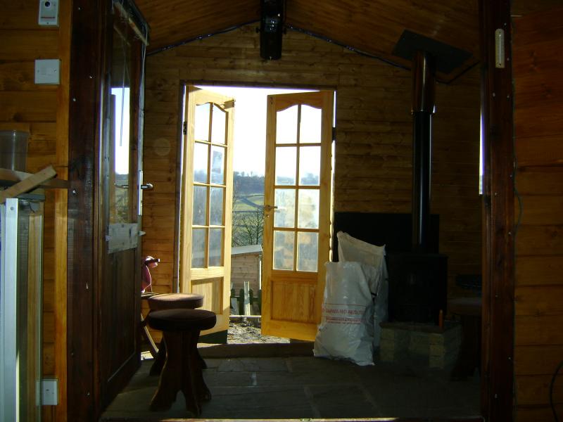

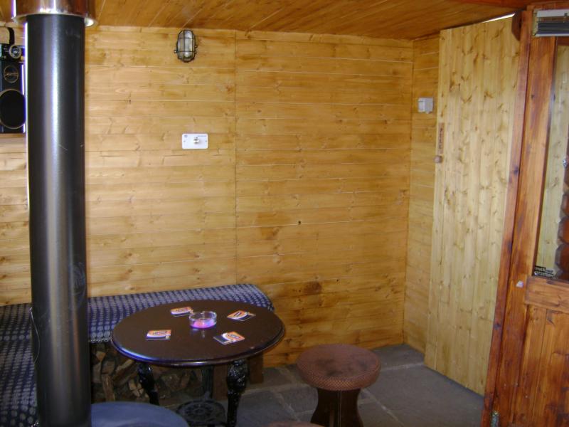

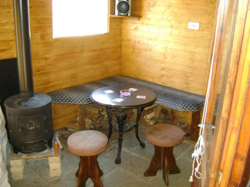

hi,i have a summer house in my garden put up around 2 years ago,just before xmas i decided to build a extension i put up the framework and clad the outside with featheredge board,then sealed inside with plastic sheeting and clad over with t&g cladding quite cheap for the thin stuff from wickes,i had a few issues with nails pulling out as we used a nail gun but after using the good old hammer and nails everything seems fine,i have also installed a wood burner so can get very warm when that is on and cold when it is not,but the finished product looks good and have many happy and drunken weekends in there. :D
Hi,I have a summer house in my garden put up around 2 years ago.
Just before Xmas I decided to build a extension i put up the framework and clad the outside with featheredge board,then sealed inside with plastic sheeting and clad over with t&g cladding quite cheap for the thin stuff from wickes.
I had a few issues with nails pulling out as we used a nail gun but after using the good old hammer and nails everything seems fine.
I have also installed a wood burner so can get very warm when that is on and cold when it is not,but the finished product looks good and have many happy and drunken weekends in there. :D

Yes thats exactly how i did it,i have a roll of sheet i got from work but any kind would do taupaling something like that,think you may be able to buy stuff just for this purpouse,maybe quite expensive though,forgot to say i insulated it all as well so keeps nice and warm when the fire is on.
fire i got from ebay £182 with delivery they do the same ones at machine mart but are £200,black pipe is a standard flue pipe which goes into a double walled insulated pipe which is needed as going through a combustable roof,you also need some fire board for the roof as the pipe has to be well away from the cladding,its quite expensive around £40 for a sheet but if you go to your local timber yard they usually have broken sections which they will sell you cheap,
if you do decide to clad inside i would leave it a couple of weeks before you stain as if there is any shrinkage it will show where you havent stained it,but as long as you get plenty of nails in it shold be ok,if you need any further advise as to how i did things just get in touch always happy to help where i can.

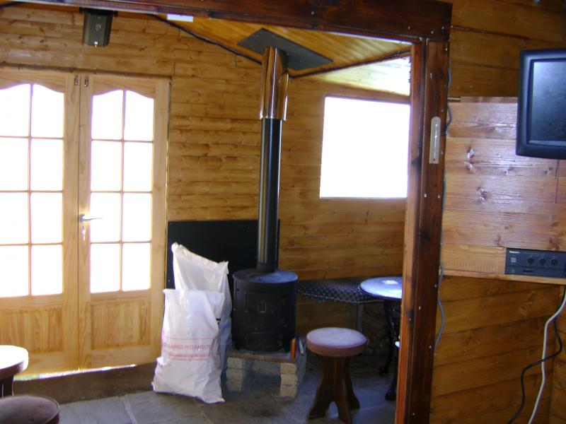

hi,dwatts what i did was to offer the flue pipe up to the roof and marked it out,i dont know what sort of pipe you are using (single or double wall) but it should tell you how far away from combustable surfaces it sould be,if it is a double wall it is around 50mm.
Cut a rough hole out and put the pipe up through the roof,then cut 2 pieces out of the fire board one for the top and one for the bottom of the roof,it may be a bit tricky cutting out the hole in the fire board if you have a sloping roof as it wont be round,more like an egg shape,easiest way is to do it in 2 pieces.
you can just screw straight on to the roof and felt over the one on the top you may need to put a few batterns in to fix to,pack round the flue pipe with insulation.
If the cut out has gaps round dont worry too much fill with high temperature silicone and then spray with a high temperature paint and will look quite good.
You can also pick up a silicone flashing for the roof quite cheep on ebay

hi glad to hear everything went ok would love to see some pictures,single flue is 1 meter and double is 1 meter it rises above the roof pitch so thats all i was bothered about, no fixings the fire board is a tight fit which holds it in place,there is also a flexable silicone flashing on the roof witch also holds it fire cement round the join with the stove,gets very windy by me and had no problems with it
