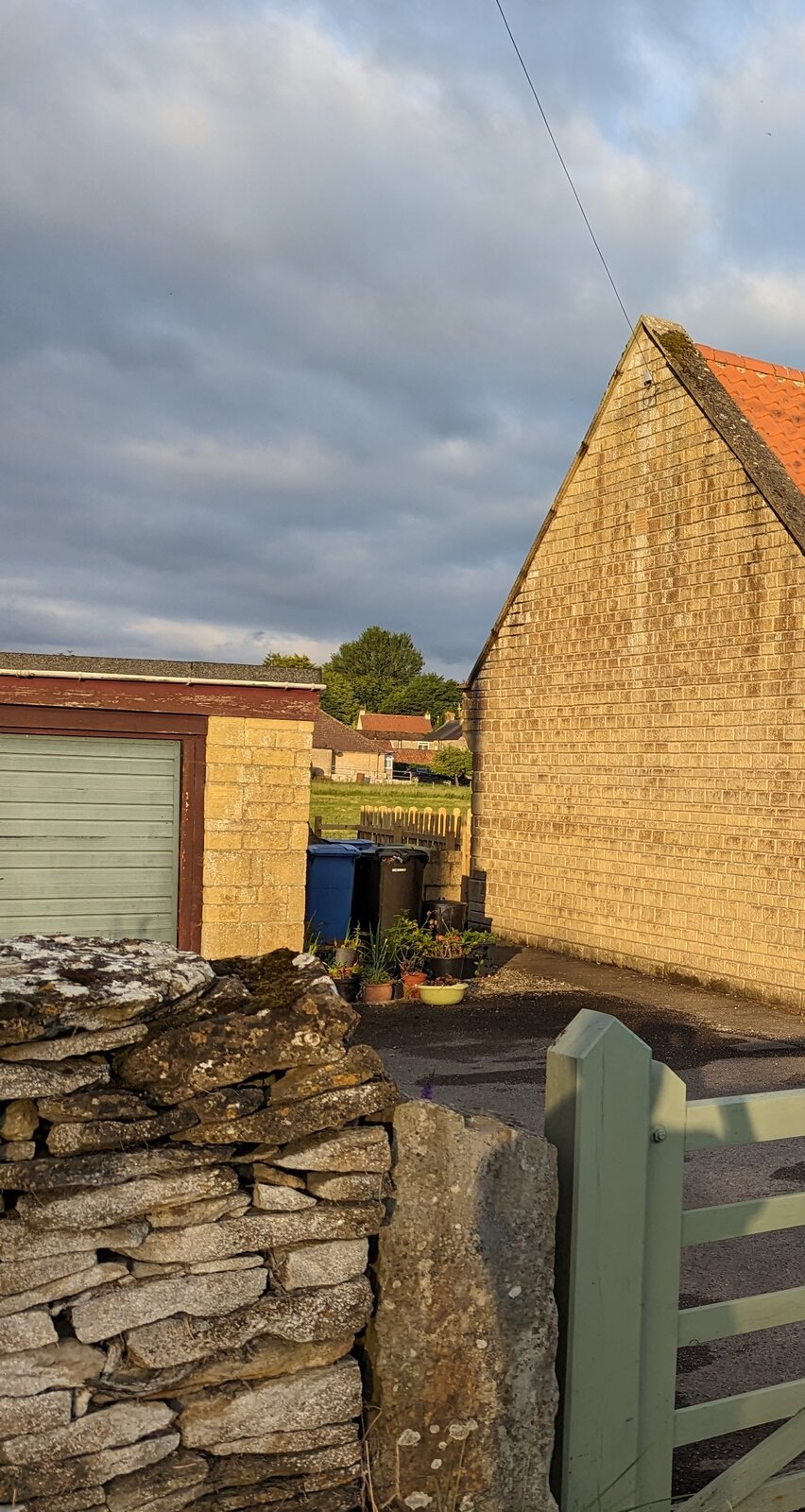

Can anyone tell me the best way to clean my gable end wall. the bungalow is made of bradstone and as you will see the water has run betweeen the coping stone and streaked the wall. Coping stones will be pointed but i really am at a loss what is the best way to clean the wall.Thanks
Probably an algae cleaner such as Wet n Forget or Patio Clear. If it's just just algae /mould.
Or a detergent/degreaser if its dirt.
Of a combination of both.
Light hose if possible, not jet wash.
