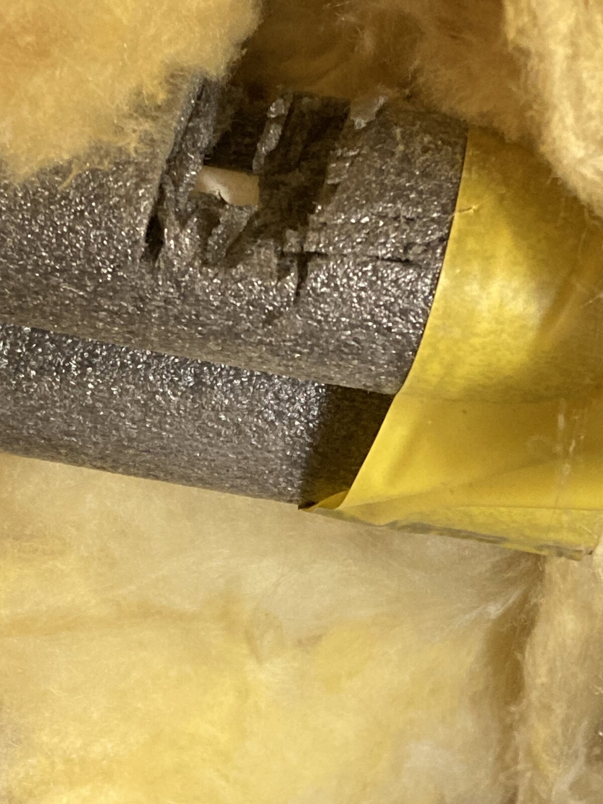

I will soon be replacing some radiators and then plan to run a cleaner like X400 through the system
I’ve just checked, and it looks like my Builder chose to use some plastic pipe for the long run to the radiators in our extension rather than copper (in the ceiling, not down to the actual radiator, of course)
I’m assuming therefore, that there are some plastic to copper push fit connections in the roof somewhere
Sentinel X 400 states it’s okay for plastic so am I safe to assume that the push fit connections won’t be caused any issue running it through the system ?
TIA
Lot of people use plastic pipework now due to ease of installation. Especially new build where copper pipe theft can occur when site unmanned. Unless you specify copper pipework at the build stage. Prefer copper myself due to longevity . Mice and rodents have been known to chew on plastic, especially out in the sticks. Sentinel x400 should be fine. Might be an idea to see if your pipes are clipped properly and insulated. I have worked on heating systems with a mixture of copper and plastic pipe, and the plastic pipes have blocked due to old radiators deteriorating and sludge in the system. Had to replace the plastic with copper to solve the problem.
Thanks for the comprehensive reply, @Andy165
I managed to pull a spotlight down when I understood the route the pipes would take and yes they are lagged, but as they appear to cross timbers, I don’t think they look to be clipped from what I can see which is limited

It was 10 years ago, but I’m still a little bit annoyed that the builder didn’t ask as like you. I’ve preferred copper all the way wasn’t Hard up for 30 quid of copper
Fire away, no issue with using cleaner and plastic. Just remember to flush it clear really well and then use a good inhibitor.
