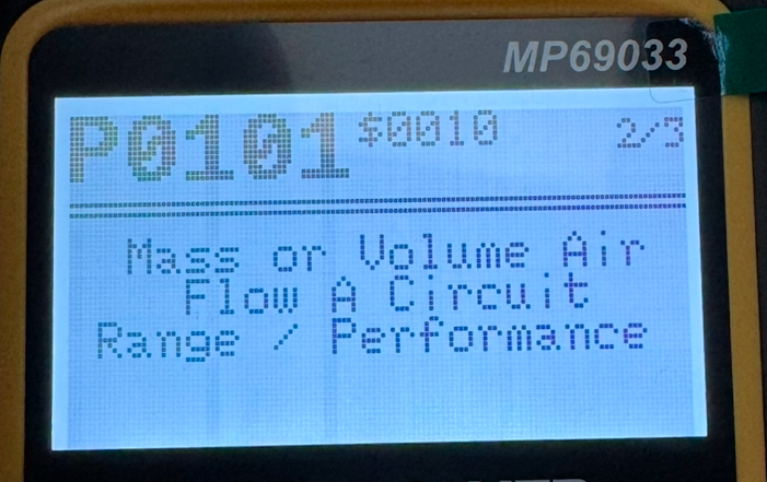

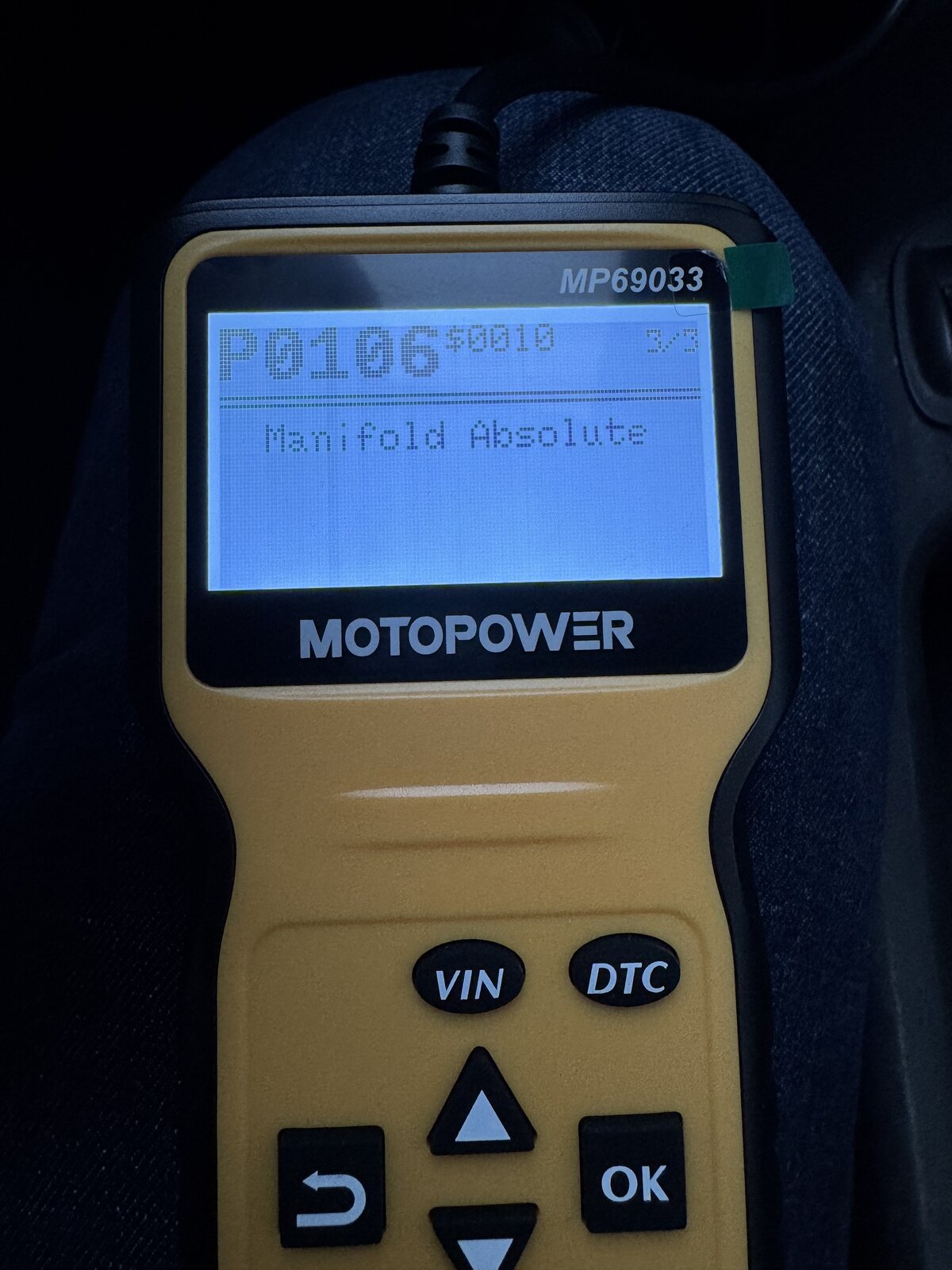

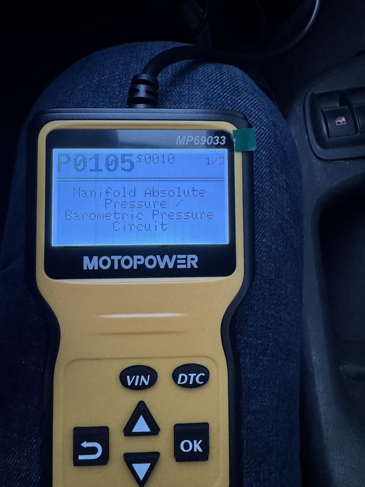

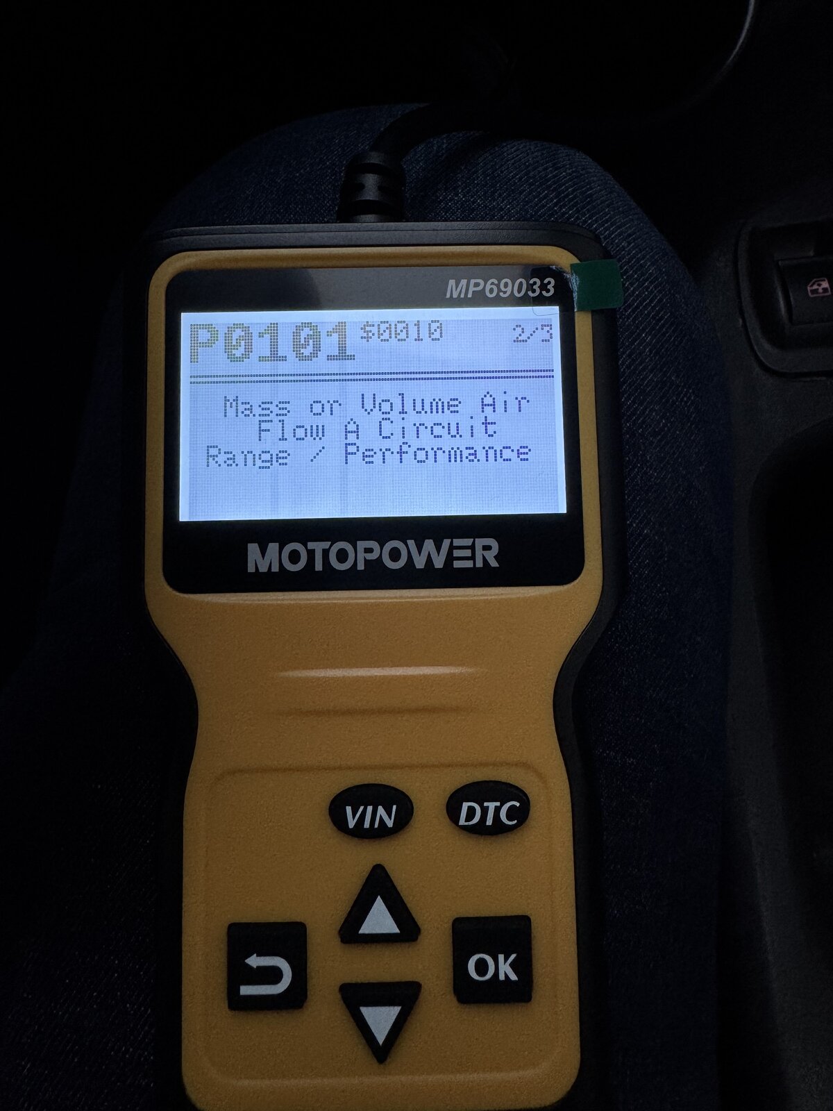

Ran the scanner and the codes P0101, P0105, P0106 came up.
Bought a new MAP sensor and thought it was okay, but then the car lost power and I had to keep restarting. I’ve never experienced limp mode before, but it felt like that was happening.

Hello! Yes, I did clear the codes and they did reappear. The P0101 code mentioned air mass - see attached pic. Any advice on how to investigate? There’s a serious lack of manuals or online mechanical info for the Mk 1 1.4 petrol Doblo.

Your P101 fault mentions the Manifold Air Flow sensor issue - A MAF issue.
