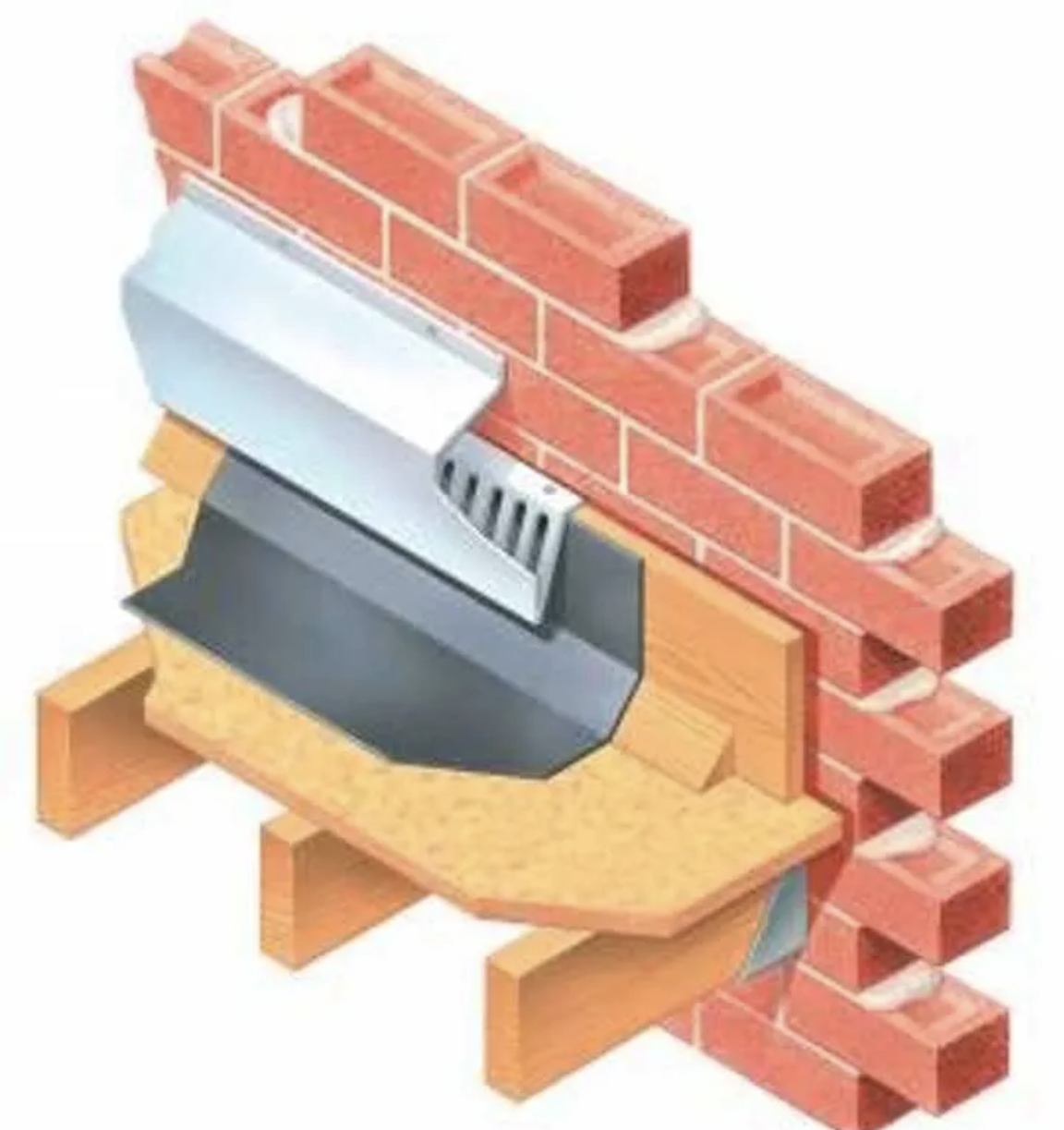

Hi guys,
we have to redo our failed flat roof. Leaking from outside and also sweating like hell due to very poor ventilation.
We cant convert it to a warm roof.
We have existing EWI on abutment walls to the flat roof.
How do we detail the single ply membrane of the new flat roof to the EWI (Assuming a certain amount of ewi has to be stripped back to masonry) and maintain the minimum 50mm of space between OSB and insulation and allow venting on the abutment wall?
Thanks a mill
Vertical upstand is presumably battened off the wall for airflow
Then I guess the render needs hacking back further up, to allow all that to be flashed over…
Okay thanks for this. Does the ewi base require any further fixing when a certain amount of it has been removed?
Potentially, depends how it was fixed? And might need some kind of trim over where it’s cut? Pics will help. Basically needs to be finished as if the EWI was fitted after this detail rather than before
