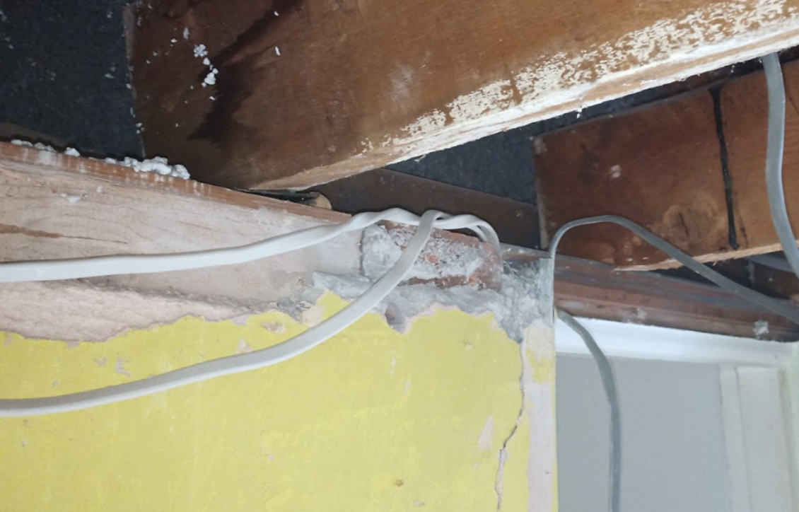

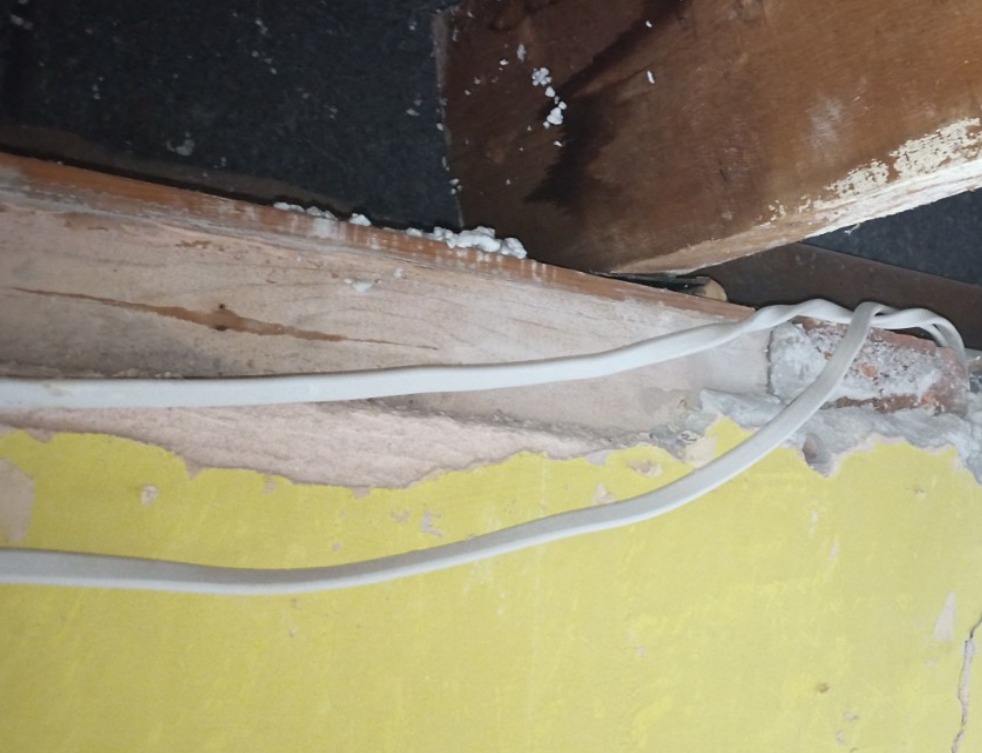

Couldn't find the original post, but someone on a fastening forum recommends this method.
Block existing ventilation throughout
Take out any insulation that exists below the deck, keeping it here will create interstitial condensation
Fix PiR insulation over the felt. The felt if in good condition will act as VCL. 120mm will meet your regs
Fit waterproof membrane eg single y membrane
Plasterboard and skim to underside of joists
What does the first point (Block existing ventilation throughout) involve?
I'm sorry to be a PIA, but I don't know much about roofing, but want to try and get enough knowledge so I get the best possible outcome.
I've been looking for diagrams of this, but can't find any.you need to make sure the insulation is returned downwards at fascia and brickwork to remove any thermal bridging.
