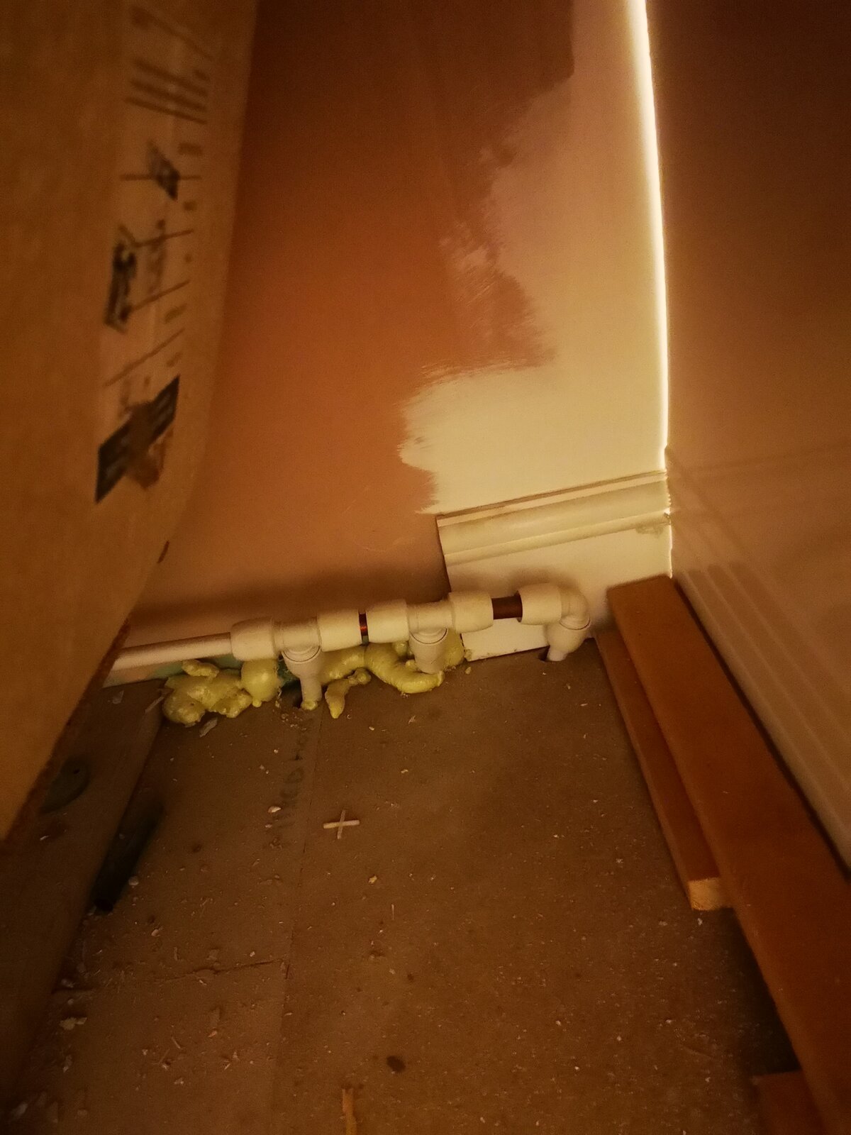

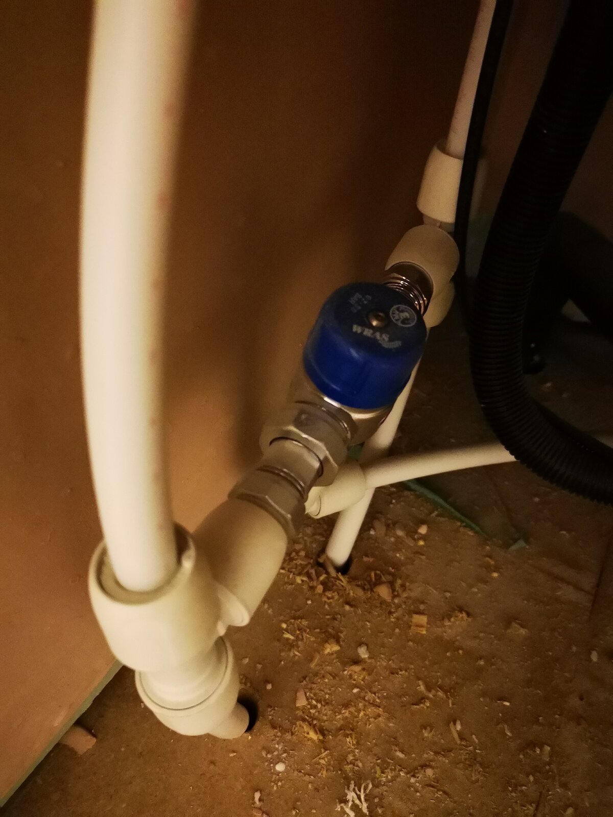

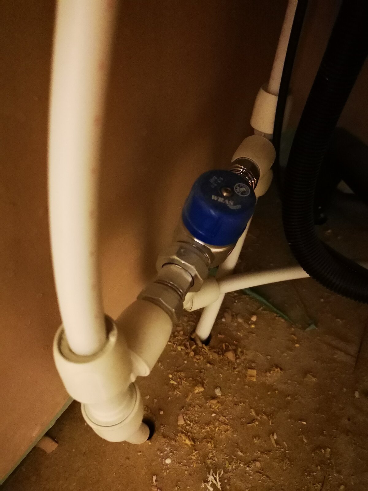

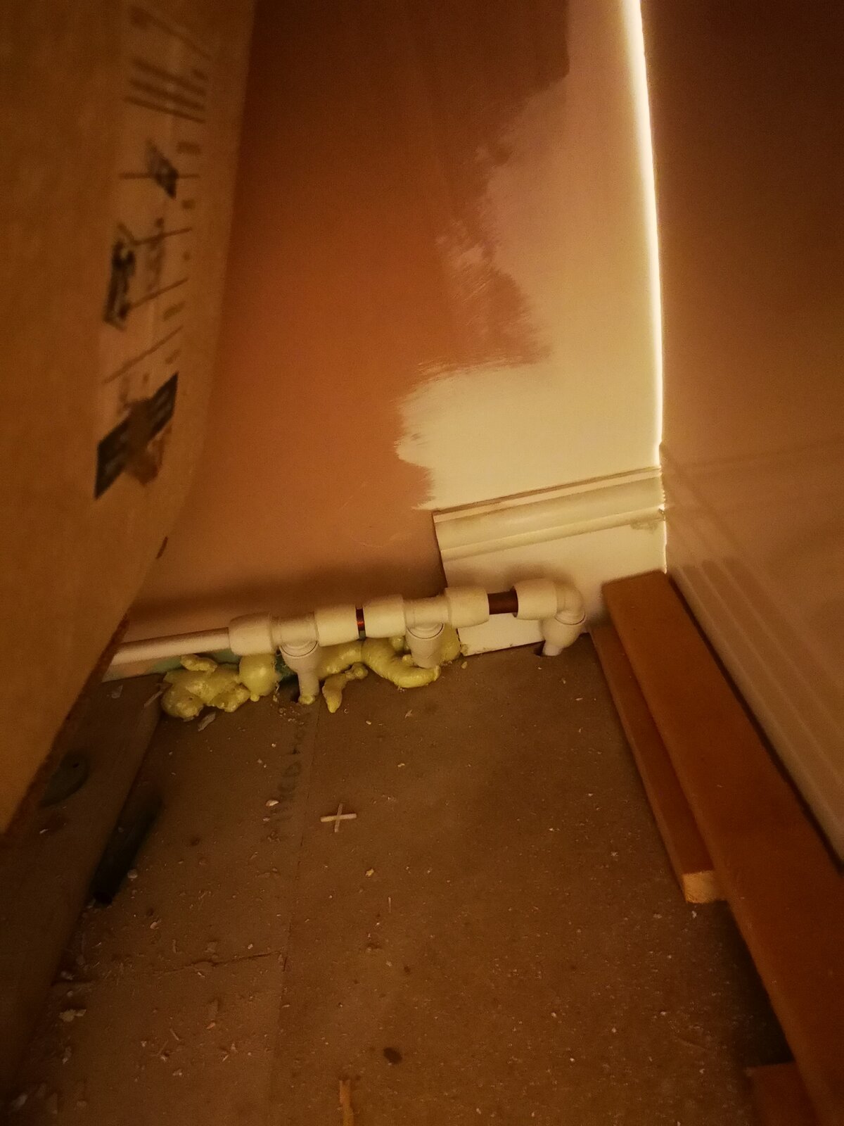

Just took bath panel off and maybe the mystery is solved.
See pic.
There's something in between the hot and cold feed on the bath - and that then goes to a bank at bottom of Bath with 3 feeds.
What is it ‍♂️

Thermostatic Mixing Valve (TMV), installed due to building regulations to prevent scalding.
But as it happens... This will not be affecting the shower will it? It feeds 3 outlets which will be the 3 sinks I have observed to be passing.
So the cold/hot shower can now only be the boiler.
I had B. Gas out for that. They changed the flow restrictor and housing - but didn't change anything. They then blamed poor pressure. I'm only getting 6 litres a min through the hot water tap - yet 9/10 in the cold. I contacted Worcester - who said it could be a mixer tap passing (hence me going down this path) or the plate heat exchanger blocking.
Replace that blending valve ( TMV),it's goosed.

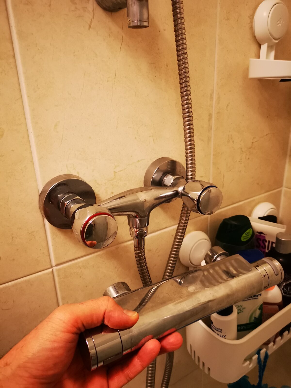

And show us a pic of the shower valve
OK.
The one in my hand was the original thermostatic shower bar. I replaced the cartridge in that, but didn't change anything so fitted the manual mixer as seen attached.
Are you sure the hot to the shower isn't from the blending valve ?
Was the shower pipework part of the original plumbing installation ?
