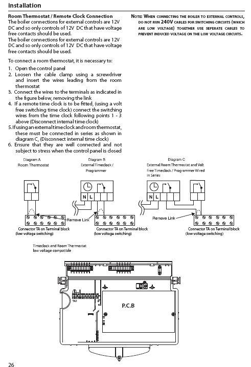

My landlord has fitted a new boiler, Ariston E-Combi 30, with an archaic mechanical timer. In the 21st century I at least want a heating advance button, and 7-day timer would be nice too, so I'm trying to fit a digital replacement.
The mechanical timer is a Grasslin FM/1 QRTUZH. Looking at Grasslin's range of similar timers I guessed the FMD 120 would do the job. But it's not working. Before connecting I can set the time and the programs thanks to the internal battery, and that's all I can do afterwards. It won't show me if it thinks the boiler is on, and the boiler does not come on, even when pressing the advance button. Apparently some features on the display only work with power connected so it seems like it's not getting power.
Alarmingly, Grasslin's datasheet from their website shows the FMD120 as taking DC current on pins 1 and 2, same as the diagram on the back of the mechanical timer, giving me confidence I was buying the right thing, but on the digital timer itself it says 230V AC!

I don't think you can assume from the datasheet that + and - mean DC - the datasheet clearly states the thing works of 240V.
The timer may have been modified for use with the boiler but the case / model number not updated. A google suggests the standard model of that mechanical timer also works on 240V AC.
Can you test the supply to the timer from the boiler and confirm it's a 3V DC supply?
To use the replacement timer you have bought you need to find the boiler's permanent 240V AC supply and wire it to the supply pins of the timer. Make sure 240V cannot accidentally connect back to the boiler 3V output. Then use the isolated switching contacts to switch the boiler.

You can wire any controller you like into the Ariston boiler, provided it has volt free contacts. The 240V AC supply for the timer supply, and the control terminals, are on the Ariston PCB - extract from their manual. Removing the link disables the internal timer, which could be reinstated at any time.
Manual at
ARISTON
Page 34:
