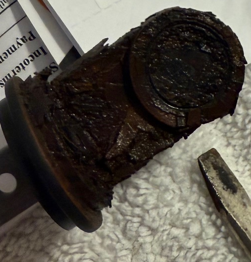

Seemed to be slowly getting worse after all the previous work. I put in a new diverter valve paddle and no improvement although the old one was really scaled.
