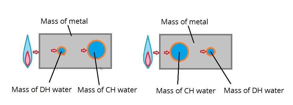

Assume that the set temperature for hot water ( DHW ) from the boiler is different to the set temperature for the central heating water ( CH ).
How quickly does the thermal mass of the heat exchanger cool from the higher of these temperatures to the lower temperature ?
If the CH set temperature is higher than the DHW set temperature then when DHW is demanded while CH is demanded then the first of the DHW will be as hot as the CH set temperature ( the hot slug ) and will remain hotter than the DHW set temperature until the thermal mass of the of the heat exchanger has cooled down to the DHW set temperature.
What happens to the burner while the heat exchanger is required to cool down to the DHW set temperature ?
When considering the thermal mass of the heat exchanger for the duration of the hot slug the thermal mass of water in the CH coil has to be included
Out of interest what is the arrangement of the two coils in the Intergas heat exchanger. Videos and other images seem to conflict as to which coil is closest to the flame. Has there been a change in the basic design ?
Picture 2
