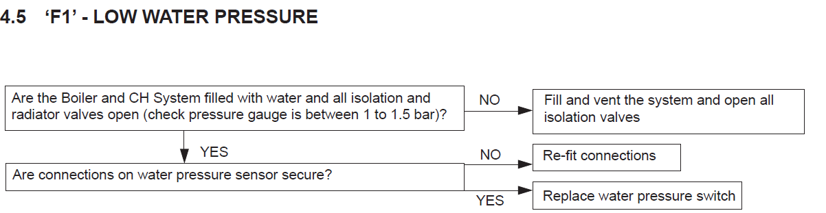

Its unusual not to have a low pressure boiler trip with a sealed system, what make/model is your boiler?.
It's an Ideal logic 35. The boiler does cut out with an L1 or 2 ( I think )code. But when you check the pressure guage to see why it has gone off the pressure is always zero.
It doesn't state what the actual low pressure setting is but does say to keep the pressure between 1.0 to 1.5bar so would think that the lockout shoud be ~ 0.5bar.
When you had the leak, L1 at a dT of > 30C would trip the boiler as well but IMO, FI should have tripped it well before it reached the 30C dT.
This is a lnk to the Boiler MIs
Sorry it probably was F1, my memory is not what it was and the incident was happening a few months agp. It was caused by a leaking diverter valve FYI.
