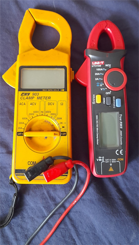

Also my thoughts, I wonder if the extra current when running central heating could highlight a neutral to earth problem, I have a clamp on now which can measure the leakage, Clamp-meter-small.jpg seen to right, but for many years only had the one to left, which would measure in 0.01 amp increments, the new one to right measures in 0.001 amp increments, and also DC amps, and at nearly 4 times the price one can see why boiler engineers may not have the instrument in their test kit.
I know the total leakage for my house is around 20 mA, as this is split between 14 RCBO's it is not a problem, but many homes only split between 2 RCD's so although the RCD is rated at 30 mA it is designed to trip some where between 15 mA and 30 mA, so with a 9 mA leakage which is the limit before we should split into more circuits, in real terms looking at a 6 mA leeway.
Before getting my new meter I could not measure 6 mA. And I would suspect many electricians don't actually test the mA leakage, yes they check the insulation resistance, but that is tested with DC, so any leakage due to capacitive or inductive leaking will not show up.
