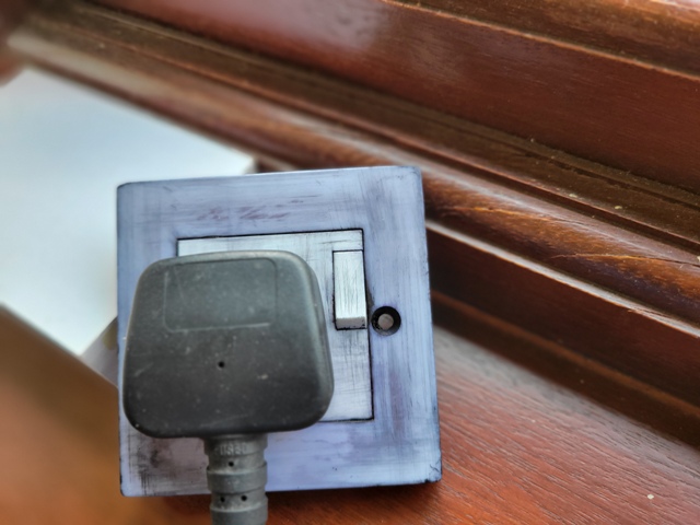

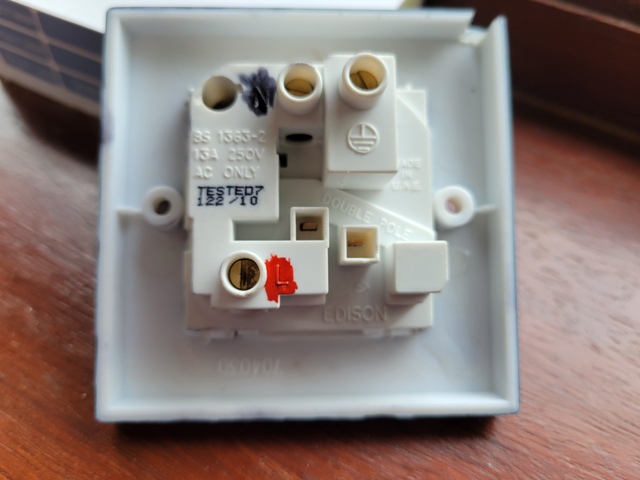

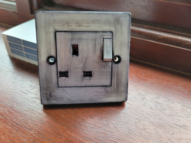

This thread stirred something in my memory and got me searching in my box of "might be useful, one day!!!!)
this euromodules sized socket with switch came from a twin socket that I picked up at a car boot years ago. I think it may have been intended for use in a caravan. Yhe writing on the back says "made in UAE"
edit:: the range aapears to be Edison Elite and is made in the UAE as i said
its looking crap as i tried painting it as I wanted a black faceplate!
it is euromodule size but doesnt clip in like normal euromodules (the back plate/fascia was different to a standard euro faceplate) so i glued it in.
if the op thinks he can get it out of the old faceplate without breaking it he is welcome to have it for the postage cost

Good find @Sureitsoff? :giggle:. I'll pass on the offer however as you can be certain I'd wreck it my with my ham-fistedness :LOL:. Delicateness and me just don't go together unfortunately. :rolleyes: Thanks anyway.
