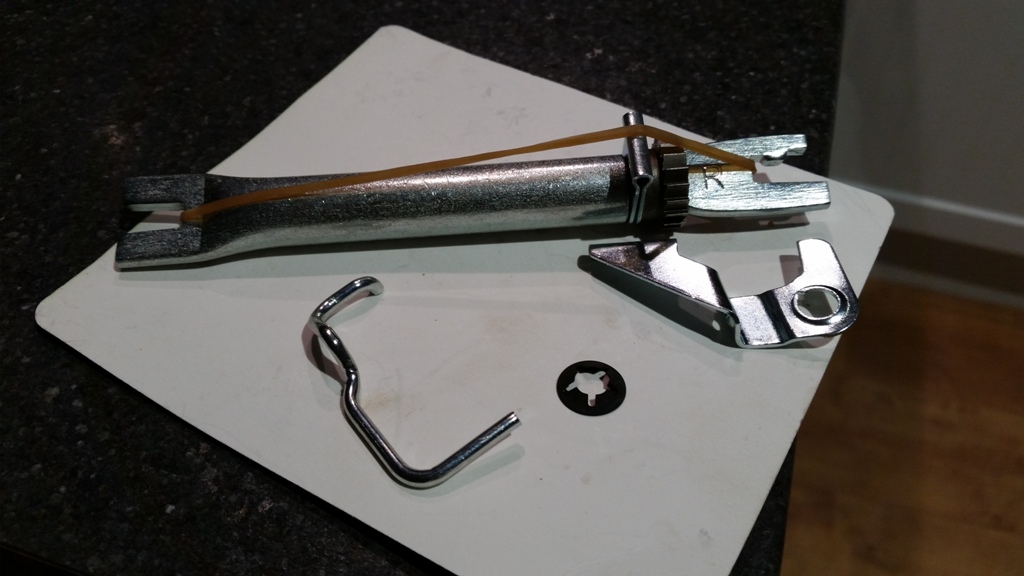

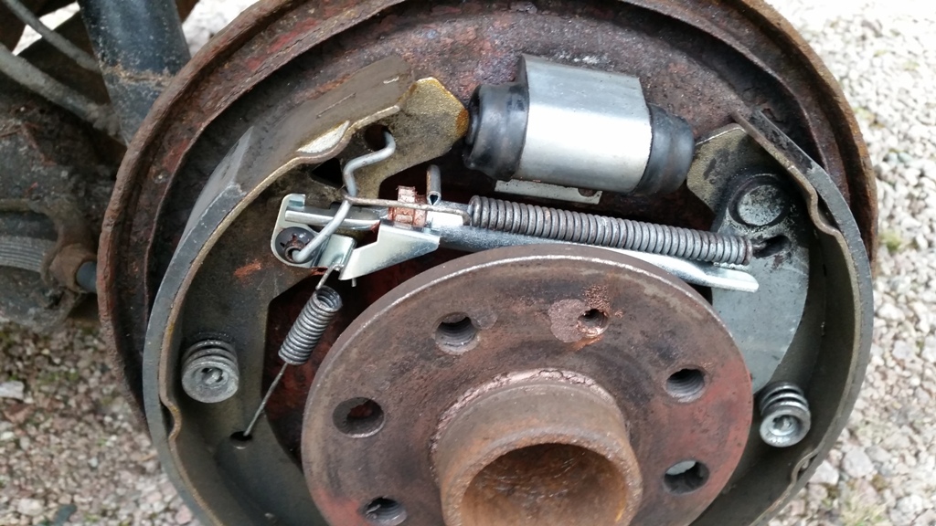

Done the front brakes fine, all went well and they're good. The self adjusting kit arrived yesterday so this afternoon got the N/S wheel and drum off with no wrangling and found this....
On closer inspection I realised that the adjuster pivot is lacking one of those spring washers you push on that cannot come off and holds the adjuster arm tight to the shoe? Is this correct?
This to some may seem trivial but it's in the new kit and without it allows lateral play from the shoe, enough to slip past the ratchet wheel on the adjuster??

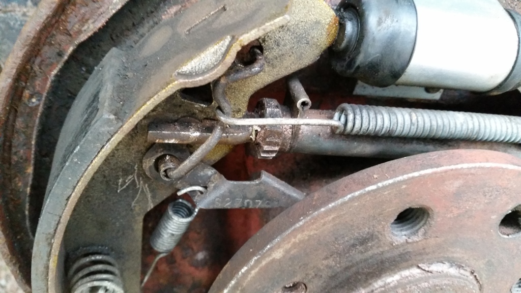

Which brings me to the top arrow...until it's daylight and I dismantle it all is it possible the adjuster arm is on back to front? Ie is the longer smooth side facing out? I'm assuming the side of the adjuster with the "tooth" should be there to prevent the adjuster arm from dropping down?(or could it just be worn??)
Any advice from anyone is much appreciated....
The new O/S arm- with the currently missing sprung washer/retainer and I've lined up the adjuster with the strut to show how it may be wrongly assembled?
Finally the last photo showing how I think the adjuster should be in relation to the strut, with the "tooth" stopping the adjuster from being pulled down past the toothed wheel?? Is this correct?? I'm getting more confused !!!!
First, can I ask you to open up the other side wheel - without dismantling anything - to check what you find against that? It will, in fact, be a mirror image but it will help.
First pic......the lever that pulls the toothed wheel has slipped down and isn't doing anything. Its meant to be kept in place by that forked end of the main adjuster - I suspect this is the wrong way round....if you study the thing, its not just a fork that sits either side of the shoe, one side has a bump to hold the sprung lever in place. This can be seen in your lower pic.
I cant comment on the missing sprung washer but I cant see how it would help a great deal - other than maybe holding it tight against the shoe. See if there's one on the other side!
Anyway, these entire adjusting systems are mediocre at best, and always can be adjusted manually by three clicks or so to get the shoes nearer the drum. This is especially relevant if the drums are worn!

Well well well..... The other side was identical

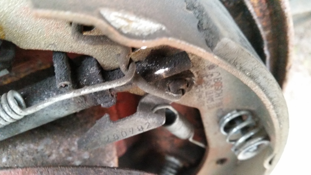

I decided at this point to use a file to mark the outer strut at the adjuster end so that when dismantled there'd be no dispute over whether the arm was the correct way against the shoe..... The remaining photos show the marks on the strut, the new sprung washer and one on how the set up should look. I sanded the shoes to remove glaze and sanded the inner drums and used disc cleaner. Got them adjusted fine and the handbrake didn't need touched it's holding on a steep incline at 4 clicks and both wheels turn freely though one seems a bit out of true(oval). The postie turned up with the Haynes manual I bought just as I headed out to test it...typical....
This last photo shows that the garage have installed the adjuster struts wrongly, and without a spring washer on the pivot- not that that would have mattered in this case....Now I've got to confront them as I've done all the advisories on the pre-mot, and it's going back to them for MOT, but this is just simply expensive yet sh*t workmanship....!!!
Something else about the work they did....must have had a job getting the drums off both sides. In the top two photos of this post you can see where the screwdrivers have bent the thin inner rim around the backplate that sits in the corresponding recess on the drum to keep weather out. I had to go around with long nosed pliers straightening out the edge as it was rubbing on the drum...
You've done an excellent job there - well done! I guess you didn't remove the central hub, so it must have been awkward getting in there.
If the drums have been on for ages they can be the devil to remove - belting them with a hammer usually does it as you pull but sometimes leverage is necessary, hence the bent backplates.
I think I mentioned before - two or three manual clicks on the adjusters will give you a tighter handbrake. Manufacturers such as Renault use a much finer toothed wheel which has a similar effect.
