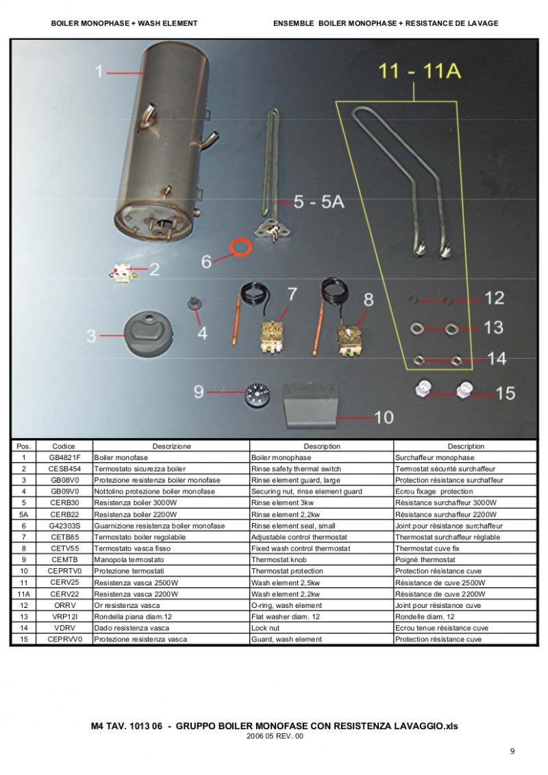

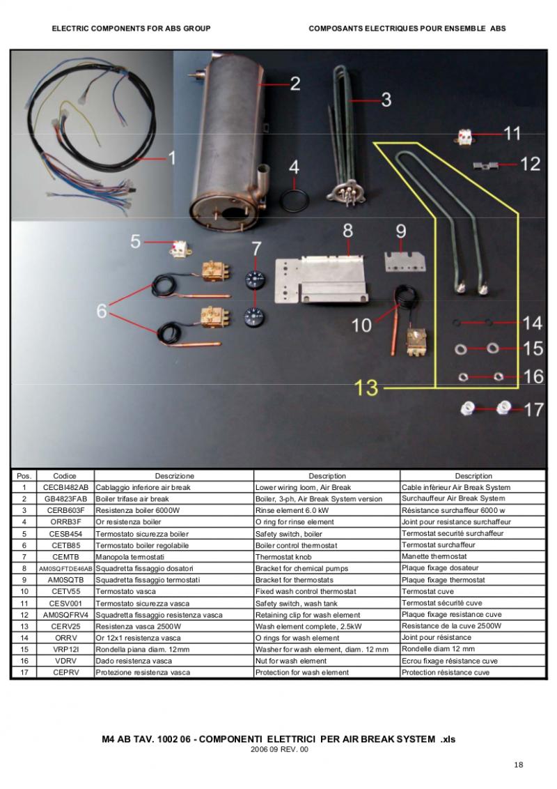

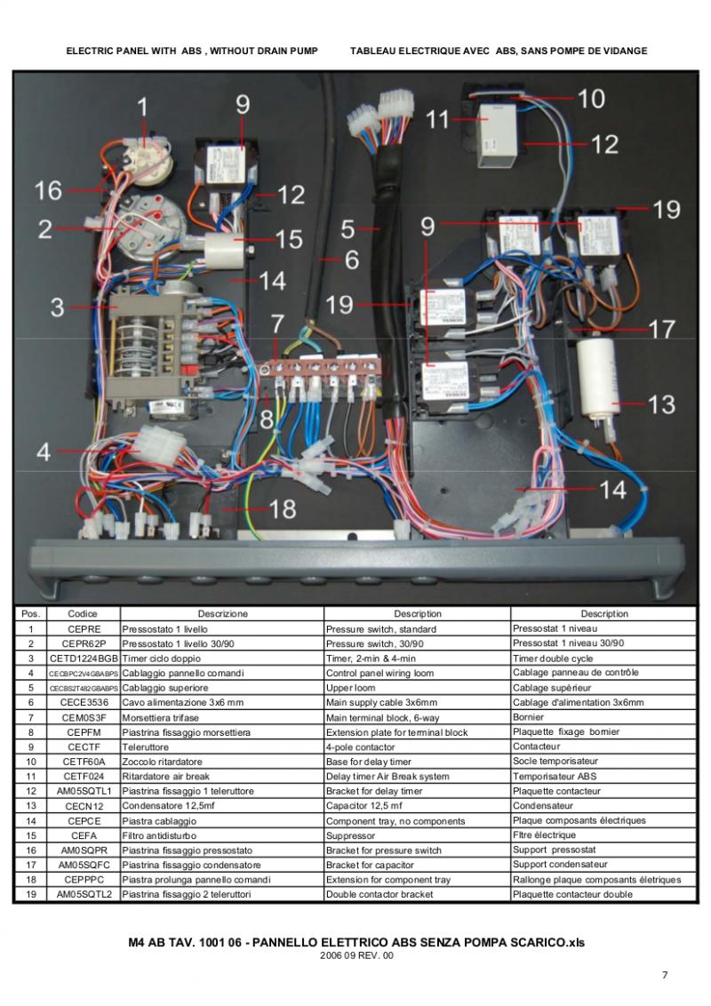

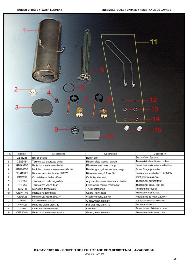

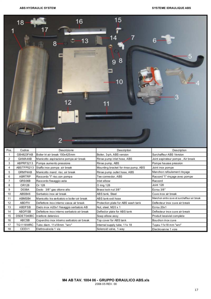

I would have liked to have shown you the full manual, absolute nightmare, but it was 6.5 Mbytes and the upload limit is 6. I have selected a very few pages that may answer the 'have you got' questions. The model number again is CK50/ABS/DD, the ABS refers to Air Break System, the DD means direct drain (no pump) and the CK50 means a big b----r apparently.
ABS model specific components
Image showing 6kW heater as 3 phase model
Single phase boiler element which would have made sense but not fitted on the single phase ABS model
This image shows single phase flexible 6mm2 x 3 input cable
This image shows the 3 loops boiler element
