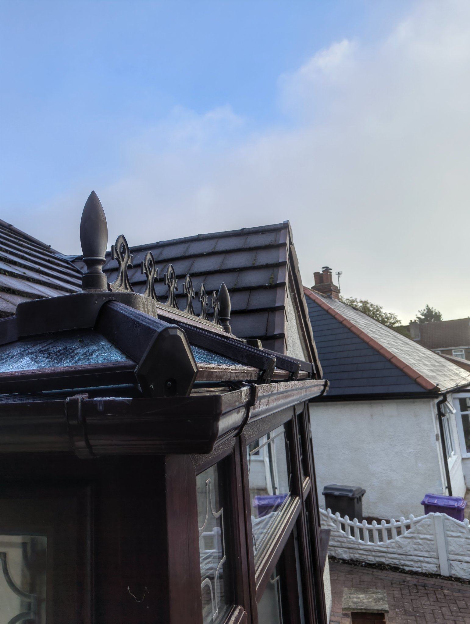

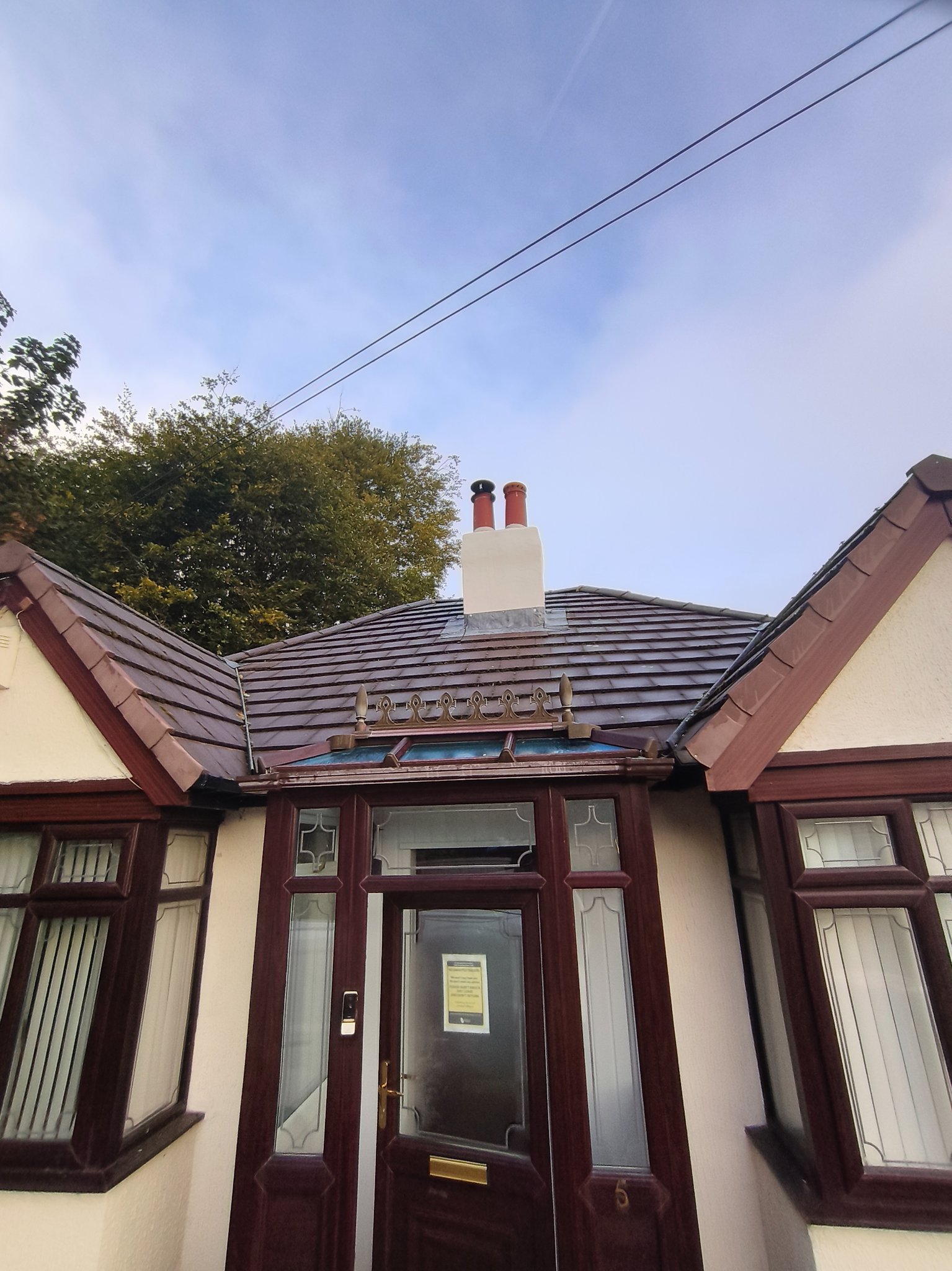

Is this the type?

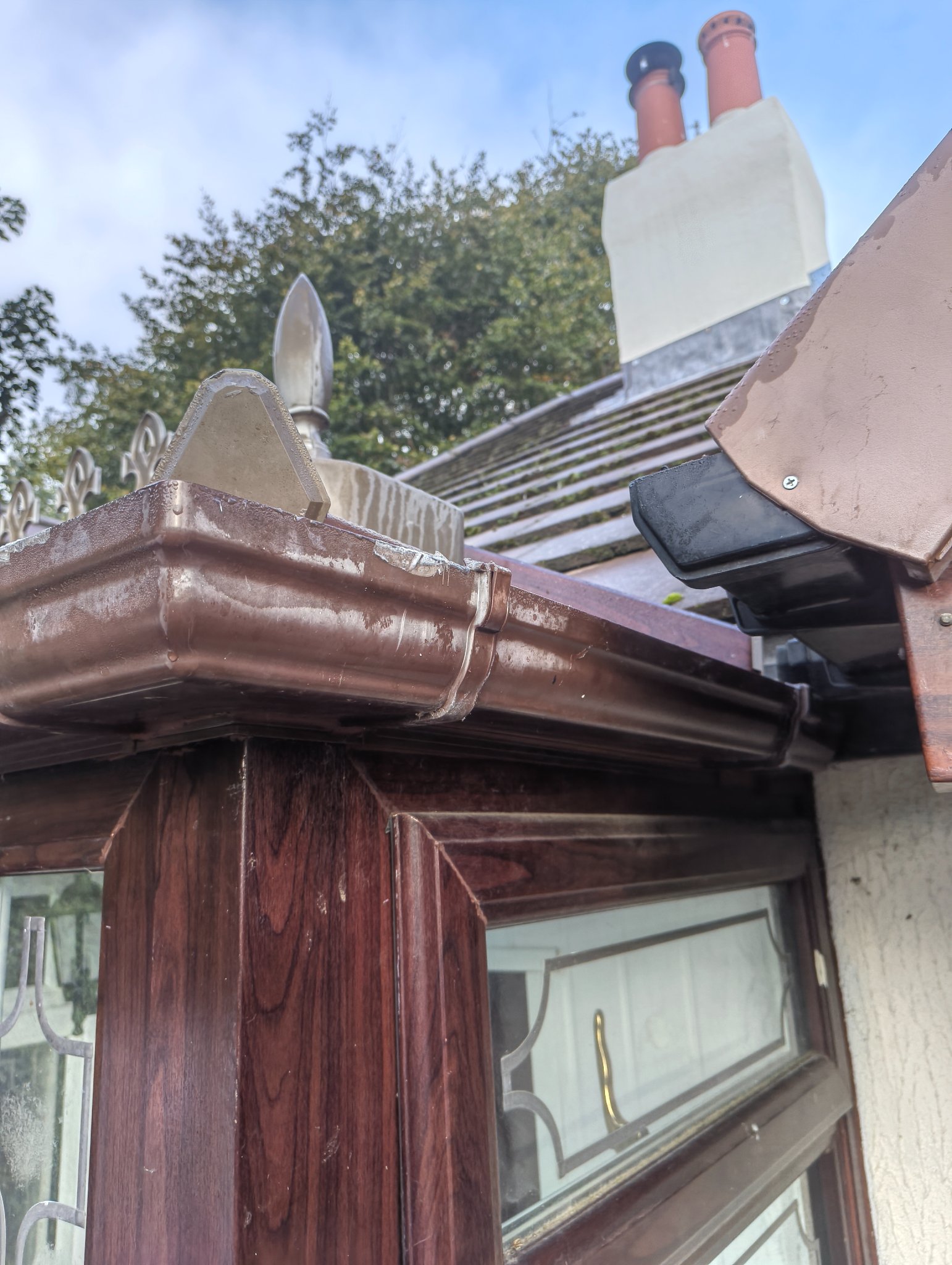

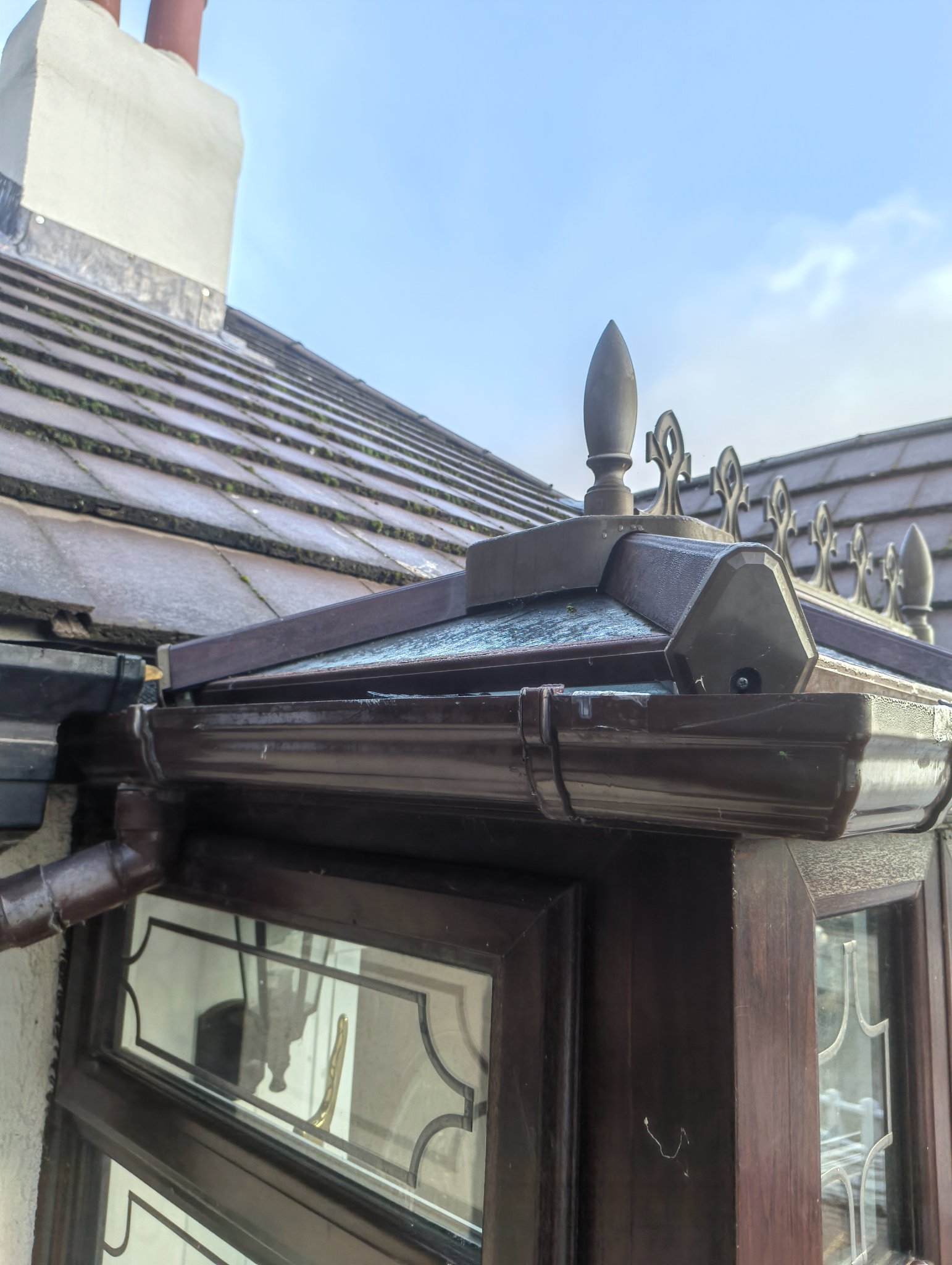

Here are photos of the guttering that apparently was installed with the porch.
If anymore photos are needed please let me know

Thanks for the pics - however I'm not sure of what I'm looking at.
One thing I do notice is that the gutter in pics #2 #3 #4 is not falling to discharge, & the corner fitting is not adequately fixed.
In general it might be best to strip the porch and relevant main house gutter outlets - then clean things up, change all rubber seals, & replace with adequate brackets & fixings: all to fall.
