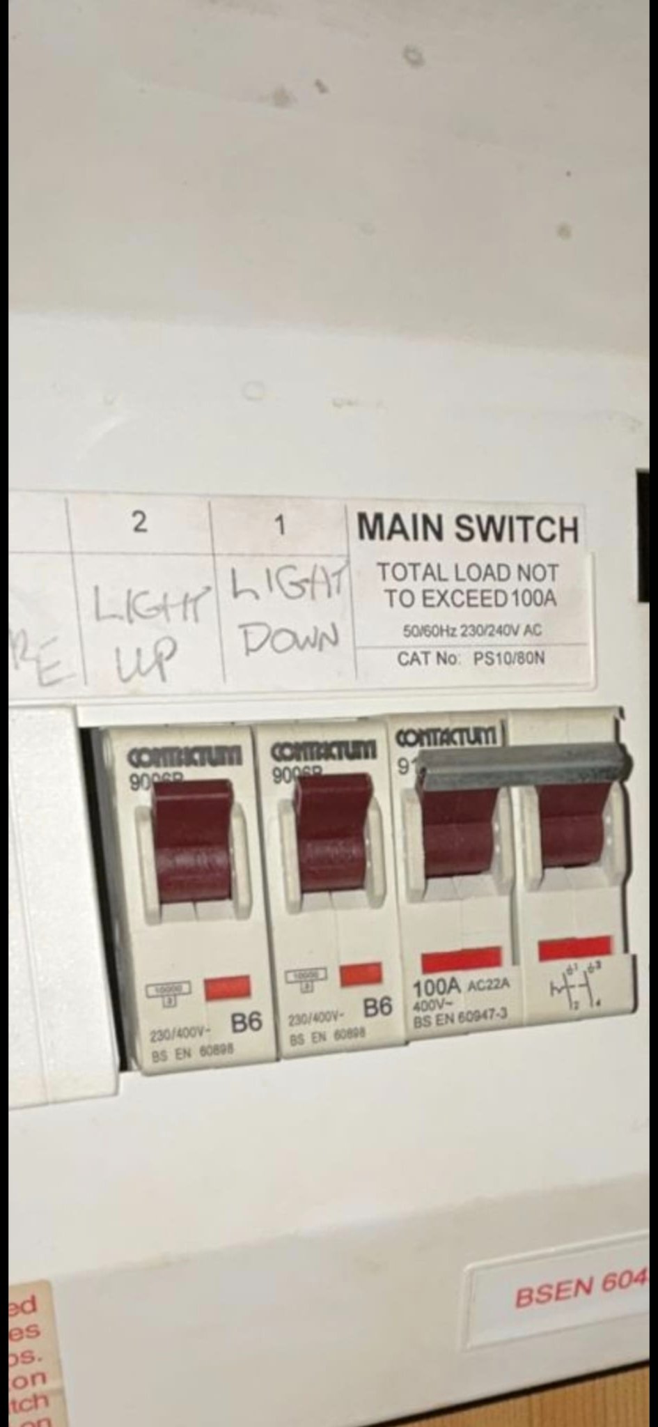

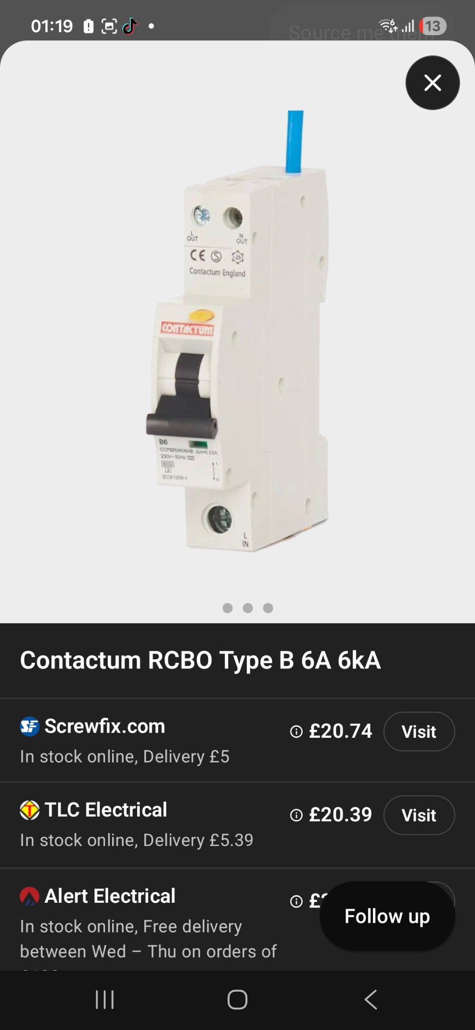

Hi.
Can anyone advise if the rcbo in tje image is compatible with the the board which currently has standard mcb ?

Not compatible. Busbar connection will not align.
The only similarity between that old 9000 series and the new one is the name on it.
There were 9000 series RCBOs which would fit, but they are all Type AC so of no use.
Thanks. Back to drawing board
