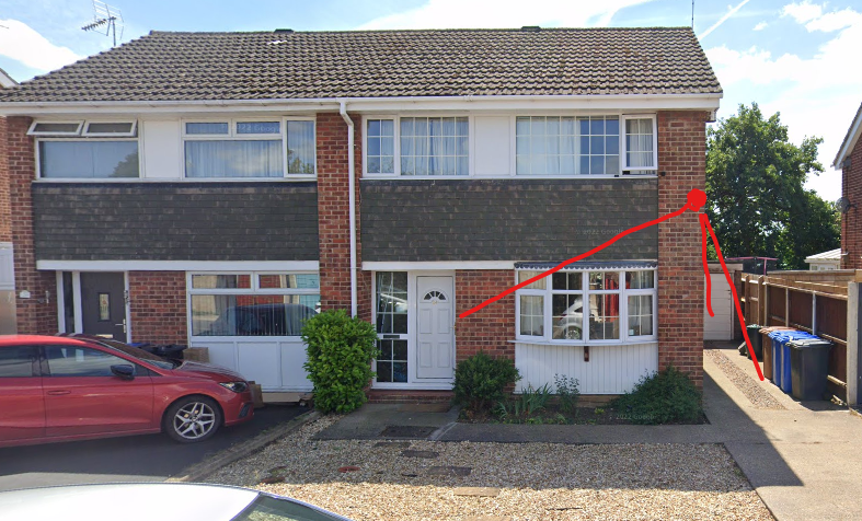

So, I have a few Tapo outdoor cameras that I would like to install properly, but I don't really know the best way of doing it in terms of wiring and power etc.
The one I want to put on the front is a 360 degree pan/tilt ball camera on a 90 degree bracket. The bracket isn't a problem, I can fix that to the wall, but what is the usual method of getting power to it? Should I try and get power from the loft (I know there is a light/switch in there, but not a lot else), or do people usually drill through an exterior wall and into one of the rooms in the house? I would imagine that the loft idea is the neatest & least hassle?

The front one would probably point diagonally down and across. If you were looking at the front of the house, the camera would be in the upper right, pointing down and to the left (the front door). The left is the attached side, and the drive runs down the right side. The houses are all in a line as far as the camera would make out, so the intention is that it catches people coming to my door, but doesn't really get much else, although it will obviously pan, so if it were on the right corner it 'could' also capture the car on the drive, and even the drive leading down to the rear garage.

The rear is pretty straightforward, but not sure on whether the 'done thing' is to have a power wire clipped all the way down from the roof.
The front is a little awkward, as you say, because the angle has to be right, so not sure whether it would need a cable clipped all the way down the corner, although the supplied cable wouldn't be long enough so then I'd have to think about how I connect it to another cable and hide that.

This very crude diagram should help.
20mm conduit down from soffit to angle box drill 4mm hole in bottom of this is case any water gets in then across to camera , you may be able to drop It down the cavity if it’s open at the top ( you will
Have to drill it back towards the window and up to avoid side cavity
I normally use cable rods to push up into the loft ( after looking in loft first as it may be a closed cavity )

Thank you mate, I had to Google the angle box bit but I see what you mean now :ROFLMAO:
I'm going to have a look in the loft later and see what's what over that corner. Hopefully I'll be able to get a cable down OK.
